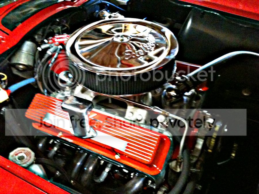

I don`t see how that is too much orange...but the tops of the vc milled would look sweet too.

I love Chevy orange, but it seems like with the red color of the body, there is just a little too much orange...If I take the time to mess with the car some more before I leave, that would only take an hour or two.

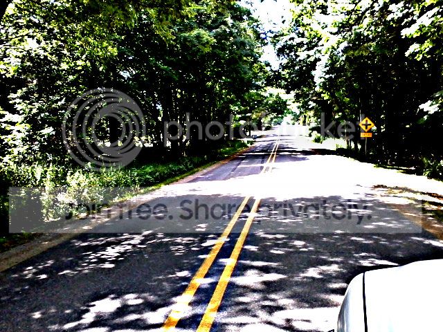

This burnout started back at the driveway on the left....about 125' later in 2nd gear on the rev limiter (5500 for now) I got out of it, because it was drifting into the other lane....
About 15 min. later a cop shows up at the house where I did the burnout wanting a description of the offending vehicle...hmmm, that was a very quick response for my neck of the woods.
I need to clean up the car, lash the valves down to .015 from the recommended .022, then I'll play with the valve covers alittle and try to take some orange off them...

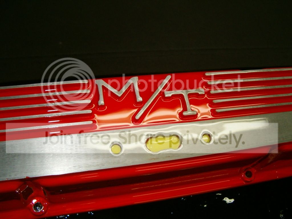

I haven't been able to get in here and post, but I have to think those VC's would look way better with the top of the fins milled off. Either way, that is one beautiful car!
Did that tonight at work....sort of; I was looking at the thickness of the flat "engraveable portion" and they don't seem thick enough to get them down flat to the M/T portion of the covers....I took them to an upright benchtop belt sander to flatten them out, and still didn't get to the letters close to the flat portion very well...I didn't want to make them any thinner as I have the breathers to bolt on too, so I hand filed/sanded portions of them to get the ribs exposed...pics to follow when I get home from work tonight!

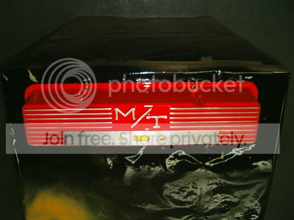

prepped the valve covers tonight at work, then brought them home, washed them with Dawn and a 3M pad, then blew them off w/ compressed air, then wiped them with wax and grease remover, then a shot of clear to seal em up.
Likin' em:

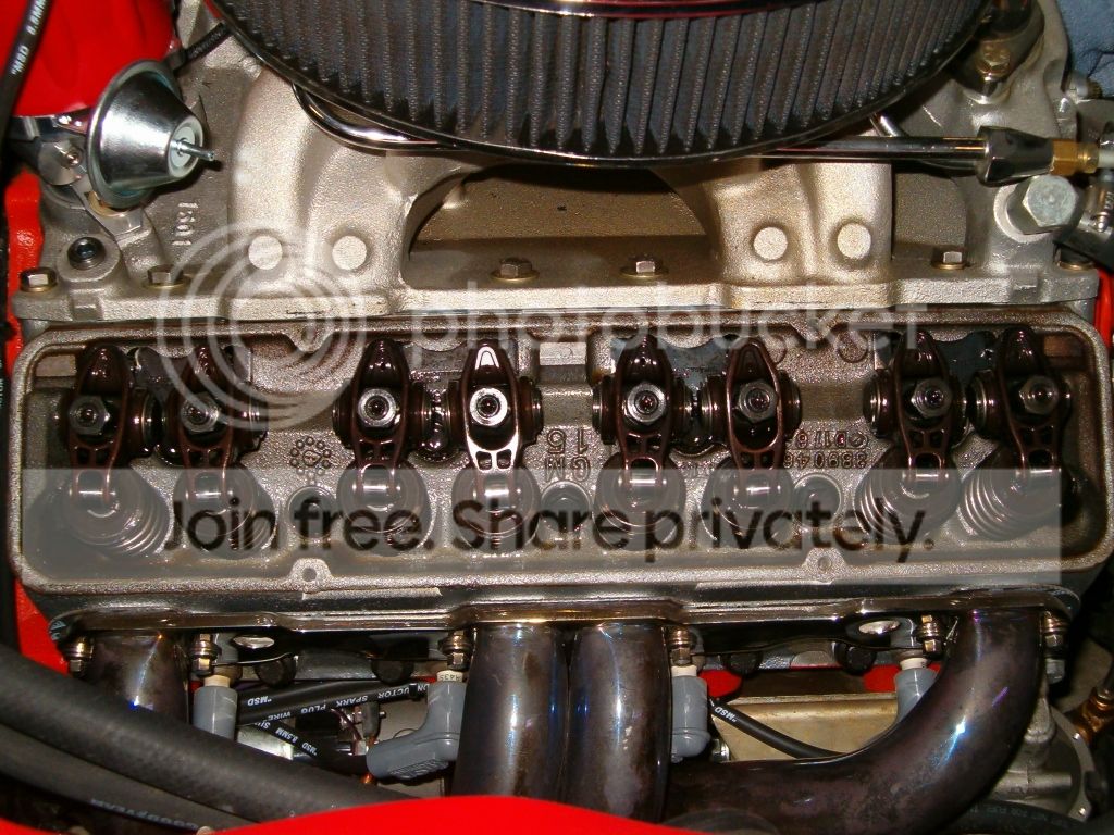

And just cuz I love my valve train:
The valve covers look great Zim! But you are missing a hose to your vacuum can. :haha::waytogo:
Thanks guys, you get the idea, but I'll get a better pic tonight to replace that cell pic....and I'm still amazed at how much paint an HVLP will put down....
