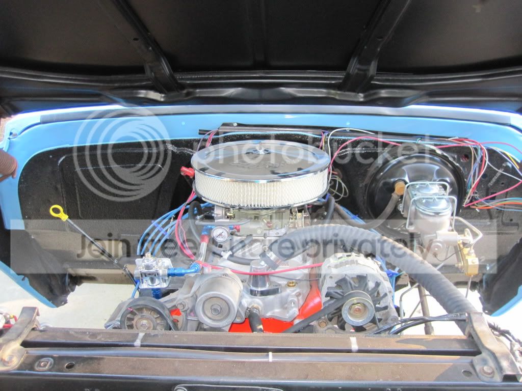

Mike, the AAW was a cakewalk to install and is all wrapped up. It could be done in a weekend if you hit it hard. Follow the directions, take your time, and use the correct crimpers. I was able to fire this thing up a couple week ago, still have a few things to complete before driving it for the first time

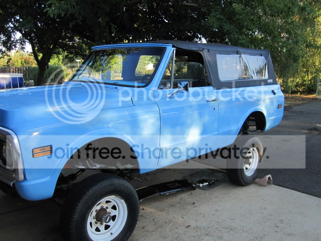

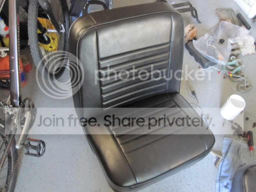

Okay, here ya go. Soft top installed, windshield installed, and seats upholstered.
