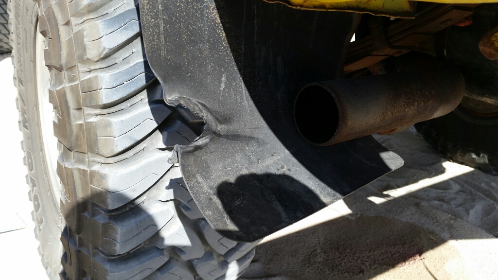

Lastly, I learned that exhaust temps coming out of a cat are a LOT hotter than my old exhaust system.
I burnt up my mudflap and also melted a hole in my poly fuel tank. :doah: I was able to use some goop to patch the tank and cover it with heat tape but it sure sucked. I'll have to drop the tank and come up with a more permanent solution this week.

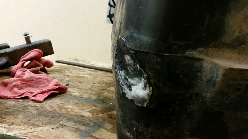

As to all the suggestions on the tank, if I have to get a new one I'll be trying to get a steel tank set up for an internal fuel pump for sure. If a tbi tank will fit (I was under the impression that they wouldn't fit in a 1st gen frame? :dunno: ) then I will go with that for sure. I just wish I hadn't already spent $120 on an external fuel pump. :rolleyes: For now I'll see how my current fix holds.
The offending hole full of goop.

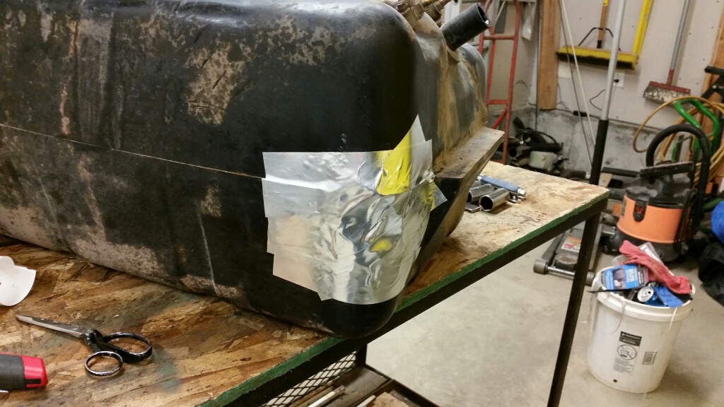

I forgot to take any pics during the fix but I used an epoxy and fiberglass cloth repair kit. It seemed to turn out pretty good. Then I covered the whole area with heat tape.

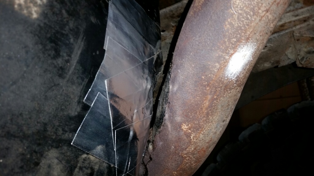

In place pic:
The clearance isn't quite as bad as the pic makes it look. There is a good 1/2" there. Hopefully the heat tape works as a good enough heat shield. When I get time I'll see about adding a proper heat shield.
