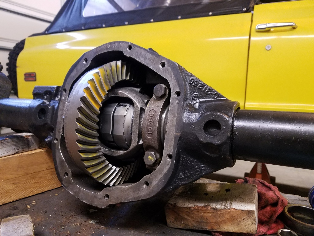

@blazinzuk came over and helped me get the gears and lockers swapped in. I forgot to take a pic of the detroit in the 14boltsf, but I did get a shot of the aussie locker in the D44 before I buttoned it up.
We ran into all sorts of problems getting the gears in. The Motive gears for the 14 bolt just would not give us a good pattern. We ended up doing 11 patterns by the time it was all said and done. :doah: The D44 went much better, but somehow I managed to lose a thrust bearing when taking it apart. Luckily @bigblock72 donated one to the cause and got us back on track.

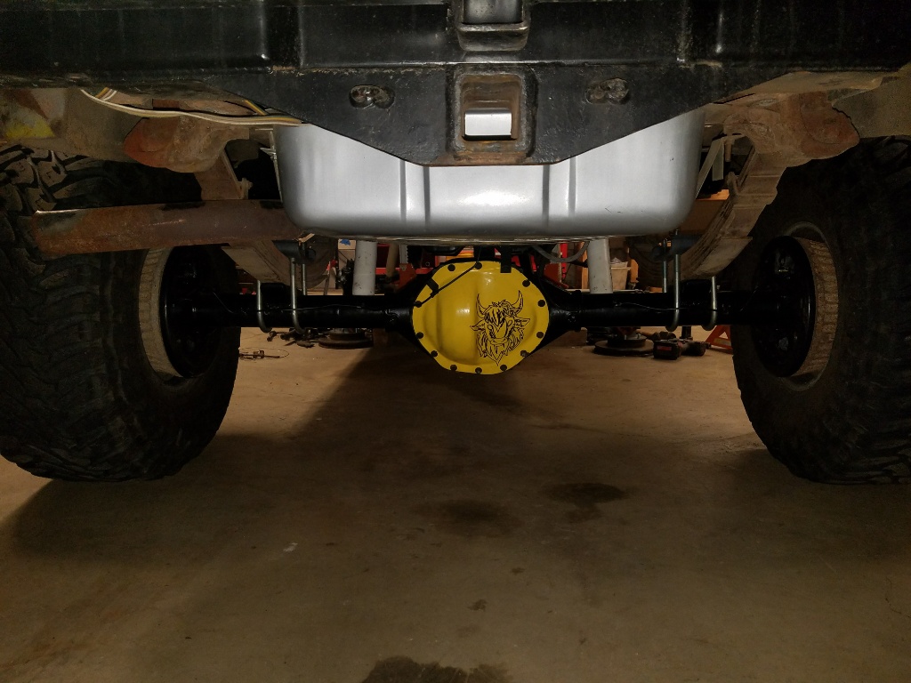

Last night I finally got time to put the rear axle back in.
It is significantly wider than the stock 12bolt.

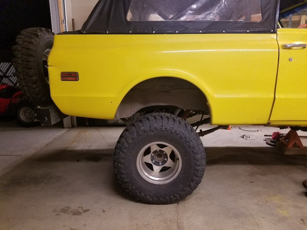

On the right side of the pic you can just barely see that my license plate shows that I'm registered as a classic vehicle, so a little too wide without fender flares won't be a problem... except it won't fit on my trailer anymore. :surepal:
While I was at it, I also moved the rear axle back 1.5".
I was surprised that the change was so noticeable. It still looks weird to me, but I suppose I'll get used to it.
Unintended side effect of moving the axle back though, My emergency brake cables are too short. It's not as big of a deal now that I have an automatic, but I would like to have it back. I'll have to see if I can find a way to get longer ones, or move the frame-side brackets back a bit. :thinking:
