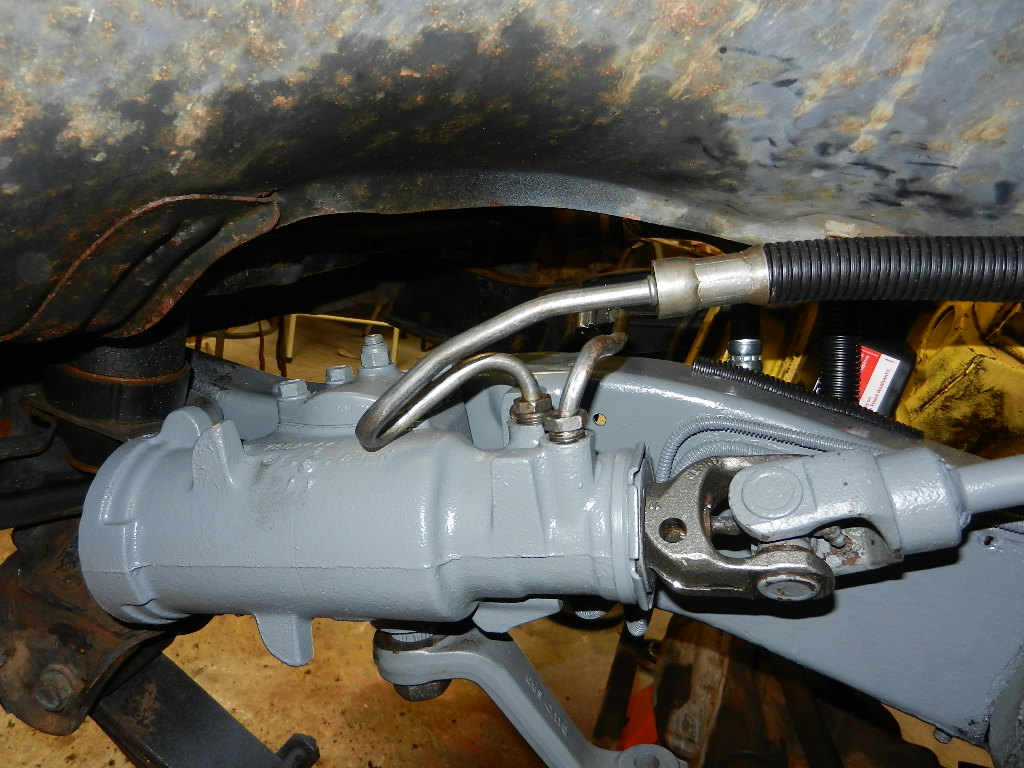

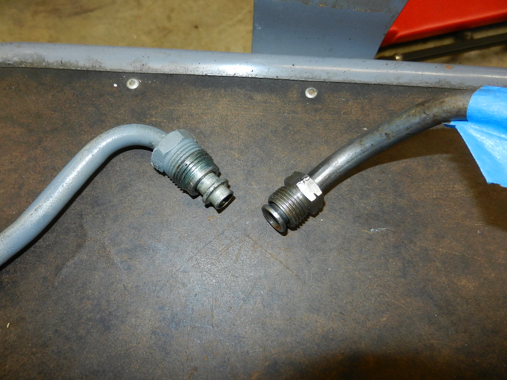

modifying the power steering lines was turning into a royal pita, so I decided, screw it, I'll replace the steering box instead. I was already replacing the pump, so if I replaced the gear box, all of the line ends would match up. simple right? /sigh

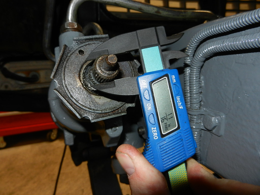

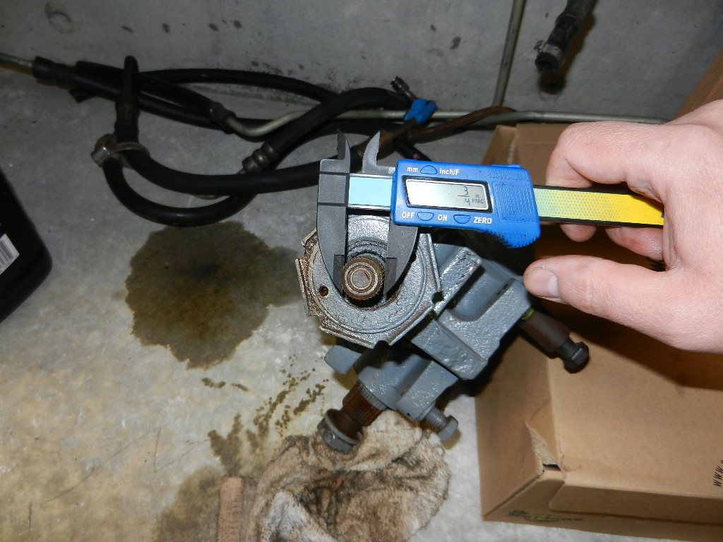

I was able to get a 2wd steering box for $30 (I already have cross steer). I spent a few hours cleaning it up and painting it before putting it in. bolts right up, but turns out the part that connects to the steering shaft is a smaller size. normally this wouldn't be much of an issue since I had the rag joint from the new box... but, I have a 3" body lift, so I've replaced the rag joint with a u-joint that now no longer fits. now I have to replace this damn u-joint.
every time I think I solve a problem, I just cause myself another. grrrrr.

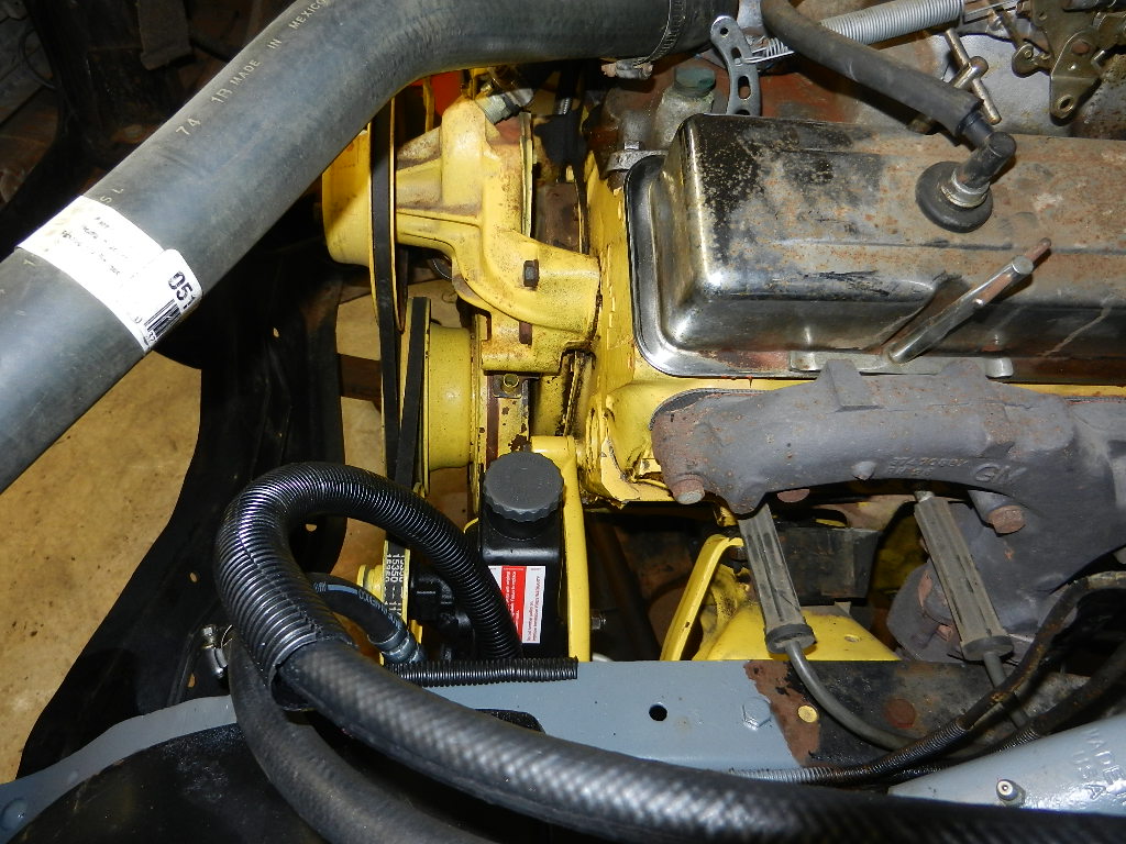

That was why I ran the pump/hydroboost from the same truck and kept my old gear box. I bought lines for the 85 and just re-flared the hydroboost to gear line and called it good. I think if you want to keep your old gearbox napa will make you a line with the correct ends on it. May save you some frustration... Hell, if you're not in a hurry I can buy a line, reflare it and ship it to you, but it'll prolly be cheaper to just pay someone around you to do it...
(ps hoses use "thick wall" steel tubing, so cheap flaring tools won't do the job) I decided the easier way would be to just switch to a pump and box that had metric connections. I had planned on replacing my ps pump anyway, so that wasn't any added cost (other than the $6 I spent on a new pulley), and I was able to pick up a junkyard box for $30. not only did this make my line issues go away now, but I figured if I ever blow a line later, being able to just slap in a stock line would be preferable than having to go through all of this again.
luckily that wasn't a difficult problem to solve, just more money out of my pocket.

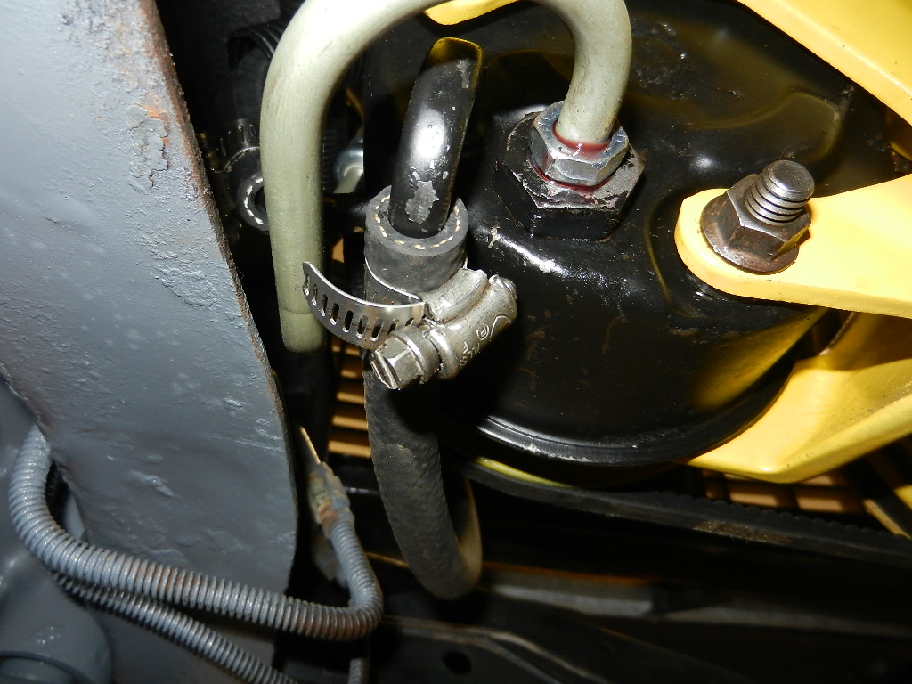

I tightened it up a bit more, but I'm worried about that one.
I'm pretty sure I put the o-ring on there, but I'm going to pull it off tomorrow and double check. it's also possible that there was just some fluid on the nut itself that got squeezed out once I tightened it down. seems like a long shot, but its possible.
I pulled it apart and the o-ring was there and looked decent.My luck it would be your idea, but when I pulled it I would tear said o-ring and really be in a bad mood![]()
hopefully it just wasn't as tight as it needed to be. got it cranked on there good now, so we'll see.I pulled it apart and the o-ring was there and looked decent.hopefully it just wasn't as tight as it needed to be. got it cranked on there good now, so we'll see.

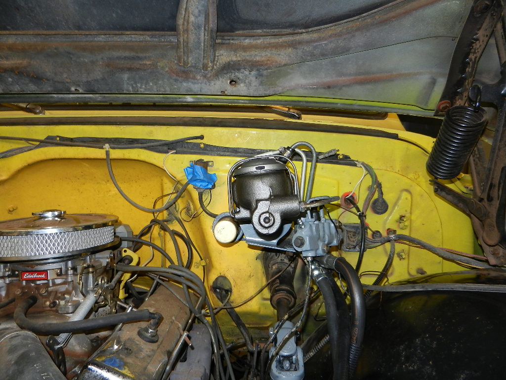

I'm aiming to to have everything buttoned up by this weekend so hopefully I can fill it full of fluids and try it out.![]()
I did read something about that somewhere. I'm pretty sure I have the link saved. when I get a few minutes I'll read through my stuff. if I don't find it I'll ask for help. thanks for the reminder!Awesome! Have you read the thread about bleeding the hydroboost? I'll wait to hear from you before I type it all out. Not hard, just takes a bit...
never heard of that before, but since I've changed out my prop valve I'm worried I may run into that too...I did read something about that somewhere. I'm pretty sure I have the link saved. when I get a few minutes I'll read through my stuff. if I don't find it I'll ask for help. thanks for the reminder!
speaking of bleeding, I read something in the garage forum that made me a bit nervous. someone a few days ago had his prop valve lock up on him because the rear brake lines lost too much pressure or something.never heard of that before, but since I've changed out my prop valve I'm worried I may run into that too...
