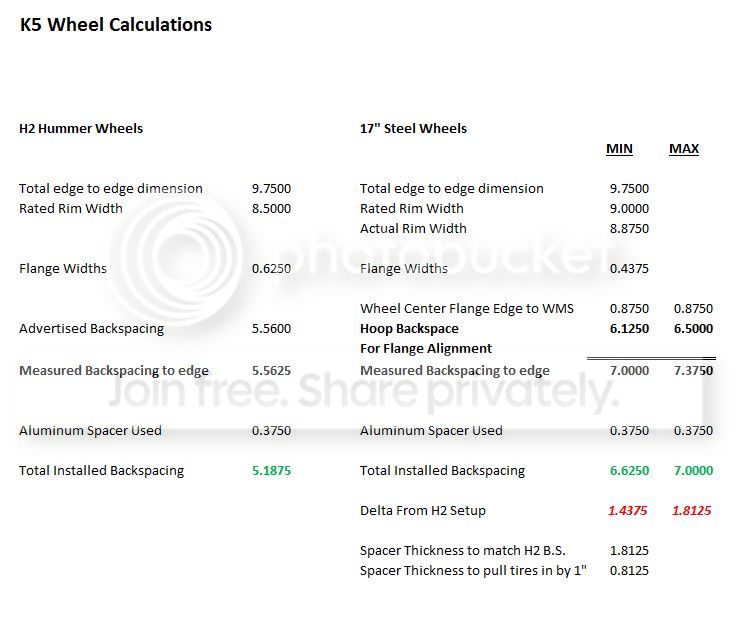

Quick Update on the Wheel Project:
For those of you who are excited about the prospects of building your own 17" 8-Lug steelies... you might want to slow down a bit and take a look at the data I've compiled here:
Based on this first round of numbers, the least amount of backspacing that can be achieved with this particular wheel center/ hoop combo is 7.00"!!! :yikes:
That doesn't bother me with a portal setup, but for guys who are used to running pretty minimal backspacings (like 3.75" or whatever).... it's not going to be a simple bolt-on affair. Probably either a huge aluminum spacer behind the wheels or some kind of DRW hub swap to make it fit.
-G
I guess if you wanted the "poke" look.... :haha:
-G
Sure, if you stuck with the minimum amount of backspacing but if you flipped them you'd be looking for the maximum amount of the same measurement. I don't know what the total width of the rim is, but if it's less than 14" then 7" of backspacing 1 way would work out to less than 7" the the other direction.
right? :dunno:
