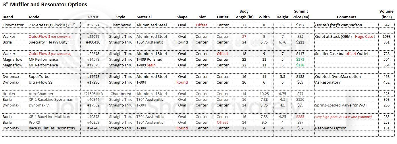

Here's my research thus far for mufflers and resonators:
The top line is the current placeholder in my framerails (Flowmaster 70-series). It a huge mother, and since it fits...pretty much anything else I choose should fit also.
I'm trying to stay focused on 3" (center in / center out) mufflers since those will be the simplest to connect to other exhaust tubing and if I end up building flanged connectors for everything it will make "swaps" between different muffler types a cinch!!! :waytogo:
I think I've captured the majority of stuff that is supposed to be "QUIET" and relatively free-flowing, but if I'm missing something let me know.
Since I've got all the tubing to build the entire exhaust system (front to back) I want to select a resonator first....then graft that in as far away from the header collector as I can fit it (while still staying inside the torsion box area)... then I need to make a crazy 90-degree turn to get to the inside of the framerails, and another 90-degree turn to hit the inlet side of the mufflers... I'm using 3" tubing throughout with a 6" CLR bend, so I'm hoping the restriction will be minimized. Throwing a few turns into the mix will probably help to quiet things down a bit so that's a nice side-effect. :)

OK....
Here's a quick revision of the previous list. I added some extra details and highlighted some particularly noteworthy items in either red (bad) or green (good)...
The objective on this one was to start trying to compare the mufflers based on how much case volume (displacement not noise) each one has, since it appears that maximizing this attribute is where you're going to get quietness more than almost anything else. The list is sorted from the largest value to the smallest (volume in in^3)
A couple of noteworthy items popped out of this analysis.
  • If the MagnaFlow is considered to be a "Good" flowing muffler, than it appears to offer good value for money.
  • The Walker QuietFlow3 would have been a stellar choice for getting a large case volume, but they appear to be too restrictive and will kill power.
  • The Borla Multicore option is a crap-ton of money but in a relatively small space. However, if there is some "magic" that allows the 4-core internal design to create quietness in the small package, this could be forgiven
  • Using "Race Bullets" as resonators seems to be a waste of time.... they are inexpensive, but also offer almost no case volume... so they are unlikely to quiet down the exhaust in any meaningful way.
