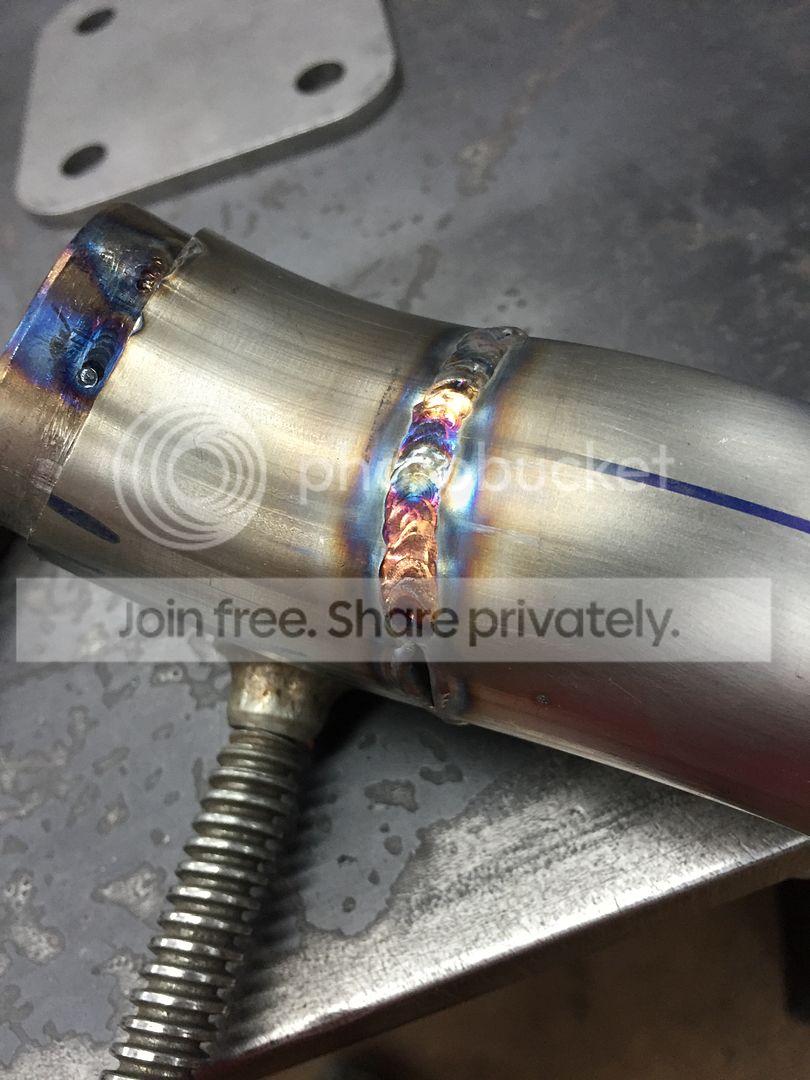

I was struggling with all the 1PPS stuff.... then I did some reading on WeldingTipsandTricks.com about TIG welding thin stainless... Jody suggests using a higher pulse setting (30 or higher) as well as 30% PEAK / 30% BACKGROUND with around 50 Amps (IIRC). So I tried that new setup for a while and fumbled around and wasn't making very good progress.
Finally, the angry FB crowd got impatient and said "Shut off the damn pulser and just weld!!!" :haha: That was good advice.
I had been trying to break-down the process into small skills that I could learn before trying to combine two-hands and a foot pedal all at once. All I was trying to do was find a setup that would let me create a quick puddle, and then start trying to move it around and see if I could fill a gap (without filler rod) on tight fitments.

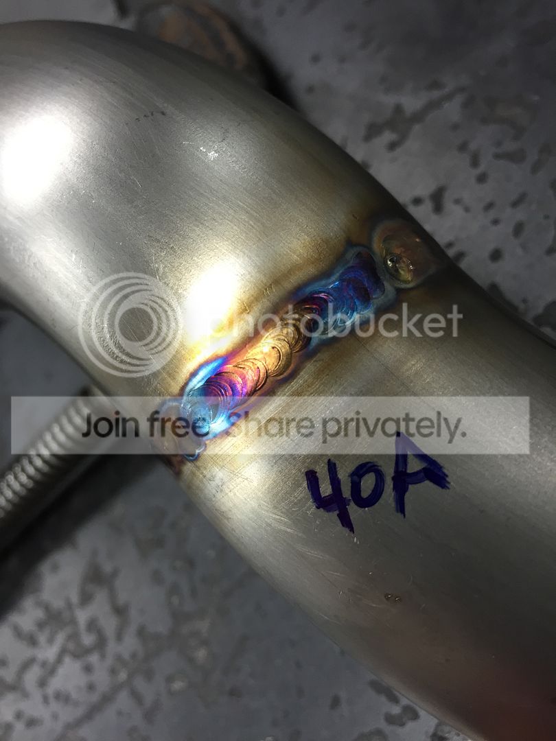

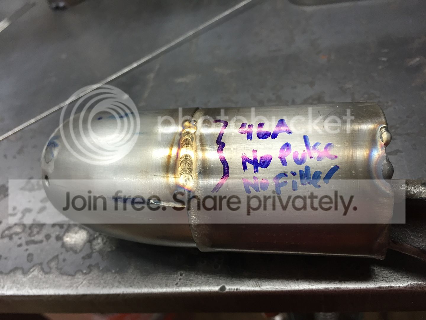

46A seemed to work pretty well (1/16" Tungsten 2% Lanthinated, 30CFH Argon flow, Pyrex cup):
The coloring was a nice light-gold color and it seemed to flow pretty well also. I decided to turn down the amperage a little more to see what would happen and if I'd have more time to work the puddle before blowing-through... I went down to 43A.... and then eventually to 40A:
The weld color definitely was different.... more of a dark blue / purple hue than before. I don't know if that was a result of pulling away the post-flow shielding gas too early... or just that the weld was "cooler" at only 40A?? :dunno:
In any case, it was a relief to finally be fusing parts together instead of blowing through them. Another "lightbulb moment" was when I struck the arc about 1/32" away from the tubing gap (instead of directly on TOP of it!).... I don't know why I thought it was a great idea to always start in the middle of the gap, but obviously the molten puddle melts-away from the heat source so I'd always get a crater. By starting a puddle where there was good metal I could more easily "sweep" the puddle across and onto the gap where it would start to fill in, and if I swept slightly past the gap to the other side, I could maintain the puddle and then work it back the opposite way to slowly move down the seam and close it up (even without any filler rod).
This was a huge breakthough.
I sat there for about 3 hours last night just practicing, making mistakes, sticking the tungsten (A LOT!) and spending a lot of time walking over to the grinding wheel to resharpen the tungsten.... at the very end of the night I tried dipping some filler rod (.030" 308) into the puddle, but that process still feels REALLY awkward and clumsy. I guess I will try that tonight to see if I can get more comfortable with it.

I don't ever pulse, never learned it, never cared. I run my Miller 351 at 35a typically on stainless exhaust tubing
What about the pedal?
I was basically just mashing it to the floor.....then welding for a few seconds, then I taper it off.... letting the post-flow gas cool the weld. Do you spend a lot of time pumping the pedal in-and-out to create each new puddle for the weld, or are you keeping steady amperage and using the torch to manipulate the puddle?
:dunno:
-G
I typically start cold, dab a little filler rod and bring my heat up to flow it out and start the weld from there. Avoids overheating the first part of the weld, I just work the pedal from there to maintain puddle width and flow. I try and avoid pulsing the pedal, I don't typically like how those welds look.
Adding filler rod is your puddle definition, right now if I understand correctly your not using any? That's why you need to pulse other wise it would just be a pointy smooth thing. Start working on adding filler, if your gaps are nice and you maintain good pedal and torch control adding filler will have a rhythm to it and you'll end with a lovely little weld. Keep the filler about 1" away from puddle, and make a quick dab into the puddle. I find most new to tig welding are apprehensive with filler rod and it tends to ball up and make a mess. Quick dabs in and out, forearm planted and dab in with your wrist
Edit - try cutting your filler rod into smaller pieces, say 8" long or so, sometimes a brand new stick can get kind of hard to control especially if your just getting the feel for things, don't be afraid to make somthing to help stabilize either arms, in some cases when welding in position I will use a clamp or somthing to give me a something to plant my forearm on to stabilize my hands.

I ended up subscribing to Finnegan's YouTube page, and watched everything he has there... unfortunately, he doesn't have the headers finished yet so I'm still waiting to see how he does some of the fussy welding (like the collector to the primaries, etc).

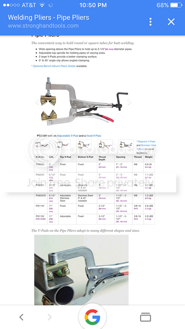

There were some good tips in there about fitment, weld settings, and purging. I ended up buying one of those Stronghand Tools tube clamps that he showed in his video (Amazon Prime, delivered tonight!) so that I can more easily fixture and hold my primary tubes in the positions I want them without a lot of struggling.

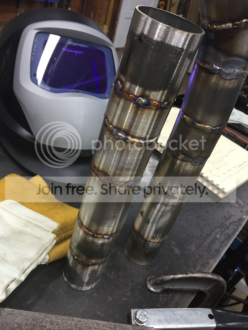

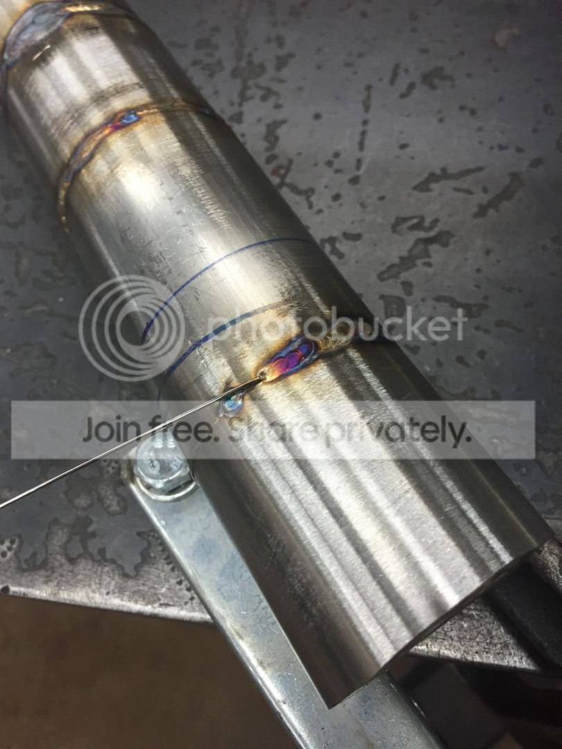

I'm up to 9 hours of TIG practice so far.... and I'm getting better at adding filler rod into the puddle and I'm sticking the tungsten a LOT less than before.
That's not to say I "never" do.....here's a 2-fer. I stuck the tungsten AND the filler rod into a big group hug. :haha:
Fusion Welding practice (right), Filler rod practice (left)

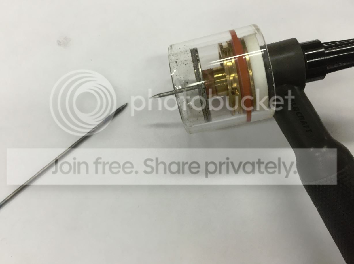

My TIG torch setup. There was a small fiber on my old tungsten that was contaminating things for a while, and I had a fan set up to keep me cool one of the nights I was out there. It blew away all of my shielding gas and was driving me CRAZY with crappy welds and colors for a solid hour until I figured it out.

I like those pyrex cups for stainless. You can slide the glass down further, as long as you slide the end past the orange o-ring. It might give you a straighter gas flow path, right now you have a very short distance after the diffuser.
