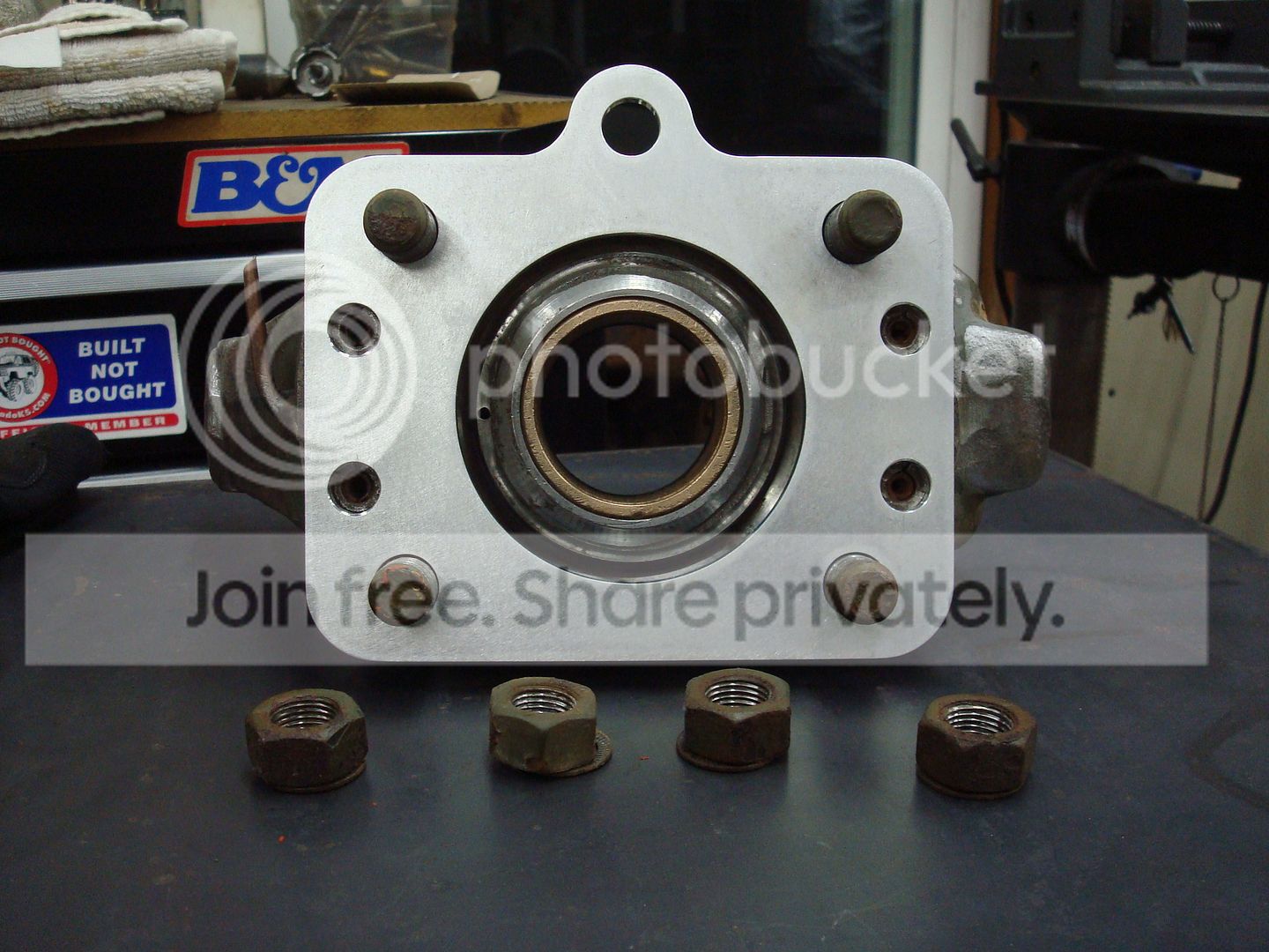

Yeah the machining looks good Scott, nice job. Are they going to have flanges of some sort, or the back will match the front? I don't remember what the castings looked like.
The photos show what would be the pumpkin-facing side of the adapter.
The opposite side will be mating to this:
That is the inner "C" for the front axle. Basically a smaller through-hole than what is needed for the 3.5" axletube, so I don't think there's much special that needs to be done other than to leave me a small chamfered edge to do a nice deep weld between these adapters and the axletube itself.
The rears will be quite a bit different, since there is a large plate-type seal and a series of bolts that need clearance cut into the adapter.
I can't take any credit for the machining as I did not do it, a good buddy of mine is making these parts and i'm just simply the "middle man" since Greg is on the east coast and I know what needs to get done and my buddy works at a CNC shop and can do the work.
