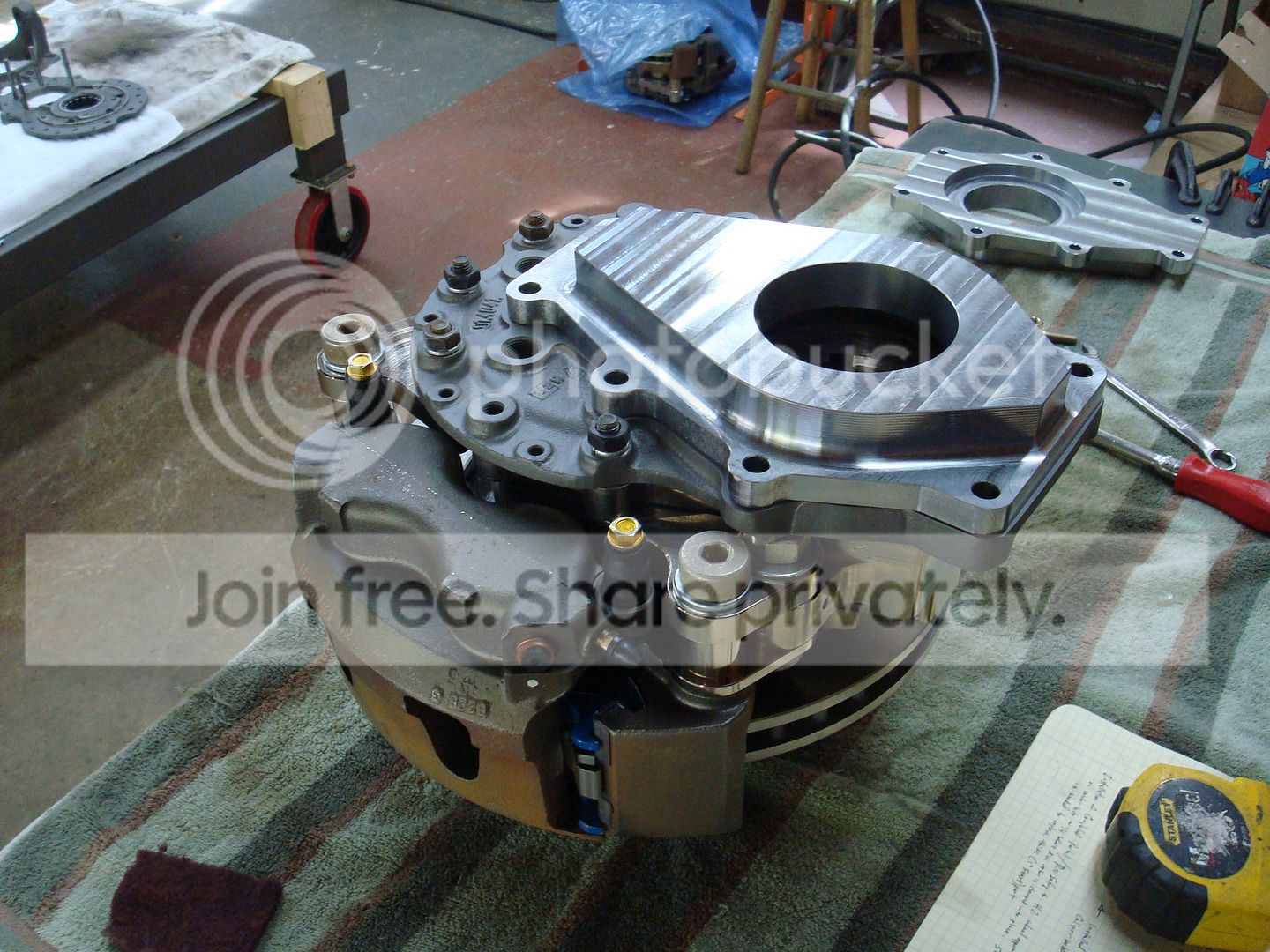

Here's where those new plates fit into the overall portal assembly...

This picture looks pretty interesting, not something you see very often, OK, maybe less than that, since there is only one set?

Out of sheer curiousity, what's that rotor-caliper-portal-adapter-hub thing weigh??
AJ,
It weighs a sh1t-ton....! Seriously, those assemblies are getting so heavy as I add parts that you really can't just "lift" them onto the workbench anymore. Now it's more of a crouch/bend knees/grunt/struggle/shove into place. My guess is somewhere around 125lbs+ these days. :yikes:

Second: So, how are you going to weld the adapter to the axle. Outside, like an outer "C', inside the adapter to the axle, drill holes in the sides of the adapter and plug weld it also, like the factory? I was just thinking with all of the drive train components and those portals, that is a lot of torque back there. :thinking: :dunno:

#2: The final welding of those plates can be accomplished from both the inside and outside of the plate with a full perimeter weld. Additionally there will be full-width trusses running across the axle which will also end up welded to those plates as well, and I suspect an additional gusset on the underside to give some additional support to that rather large unsupported length to prevent any possible bending.
