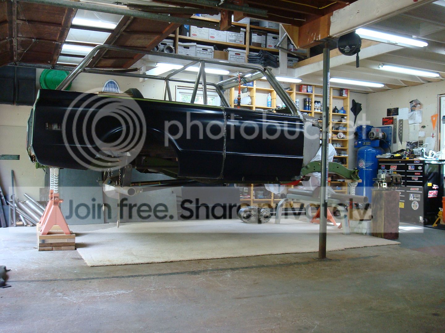

As a refresher, here's where the truck sits now:

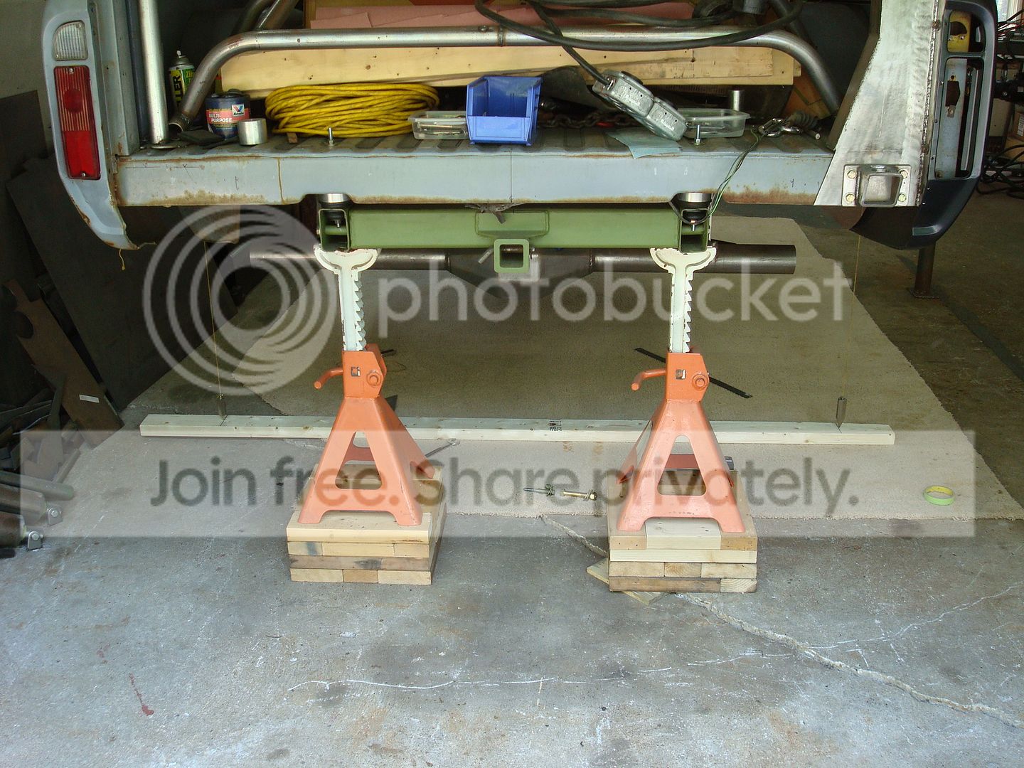

Since I knew that I wanted no more than 2" of tread "stickout" beyond the rear fenders, the first step was to accurately determine what that dimension was. I dropped a couple of plumblines off the outer fenderlips to get an actual measurement to start from...
That turned out to be 78.625".... adding in the tire stickout, my overall track width target was set at 82.625"

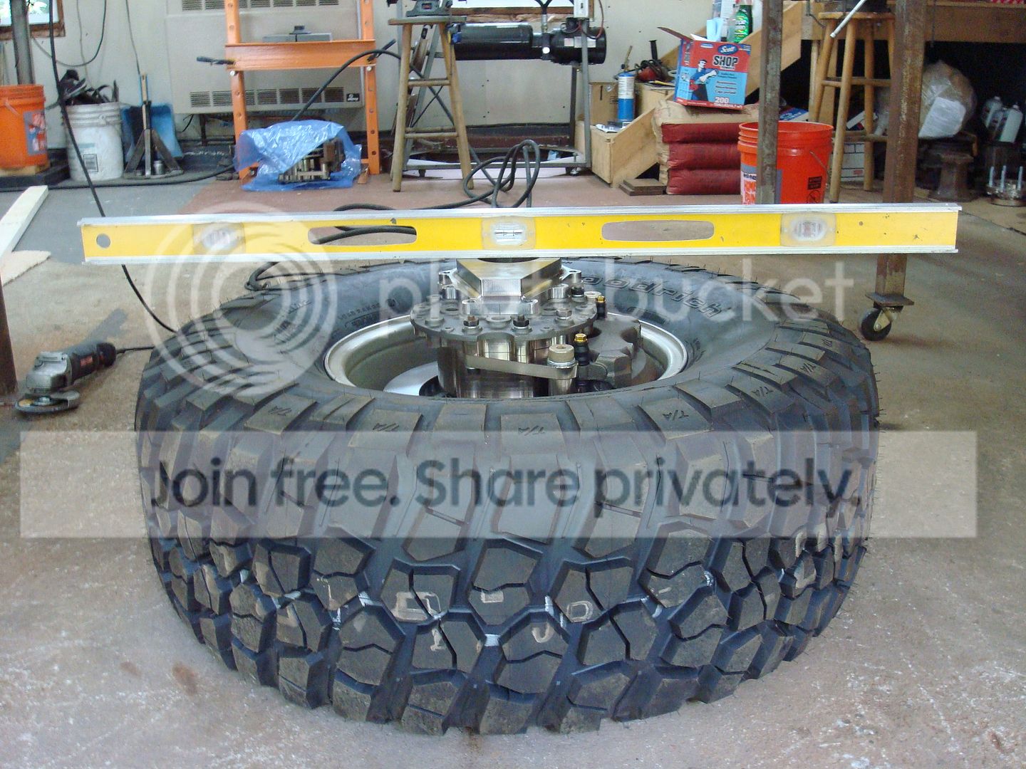

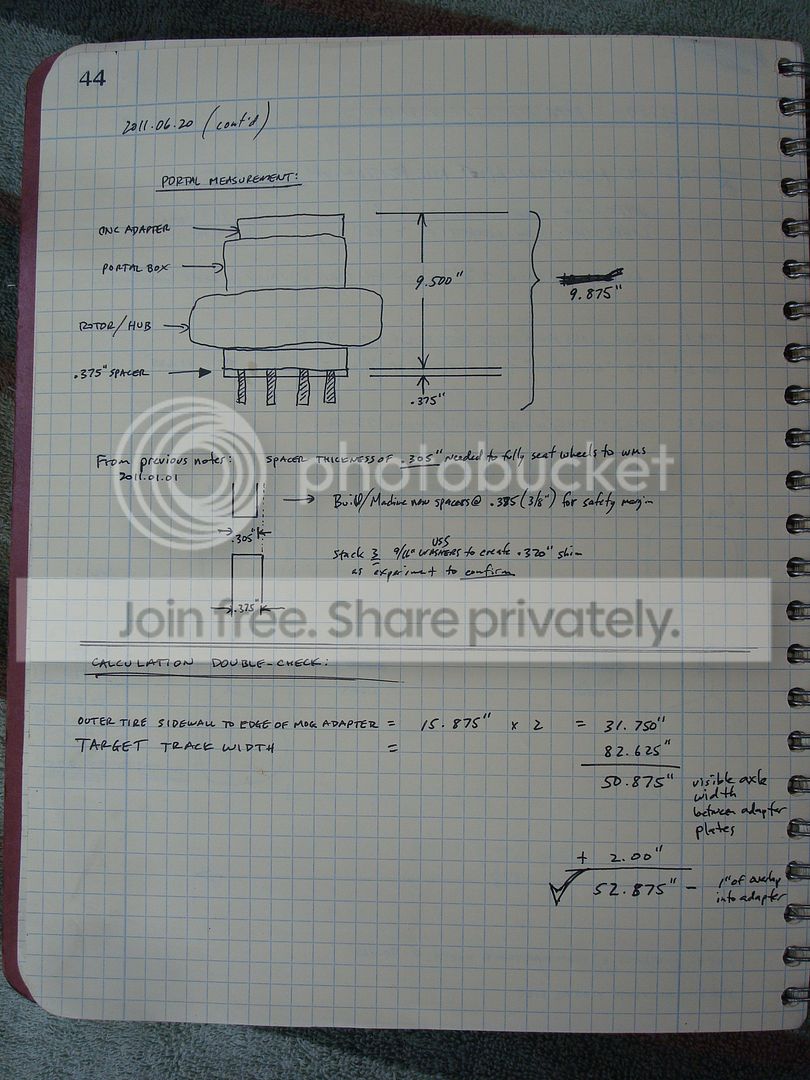

The next step was to get some accurate measurements of the complete wheel/portal/tire combinations. Here's where those new plates fit into the overall portal assembly...
From the front face of the tire (outward facing side) to the end of the new adapter plates was 15.875". This measurement was confirmed by measuring in this photo from the shop floor to the underside of that 4' level...

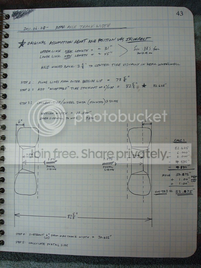

To make sure that I didn't screw up (and I came close a couple of times!) I took detailed notes....
More.....

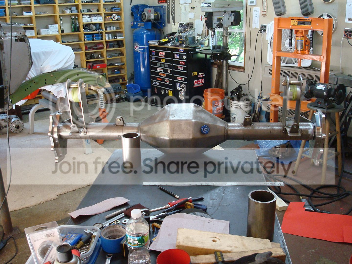

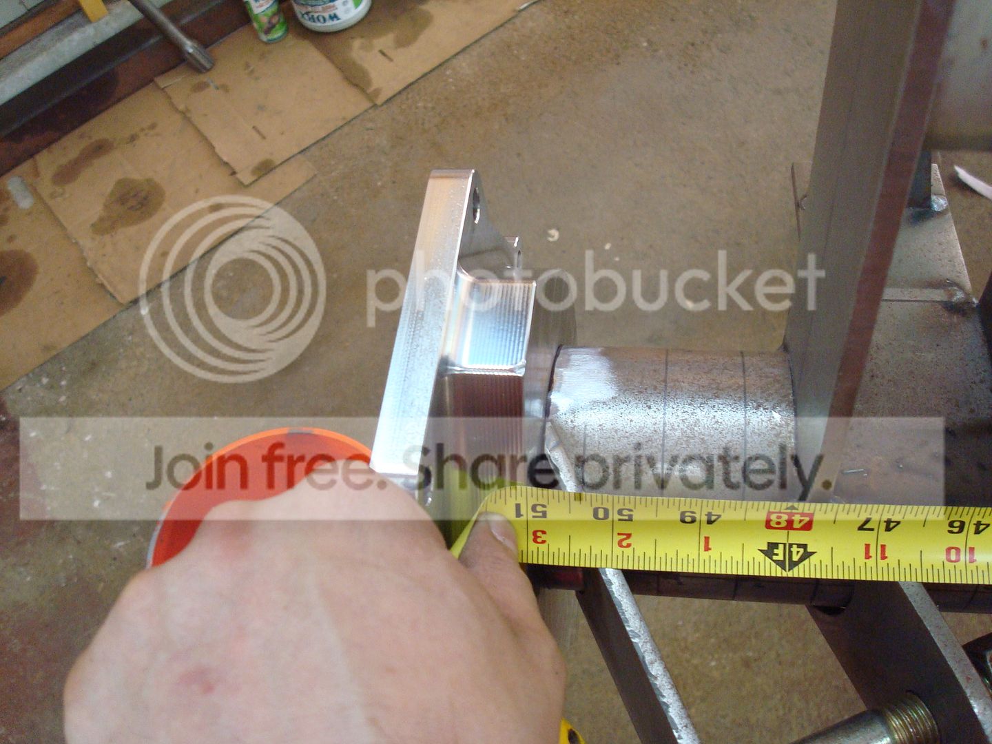

I checked, and double-checked everything until I was SURE that the measurements were correct. There was nothing left to do but cut the axletubes down to size.

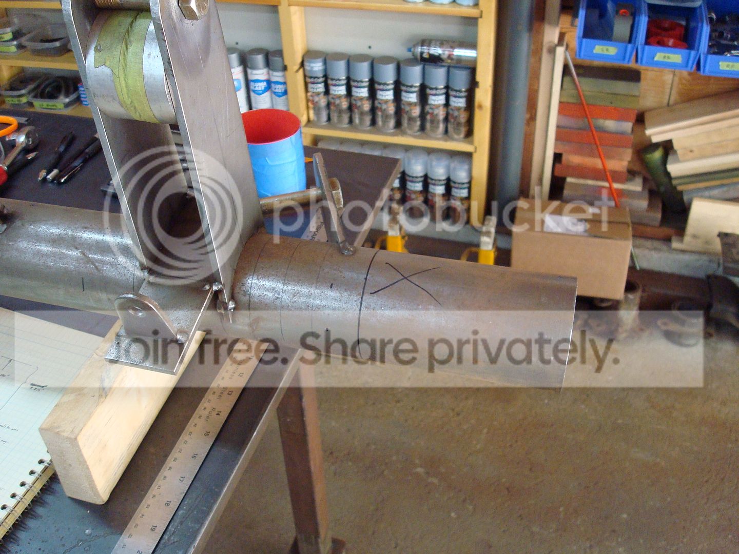

After getting both sides cut down, I spend some time CAREFULLY dressing-down the axletube diameters to get them to fit nice and snugly into the new adapters.
My final target based on my calculations was in inside-to-inside plate dimension of 50.875"....as you can see, I missed the mark by quite a bit! :D (I will shorten each side by 1/16" later on to make it perfect)
It felt good to get back out into the shop and especially to make such a large step forward on the axle build. I'm a little concerned about how tight the packaging of the shock/strut is going to be now that I can really see how much space exists on the axle housing, but I'll make it work somehow.
