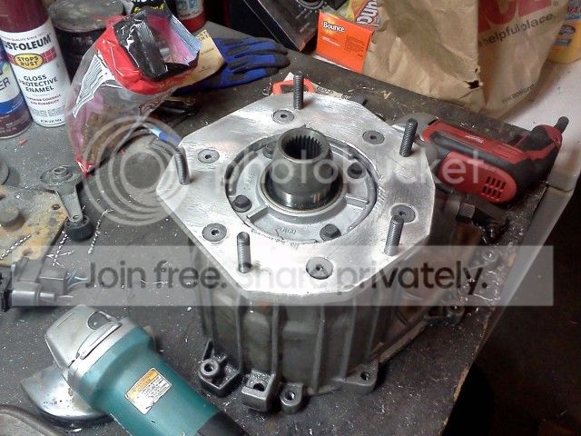

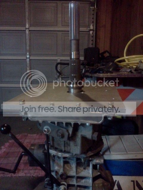

Little bit more progress, adapter is done and so is one shifter. Sorry about the ****ty cellphone picturesmy camera will show up one of these days...
That sucker is going to crawl like nobody's business. 6.5X1.96x2.73 = 33.7 x your gear ratio = :bow:
The 3500 I have only has a 3.9 to 1 first gear, so with my 4.10s it will be 85 to 1. Not to shabby considering my old combo was 52 to 1
Oh, I was reading off your sig's 465. :D 85:1 should do pretty great though! That's around exactly what I've got with my automatic, and I like it w/ my 38" tires. I also, at one time, had the 465/205/4.10s and 38s, and that 52:1 ratio worked ok, but this 85:1 rocks it. :)

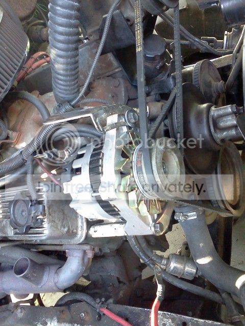

Got a little more done this weekend. Did the pontiac alternator swap. For those that dont know its a 140amp unit out of a 1994 pontiac transport with rear ac. It goes in pretty easy, swapped my v belt pulley on, spliced a junkyard connector and mesaged some brackets. Its getting 13.7 volts at idle now and should be able to run my windstars and headlights at the same time. I also closed off the open end of the 241 and drilled/tapped the holes to hold the adapter to the 241. Thats about all I can do on the doubler until I get a 31 spline 205 input and intermediate shaft

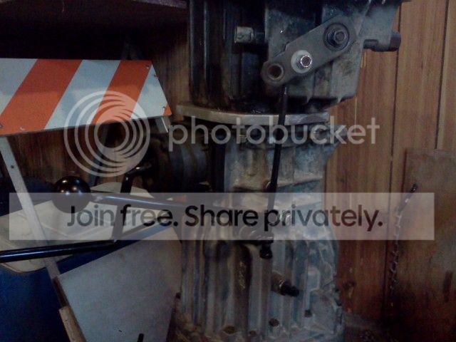

Cool build, keeping an eye on your 241/205 setup. I have mine in the garage ready to go in but haven't figured out what I want to do for shifters yet.
Thanks. I am still trying to figure out how I am going to run mine too. Is your 241 case notched for your 205 shifter? You have a Ford 205 though right? So it might be a little different
Yeah I have a Ford 205 and my adapter and intermediate shaft are pretty long so there's decent room to get to the rail thats normally tight on the 205.
