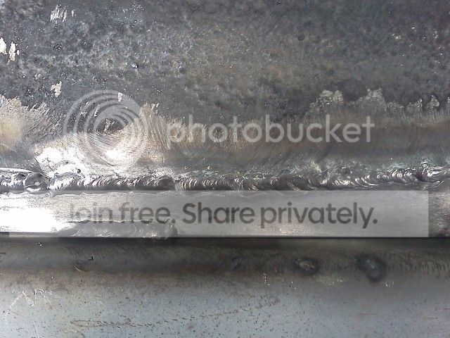

I had some time to weld yesterday, its not pretty in most spots but its not going anywhere. I was in a hurry to get back to work so I didn't get a picture. That might be a good thing though. I had to fill a few big gaps which got ugly.

Little progress today, passenger side is almost done and the drivers box is out. The second went a lot quicker, I used more bfh. My sheet metal welding is getting better, still ugly though.

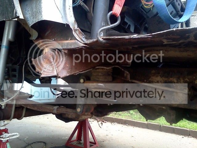

What do I do with the body mount? Leaning towards chopping it and capping it. This mount
When I did mine I cut a little out of the body mount and left it. You removed quite a bit...
I'd probably box it back together a little. Are you going to weld the sliders to the frame as well as the body?
I plan on tieing the cage to the slider then through poly bushings to the frame
