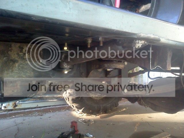

I did get a chance to weld on all of the cage to frame bushing brackets last week and the fabricators sets showed up from Kert today. I also got some poly body mounts to replace the mismatched stuff currently on there

Rear cage to frame mounts done

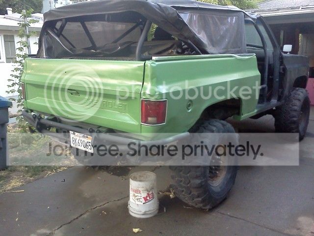

My house mate told me it would look like a giant pea if i painted it all green so I guess Jolly Green Giant is fitting. I think it looks pretty cool with the flat black, hopefully not too puke like as I keep painting
Managed to get a quick sand and a second coat on the piece I started. Its turning into Colbys '73, I already had the cage, bumper and top now its kinda the same color too.
I have to have it drivable by the end of the month when we move across town so thats probably all that will get painted for a bit. On to the important things...

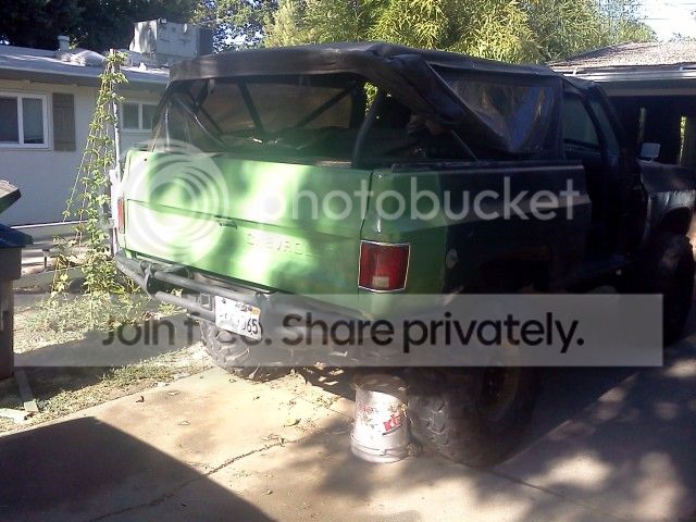

Also got the drivers side all painted up. Going to leave the hood and windshield frame black, think it will look cool and I dont really want to have to do the masking on it all :whistle:
