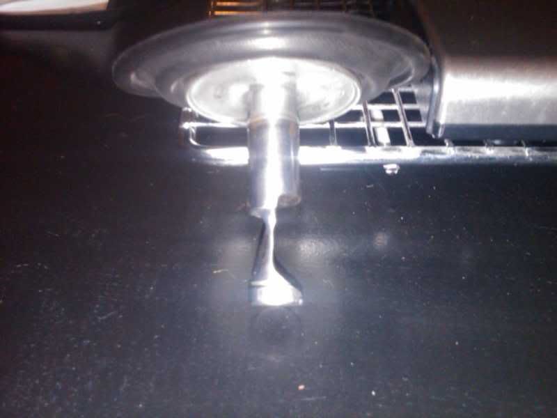

this is the fuel pin I cut for the '91.5 I used to have as a summer toy.
It hauled ass, tons of fun. Put a D80 with disks in the rear, from an '02. should never have sold it.

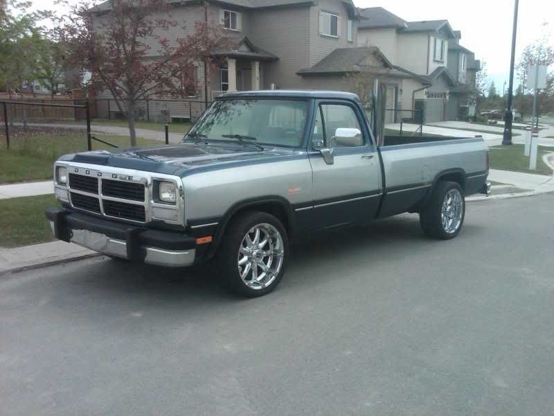

sorry, enough dodge talk.......... buy what you want. complete. this was the 4wd ranch truck. '95, p-pump, 47rh auto. interior was destroyed, box was destroyed, cab was destroyed (C pillar and rear structure) from round hay bales I imagine. but it ran great. paid $1500 for this one.
Take what you want out of it, gut it, sell off what you don't want.
and scrap, the rest.
