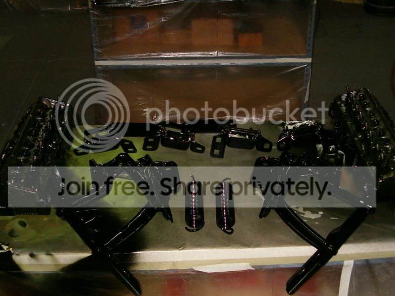

Got the hinges painted last night, front end and radiator support are off, I need to make a few mods to the windstar fan shroud...it was close enough to allow the fan motor to touch the idle pulley on the serpentine setup. (Kert is thinking serpentine, serpentine right now) So I'll try to gain some more clearance there somehow, and also this will allow me to get to the hydro assist install a little easier. Also having some issues with the fan relays and fuses...melted one 30amp fuse and holder, and it never blew the fuse????

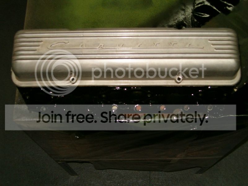

a pair of old fuelie heads that will see service in the pool room in the future:
the state of the Maiden today:
Why did you paint the heads black???
Martin
Its what was in the gun!:waytogo:
Those heads are some really desirable 461X heads, arguably the best head put on a 327 a little bigger intake port volume and slightly smaller combustion chamber volume...but they have had some damage to one of the bolt holes, a rocker stud boss is broken and a couple of the valve guide bosses are too. They don't match the build date of my car, so they will just be a display piece for the pool room in the future.
