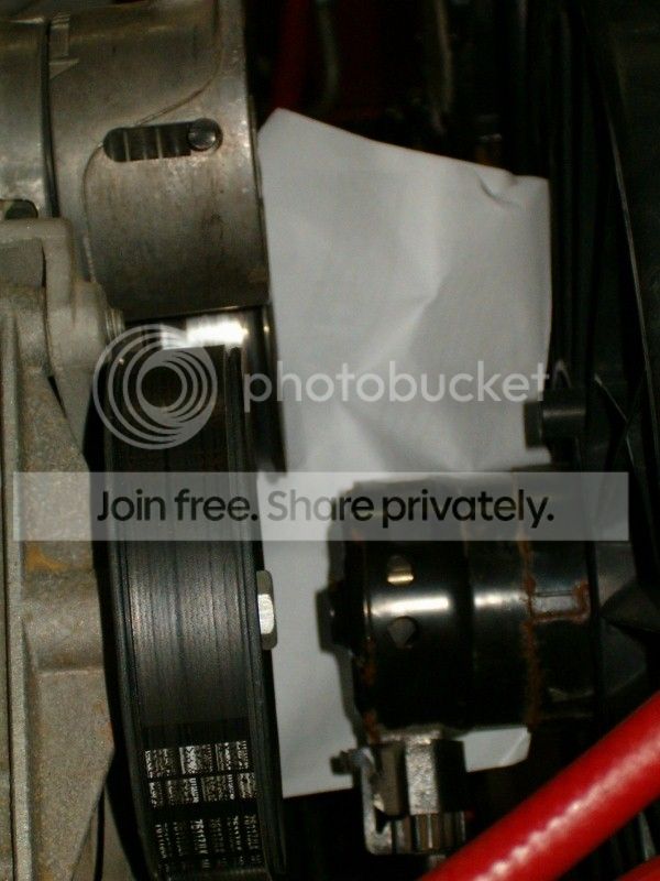

Radiator and front support back in today...made some more clearance between the Windstar fan motor and the tensioner pulley....seems they like to make a little contact, so now I got about 1/2" between them by cutting down the windstar shroud, and fitting it tightly to the radiator.

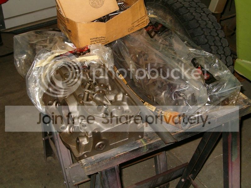

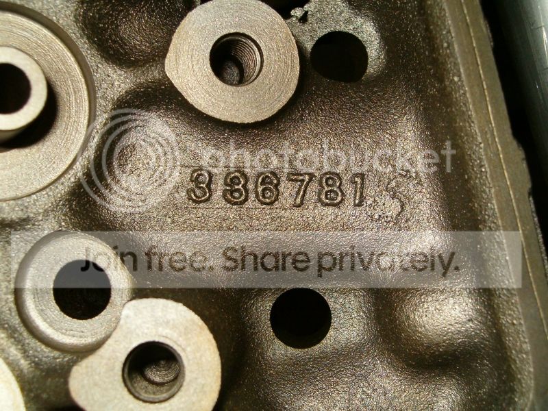

Also picked up a spare set of 781 castings today for 150 frogskins...
Thats funny, I had to do the exact same thing to my windstar shround to make enough clearance. I see you got the version with the flat connector too. There is another year that has the connector that sticks straight out, and that version probably wouldn't work too well for us I don't think.
As for the heads, those look like they are in really good shape, nice deal! Now sell them and buy some aluminum heads...:waytogo:
