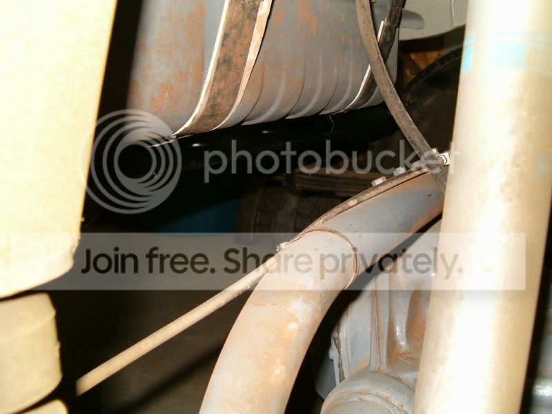

hangin' from the front...clears the axle fine.

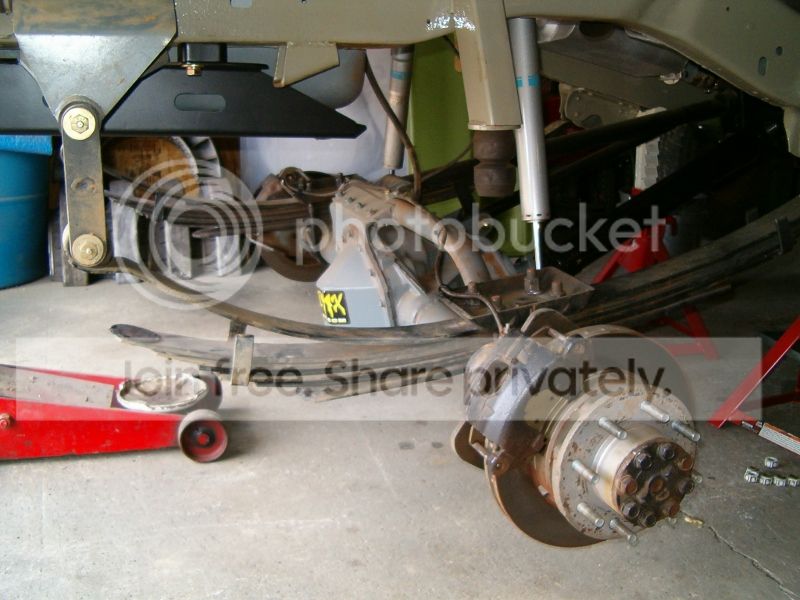

The rear spring pack got a couple more leaves added to it...these are from the original spring pack that were taken out...now has 6+1, instead of the 8+1...gained about 1-1/2" height overall. Needed it as my Timbrens only had about an inch of clearance before they were making contact with the spring plates.
full droop on the axle:

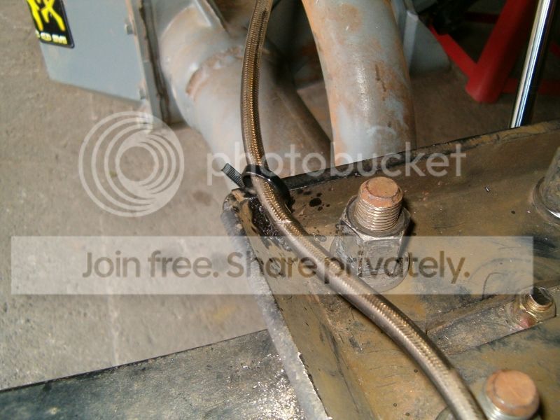

drilled a hole to retain the brake line in position away from the bumps:

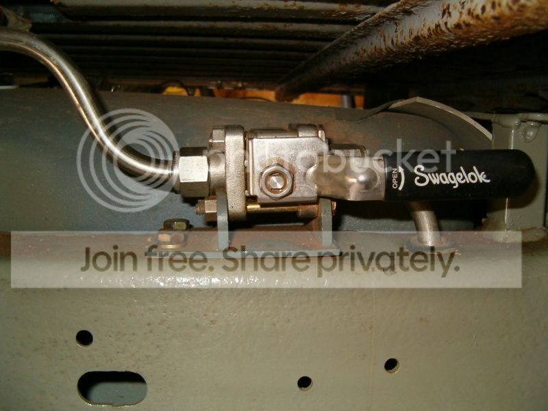

and tightened a few fittings on the fuel shutoff valve:
Should get some GM wire clips instead of a zip tie. That way the line isn't rubbing against the plate.
Martin
Martin
What type? got a pic of what you have in mind?

The ones that have a push in spike on one side and a split circle on the other. Like they use on the headlight harness for your Blazer from the factory. The smaller one.
Martin
I follow now Martin, but it needs to be on a different plane from the attachment hole...is this what your thinking?
I need something that would mount on a vertical and provide attachment to a horizontal line.
I know there is something out there like that clip with a swivel in it too.

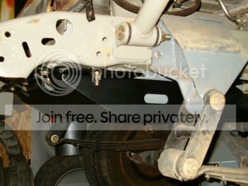

Working on the gas tank skid plate now...
