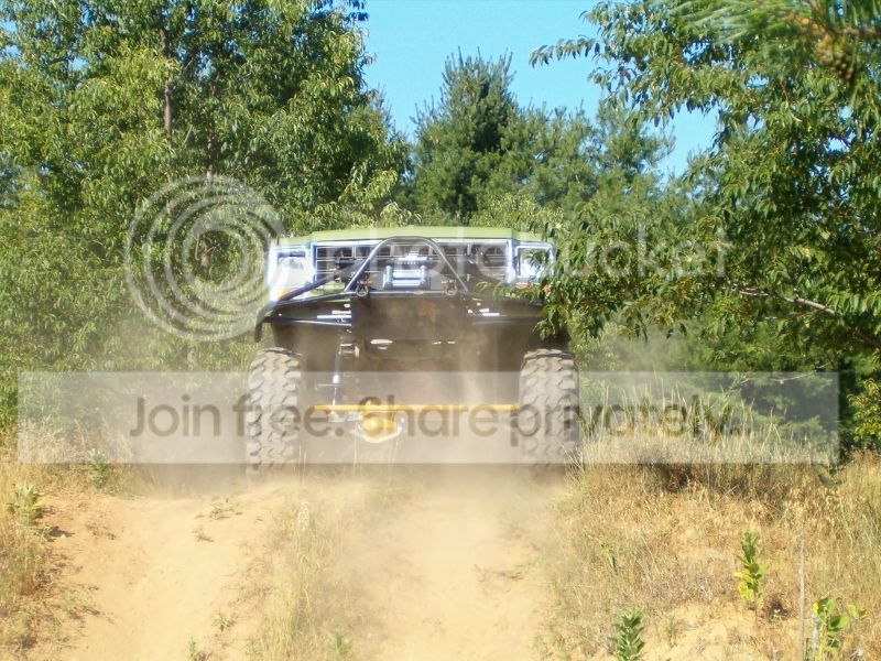

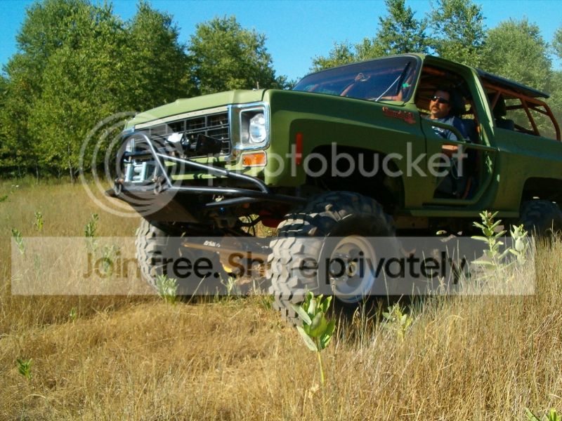

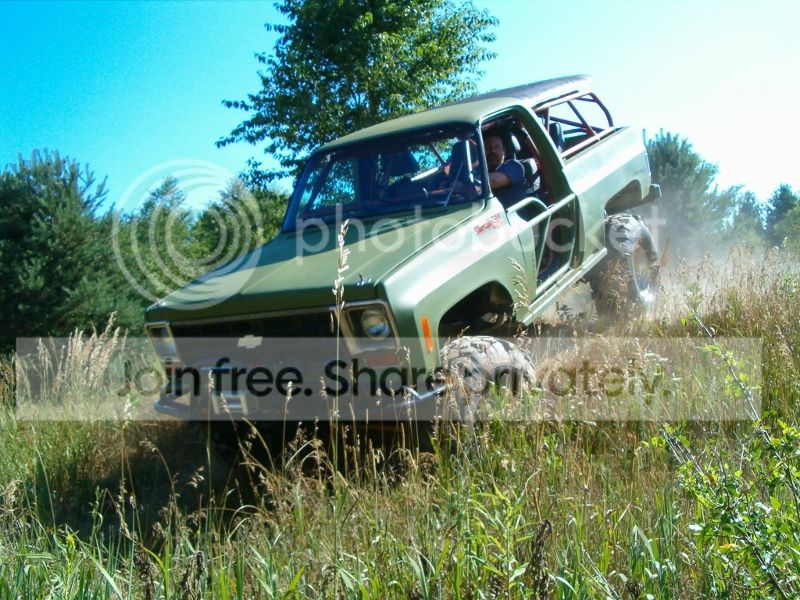

little bro and I went out back and played around a little today...he snapped a few pics:

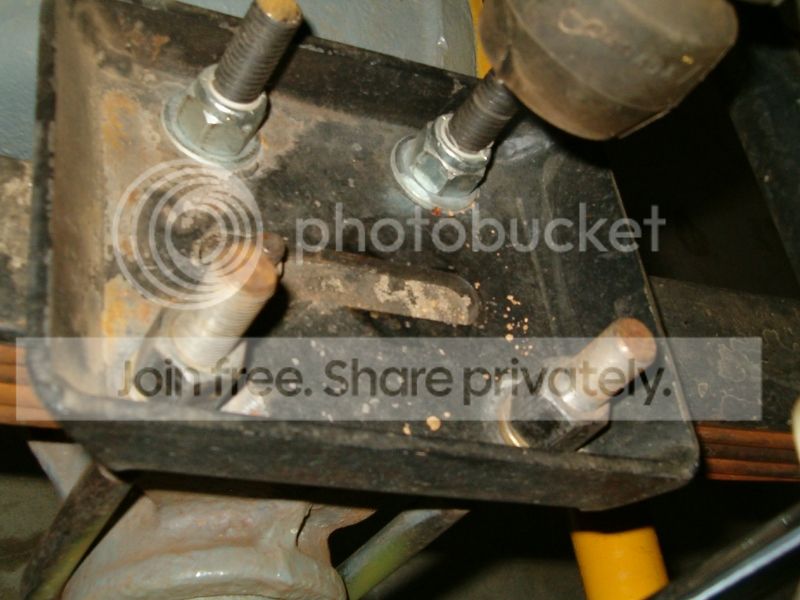

Checking out the suspension, looks like the Timbrens are working great, that big hit was not harsh, but it was firm, didn't feel like it "crashed" when it bottomed out.

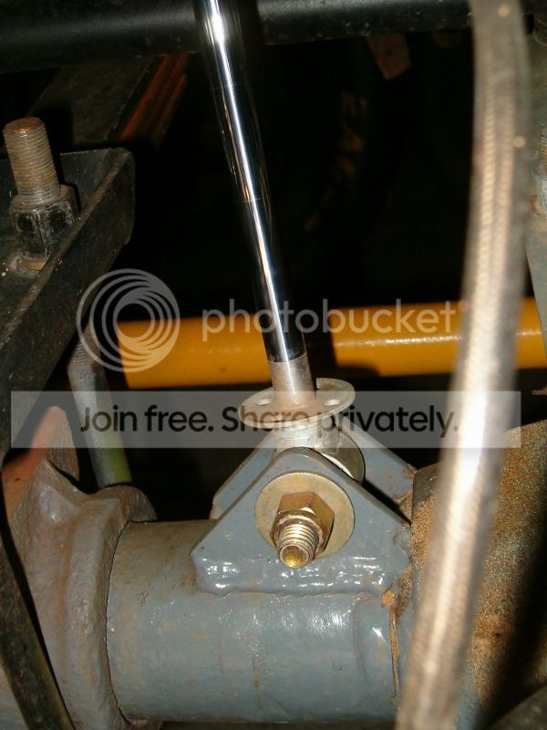

Looks like the shocks have just a little room left by evidence of the dust on the shafts.

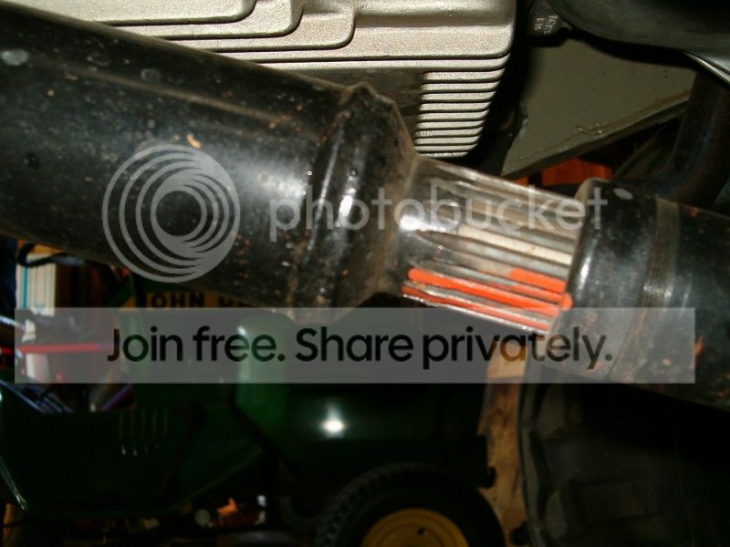

And looks like the driveshaft has a little left in it too.:waytogo:

Put small zip ties on the shock shaft, they will let you know how far they travel
