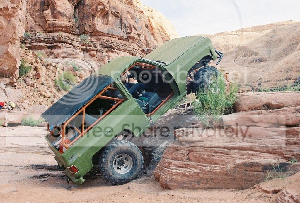

that's what I'm hoping for....something to think about:
say I'm sitting on a climb like this, or Chewy, or Potato salad....you get the idea....when I was having trouble with the carb, now if I only have a central stock FI pickup point and a 1/4 tank, I can see having problems...and as much as my engine likes fuel....3 gal/hr last time on the back side of the trifecta, I can see having issues later on in a trail run.
yah its possible, when I ran out of gas on Chewy though my tank was basically empty.
I think the fuel injection might improve you consumption too.
I know guys with 454s that I wheel with and they never have problems running out of gas even after a day
I agree with Eric, I've never been on those obstacles, but I have been on several angles under all throttle conditions and never had any issues.
I've also gone full throttle all the way up test hill with only a quarter tank and didn't have one hiccup, I did fill er up shortly after that because I thought running on a quarter tank was pushing it. The stock baffle pan works pretty well, and honestly, I don't think you will be able to make anything that works much better and is reliable in all conditions for the purpose you need it.

Eric, you know what I'm talking about when I was trying to make it up Chewy and Potato Salad...the stalling drove me nuts, I know when we dumped that 5 gal in your truck you didn't have any problems that I saw on Pritchett.
I'm going with the 31 gal and will make room for it, my upper tank mounts on the frame will have to go, as well as the rear floor section above the tank to make room for it....I still want to keep it high in the frame and use my kickass tank skid made at DIY4X.
I do have an issue with the flange on the tank mounting it that high, the flange has to be folded up to clear the boxing on the frame, I'll have to work that out again.

You wont be able to use your fancy quad fuel pickup? Couldnt you just use the carb tank and keep that setup in there and hook it up to the FI sending unit and not need baffles? Just thinkin out loud.
In my '90 K5 the ONLY time I have ran out of fuel and stalled was when I was on an extreme downhill angle, and my tank was on E.
Martin
He could but the high pressure EFI pump should be on the bottom of the tank if possible. And any restriction before the pump is not good, any restriction after the pump isn't as critical because of the high pressure.
Also, although that fancy super duper double triple pickup tree looks like it would solve the worlds problems, I am not convinced it isn't part of his stalling problem until I see it proven otherwise. I trust the factory setup more.
To me the quad pickup would be the opposite of an obstruction :dunno: i guess its more lines and such bit its 4 not one so it should allow lots of fuel easily in my mind. Stalling on an angle to me seems like a carb issue but i cant say for sure. But if your gonna buy a new tank anyways you may as well get the tbi one. My thought was to be able to keep the tank he has and save money instead of gettin another tank.
I'm not worried about the restriction Adam, the problem is how reliable are those pickups? With 4 pickups you have a much greater chance that one of them will be sucking air when at any angle or acceleration. How reliable is it at shutting off when not submerged, and how quickly? Because if even one can suck air then it will have no suction for the other 3. It would be like trying to suck through a straw with a hole in the side right above the liquid level.
Thats a great point heath. Single pickup with baffles does sound mich better now. :waytogo:
