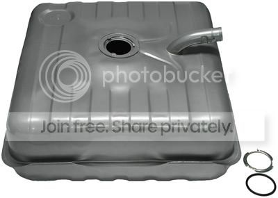

So this is what Kert has in his truck...
the stocker 31 gal tank...

I would like a ~30 gal tank with the walbro pickups in it, and the factory sending unit for gauge readout as well as a fuel line return.
other wishes are for a front low mounted outlet to go to the external mounted FAST pump and filter.
a access panel on top to get into the tank for whatever reason.
a factory type fill point to match my existing fuel filler location.
downside to a factory type tank is the seam around the middle, I had to fold it to get it to fit between the frame rails....
Thoughts on the Walbro setups concerning the bleed type and non bleed types?
a little education on the Walbro's...notice the bleed type pickup suggested for use in a system that might see all pickups exposed to air....

I have never used them before but after reading that bleed hole thing before and now, I would say you should not run a bleed hole. air in your fuel line would be bad with EFI. And also, you should not run dry at all pickups, if you do your tank is empty.
Also, by removing your fuel cap and unhooking the supply line, if you evern do run it completely empty, that would release the vacuum.
