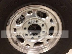

found another set of 39.5 TSL's, same tire as I have on the Alum. slot rims!
had to try a quick phot op w/ the DIY4X recentered H1's....I'm liking it!
I think that roll cage color(s) will tie in nicely with the rims/cage!
love the look of the gussetted centers. The rock rings must work with 12 bolt wheels too? Probably too late for little drainage half holes around the perimeter of them? Mine get full of crap and have drainage holes still.
^^Looks good Dave! What do they weigh...lots!
just for you Max!
Super Swamper TSL's (used) 39.5x15-16.5...83lbs
Hummer H1's recentered and reinforced by DIY4X...58lbs.
total wheel tires combo...141lbs.
Kert cut them to my design...I was going for a HD alum wheel:
good thought on the drain holes Matt...hmm what to do now?
You need a tire groover Dave.
If you can notice one has been grooved already in the area between the blocks...he just took out the ribs between them, gives it a bit of a different look....any links to a economical groover? I got no experience w/ them things..:dunno:
