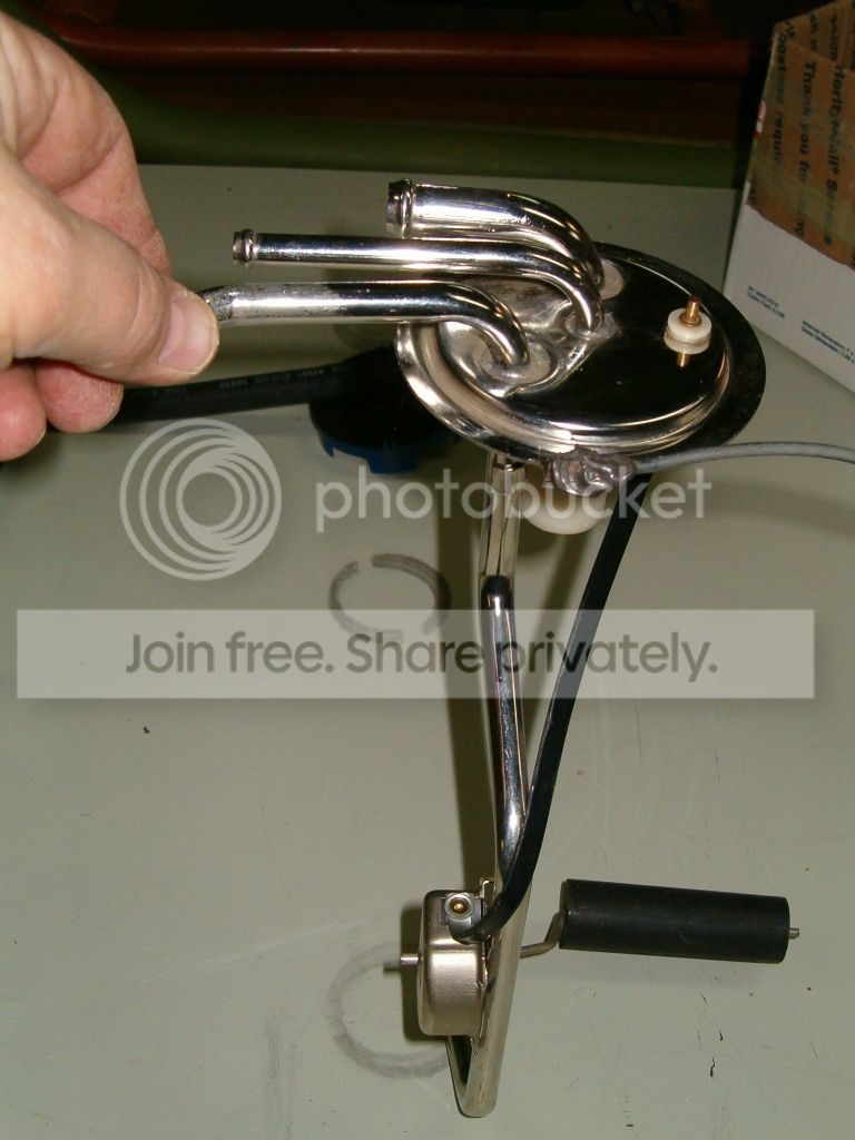

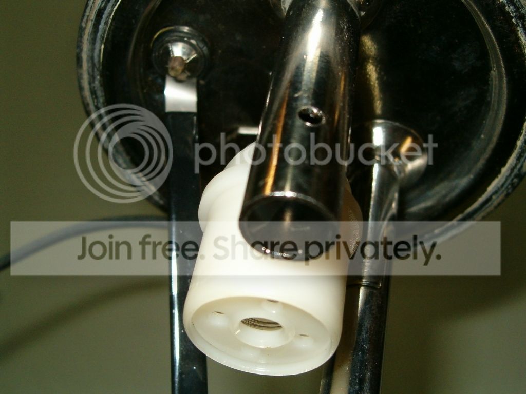

Finally got the tank out....I think I found the dead spot problem...

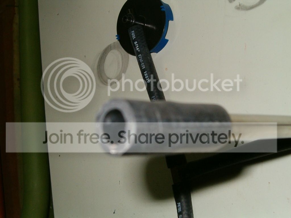

that hose that connects to the hard line on the pickup/sender unit, needed a clamp, it pretty much slipped off, when I pulled the unit out of the tank. the hose (all fuel submersible rated) basically was soft enough to slip on and off that pickup line.
Everything else on the fuel system looks good.
Will probably be getting rid of this factory sender pickup (new in 2011) anyone interested.

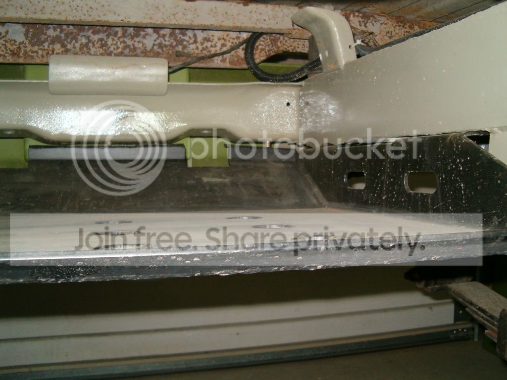

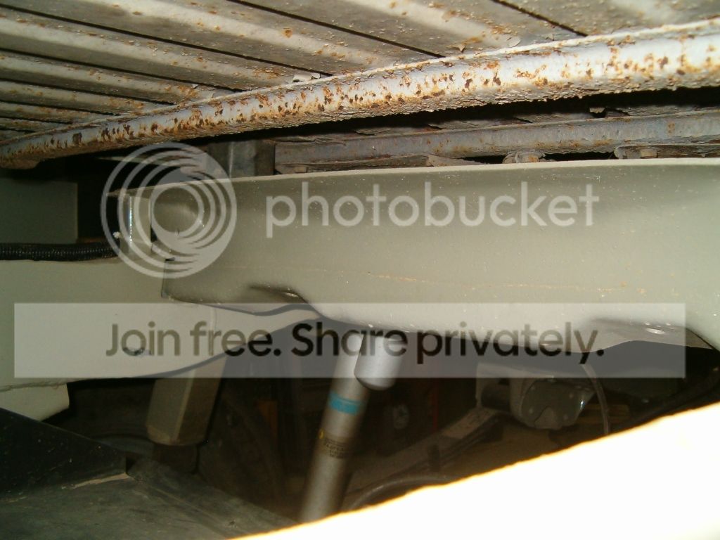

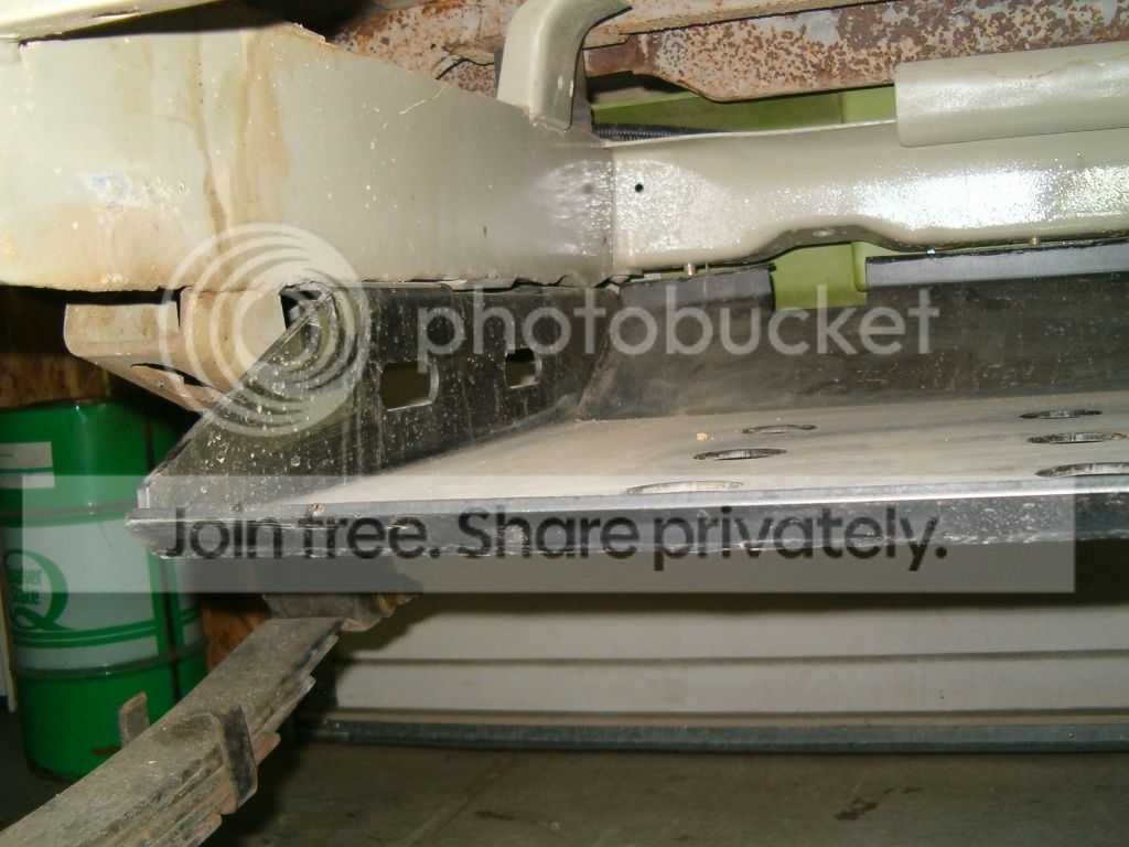

Here is the hole we have to fill with a fuel tank (Kerts)...
I'll be removing this upper tank support to make a little more room too.
the tank will be located on the skid plate
