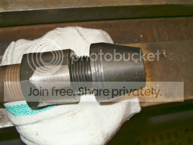

I kind of wonder if something is just slightly out of wack. I remember you had major issues with a kingpin on this axle right?
Yes, the threads were out of round...he took a jig and bored the hole, then welded in a sleeve with new threads...
