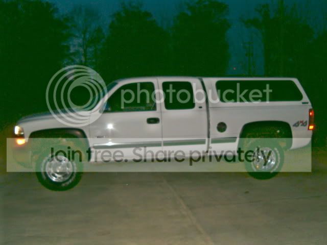

Well, this has taken most of my time since getting back from the Charlotte drags. My Suburban has developed what I think is a rod knock, and I've been looking for something with a little more Balls to it, and my neighbor had this truck....a 99 2500. It has 175K on the clock, it runs and drives real good. He is a smoker so the interior was literally dirty enough to choke on....thick smoke layer on everything in the front. I had to get the drivers seat repaired as the leather was worn, and had some holes in it, and some of the padding was torn up....that'll be about 225$ to get that repaired, otherwise the interior cleaned up really good, with a lot of scrubbing. I went through it from front to back, and put rear brakes on it, and changed all the fluids and filters in the drivetrain. Everything looks pretty good for 175K on it.
In addition to the fiberglass cap, he gave me a roll up toneau cover, and a hard lid cover for it.
I put a new set of Goodyear Duratrak's on it, and a new set of footwell liners from WeatherTech.
So now I got a decent daily driver again, and can let the burb set while I get to work on the Vette, then the IronMaiden again.

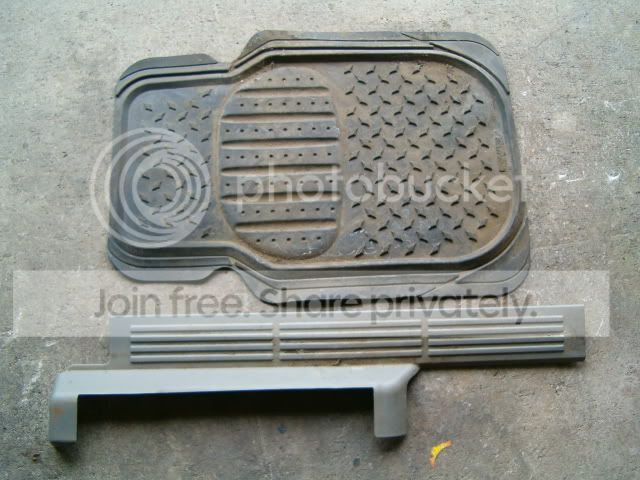

It was pretty much this dirty throughout:

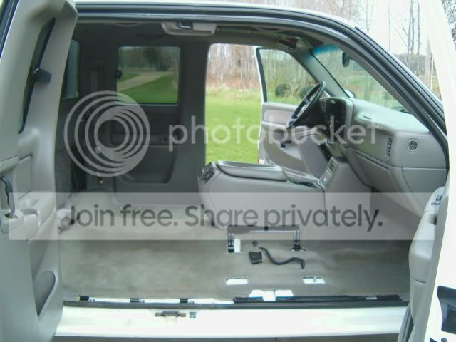

The interior after the cleaning:

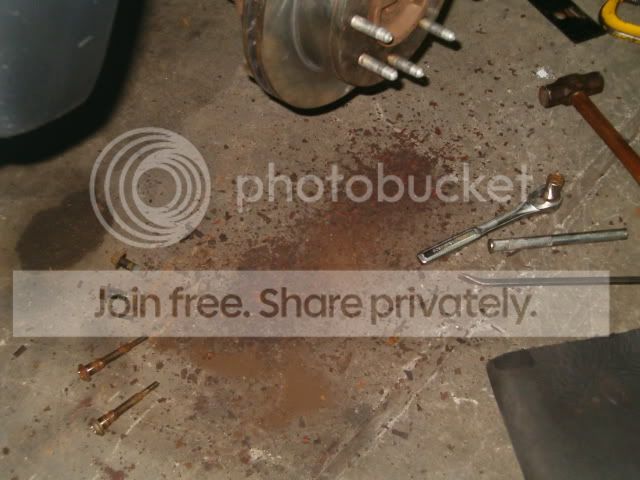

This is what you get with a brake job on a Michigan truck:
Nice.
At least you didn't have to torch and beat off the rotors like we did on my buddy's In Law's '04 1500.
Nice.
No...thank God AJ, I just had to get them past the rust on the hub, and the parking brake shoes.....Is there a way to adjust those with the rotor on? I didn't see an access hole by the adjuster.

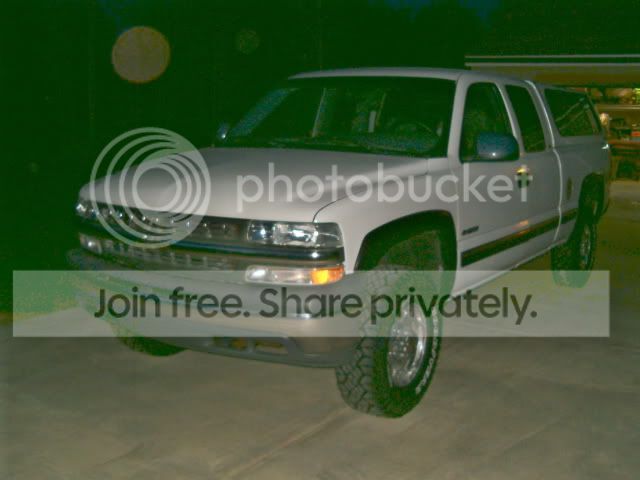

Here is a couple daylight pics....I sure hope this truck serves me well for the next couple years.

Oh, what size are those tires, I like how they sit? Dad had a '00 K2500 like that and with the stock 245's it looked silly.
That's a good looking truck and should serve you well. Those 6 liters are screamin' engines.

Dam, was that thing run in the water alot, or just from the salt?
I did find out that there are two different sized rotors....the big center hub bore for the 14bsf, and I suspect the smaller hub bore for the 14bff.
The parts guy was on top of it, and told me ahead of time to bring in a rotor with me....there is only a couple tenths/inch between them.
The tires are 265/75/16....31.8 tall, and 8.5 tread width, 10.5 section width.
The truck has airbags on it for extra load capacity. those are run @ 20# everyday.
This 6.0 is like having a BB, after driving a non vortec 350 Burb w/ 3.42's.

We were very surprised. Was supposed to be a "pull it into the garage, all three of us attack it, replace the rotors and pads on all four corners and be done with it" swap. Done in an hour or two. Then we discovered NOTHING on the suspension had been painted by GM. Nothing. You know that heavy coat of suspension paint that stuff like knuckles, control arms, brake parts, etc get? Nada. I think it's a cost saving or somehow that one got through.
Doesn't help that his MIL apparently never washes it and the few times she does in the winter it's the $4 el cheapo blast and go wash. Nothing on the undersides...the paint is shiny so it must be good.:crazy:
Okay, I have 265's on The Blazer as well. They just look so much better than the 31's and smaller. A lot of folks see mine and seem to think I have 33's and a small lift yet it's stock. Only the tires and wheels are different.

Makes you really appreciate when a job goes off without problems doesn't it?
I do think they stopped using the coating on stuff quite a while back....I remember seeing new trucks with surface rust on the underneath components already???
These Goodyears are 31.8 tall, and its all the front fenders want without some trimming, and I don't need to get into that right now. I sure rides better than with the worn out BFG's on it. No more shimmy to it.
My wheels are badly corroded were the salt has got under the clearcoat. I cleaned em up by getting the loose clearcoat off, and using a rust neutralizer, and a heavy stiff scrub brush with Ajax on em....at least it took the dark colored corrosion off...now it just looks like snowflakes where the corrosion was...I'd like to get them stripped and polished and recoated, but that is down the list a long way.
