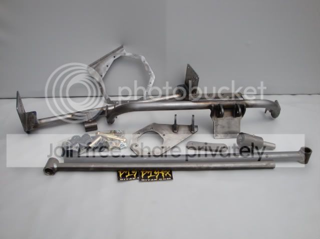

From what I read, and have talked about I will be needing a traction bar/antiwrap setup. I've also been trying to figure out how to tie that into a truss setup, and bingo...DIY4X makes those, so I got those coming to combat those problems. Best part is it will all work with the Flatback cover, and the pinion guard I have from them already....
I will have to customize the front crossmember for the traction bar as I'm still going to box the frame, but it shouldn't be a big issue....this should be a great addition to the rear suspension.
Here are the components of both kits to fill the bill for me:
