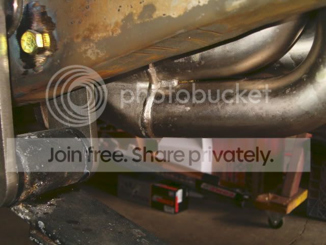

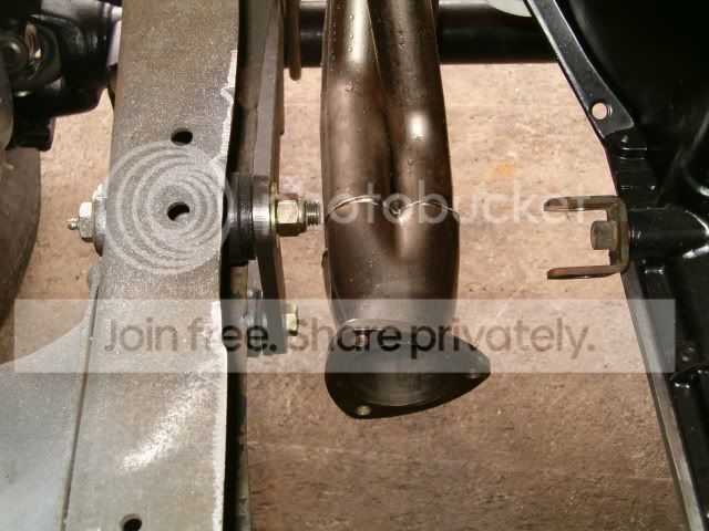

I'm in a pickle about this, what about that front shackle/hanger setup? I don't have all the weight on the chassis obviously, but I need to make this right before I get the frame boxing done....
Pretty straight right now, which isn't good...

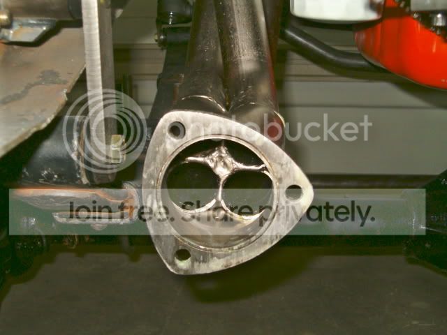

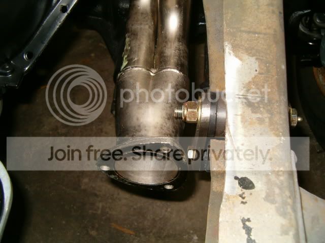

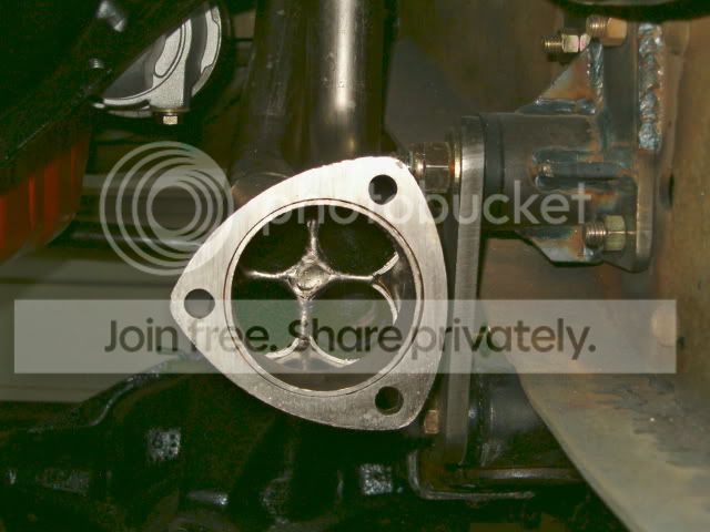

and with the headers in the position they are, it creates a problem moving the hangers on the pass side:

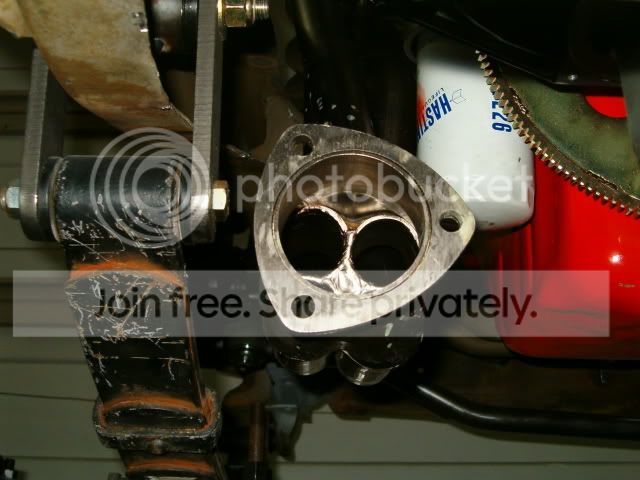

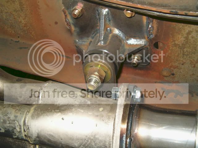

and the drivers side:
Too close for comfort for me... what can I do?
Get longer springs and do a B52...$$$$, and more delays?
get about an inch or two longer spring to move the shackle angle back more?
any ideas?

I'm thinking they will be fine once you get everything on the frame. My rear shackle angle looks borderline but it rides like a dream, my front is crap because of the pro comp lift springs. Of course the front rides like crap, but I think it's more to do with the springs and shocks than the shackle angle.
I say wait on getting new springs and B52's until you get all the weight on them, just in case your fears are unfounded and you don't have any wasted money.
Whats the distance between the the front hanger and the rear upper hanger?

No Max, we got about 6" on the ground right now. I think it was in Oct. when I took that pic. It was a trial fit of the tires :D
I know I got to get it to squat more in the front. A straight shackle angle isn't good at ride height. I can see another 300 lbs. on the front, plus body weight too. Maybe that'll make it drop an inch or so?
The DIY4X hangers are in the stock location. Not sure what the measurement is between them :dunno:

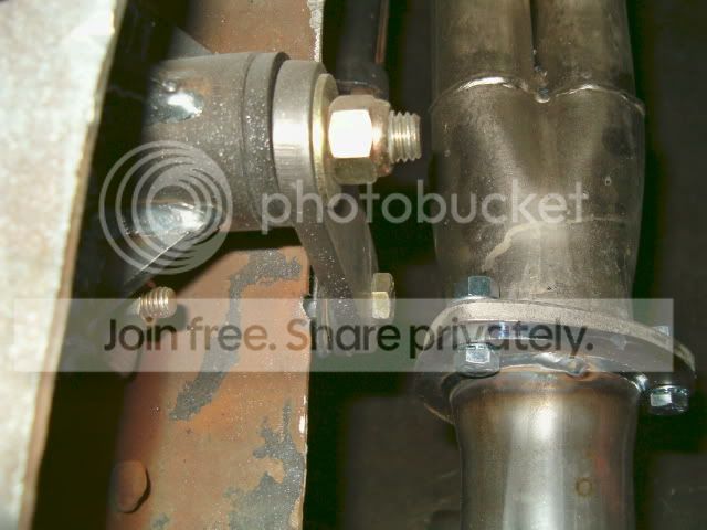

If you turn the bolt around will that give enough clearance to move the hangers?
It will help Eric, but I think I need longer shackles too, which will push that drivers side a little closer to the collector, not as bad as the pass side though.....
The pass side I can swap ends of the bolt to allow a little more clearance where it is, but if I move the hanger forward it will be a lot closer to the header collector.
Maybe I can take a leaf or two out, and try to ratchet the front end down between the axle and frame to see what happens with a lower ride height?
slotted mags...dool...sorry, i have no technical advice
Honostly I would not waste time weighting stuff down, its a pretty regular thing for that front shackle to be straight up and down or even angled just slightly forward(the wrong direction) with just about any lift spring.
Your motor is all poly mounts right?
You might have to have them super close, I would put the top bolt pretty darn close without much worry. Its the lower bolt I would worry about. It moves around alot
Alright Eric, I've been doing some more thinking too....I'll leave it alone for now.
The engine is Kerts mounts, with the poly. Its the lower bolts I'm worried about too. I know they can move alot with the axle twisting on the shackles. I got the poly bushings in the springs too.
I would like to get the frame stuff done before April, so when the body is on, it can be left on. I will get as much done to the frame as possible before then in prep for what we have going on when you get here.

What front springs do you have? Are they pretty soft? As long as they aren't super stiff lift springs I'll bet you end of up a decent shackle angle once you get all the weight on. A longer shackle will make your shackle angle worse...
I will wait it out for now, maybe try to cycle the suspension in the near future and see what I got then. I know if it settles an inch or two that would help a bit, as long as I can get the shackle bottom pointed towards the back, so the shackle actually does its job of compressing when the spring rises, instead of just sending a shockwave straight up the shackle and to the frame, making it harsh.
I think my springs are Superlift 6", they are 5 leaf as is. I may be try to move the shackle mount forward, if it looks feasible.

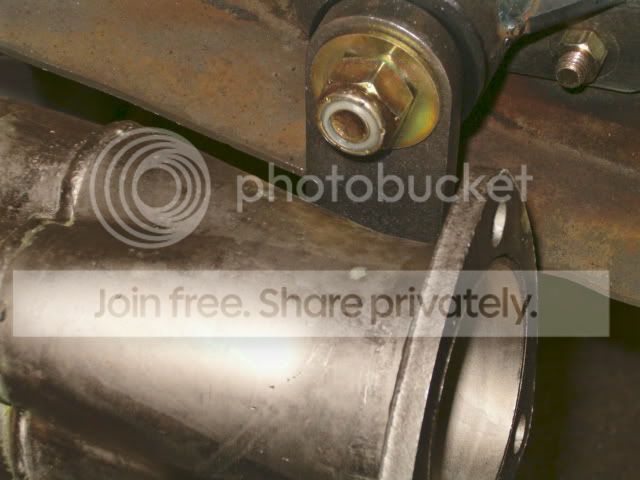

Dave, what I would do is buy stover nuts, the all metal locking nuts, which are thinner than the nylon lock nuts. Then, cut the bolt off flush with the nut. Because I think the nylon nut that close to the header collector is not going to do anything anyway, they are limited at like 250 deg or something.
Also, I would not flip the bolt around if it's going to be blocked by the header, , the head is not much thinner than a stover nut, and you don't want to have to remove the header just to replace a shackle bushing.

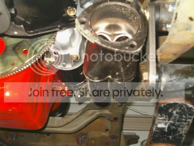

Could you bend the headers in alittle to give you more room?
Or would that give problems with the starter getting to hot?
Also those headers look $$$ so maybe you wouldn`t like to do that.
