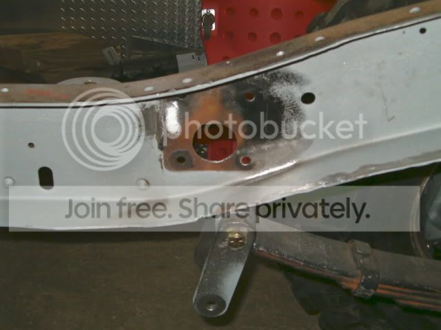

Cut off the upper front shock mounts, as we will be making hoops off the engine cage:

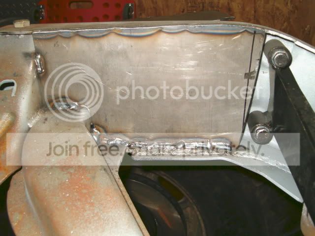

Got the first front piece molded to the frame and welded in, leaving room for steering box access:

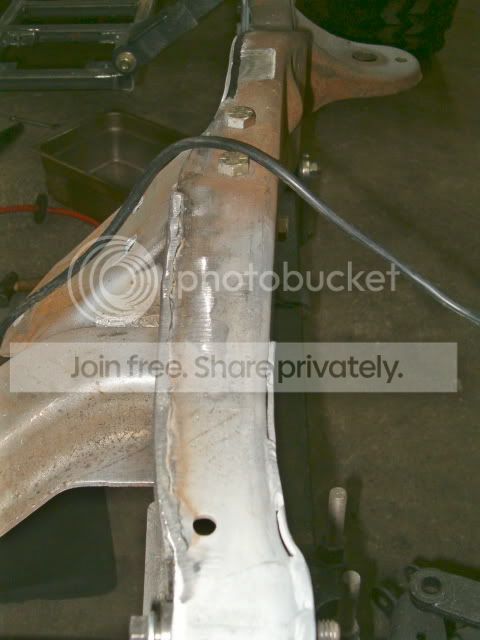

Got to the second piece and it covers the spring eye mount. Well Eric and I have discussed this a bunch and decided to leave this piece just tacked in place in case we needed to move the Spring eye mount. As I was trying to decide how to tack such a long piece in, and then have to weld it in later while everything was in the frame I decided NOW is a good time to move it to a more optimal location forward to increase the shackle angle:
Got to the second piece and it covers the FUSH mount. Well Eric and I have discussed this a bunch and decided to leave this piece just tacked in place in case we needed to move the FUSH. As I was trying to decide how to tack such a long piece in, and then have to weld it in later while everything was in the frame I decided NOW is a good time to move it to a more optimal location forward to increase the shackle angle:

I'm talking with Eric tonight to confirm how much, but I'm thinking about an inch forward. With the weight out of the truck the shackle is leaning forward at the bottom, but only about an inch, so making it straight while empty should put it about 1.5-2" back when fully loaded...should be pretty good at that.

After talking with the chief engineer on this thing, we've decided moving the Spring eye mount forward 1.5-1.75" would work great....Eric has the same springs and comparable weight on his K5, and guestimates this would work out pretty good, so thats next before more boxing.

After talking with the chief engineer on this thing, we've decided moving the FUSH forward 1.5-1.75" would work great....Eric has the same springs and comparable weight on his K5, and guestimates this would work out pretty good, so thats next before more boxing.

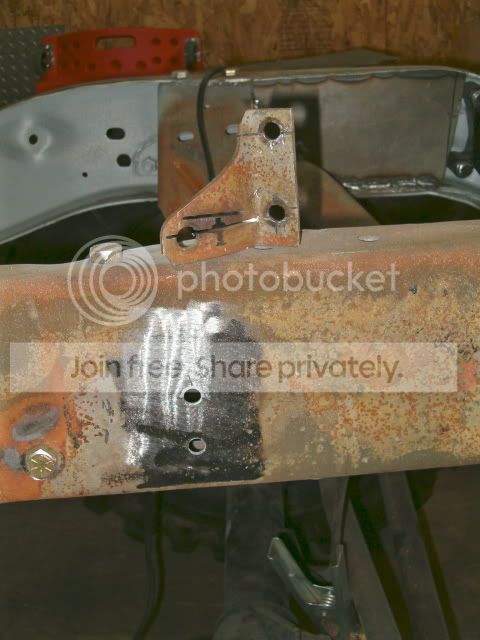

Here's the new angle moved 1.5" forward. The mounting is level with the previous mount:
Beveled the edge of a washer to fill the hole:
Tacked in:
Welded in place:
The Front Shackle eye mount :

Using stock length 6" lift Superlift softride springs, but really wanted to get this angle more acceptable than staight as it was looking like it would end up. May go to a 52 or 56 in the future though...perhaps coils and links:dunno:
