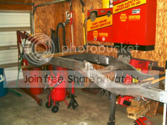

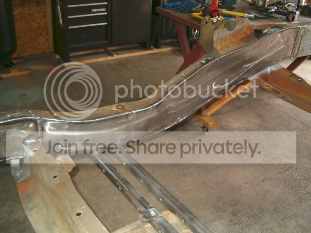

Finished welding the topside stuff today, and got the frame completely stripped of everything that is bolted on. Tomorrow finish welding from bottom side, and a few tricks from Eric, and we're sandblasting.

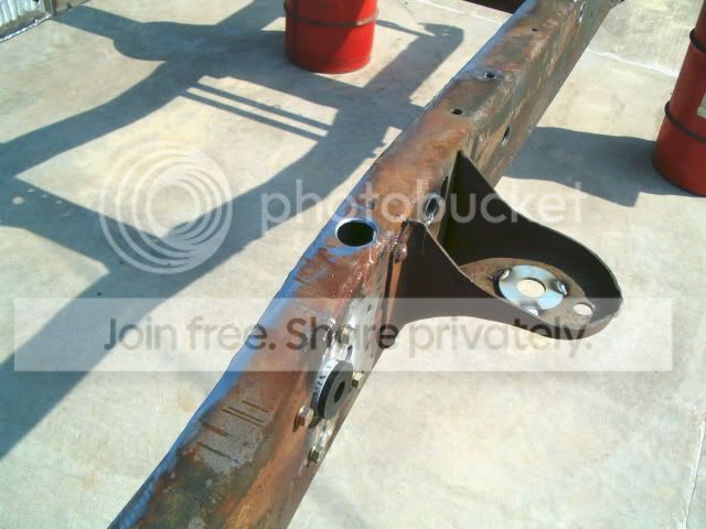

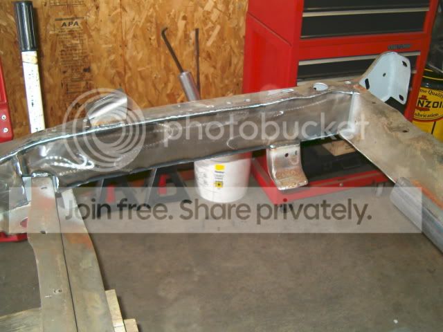

A pic of the gap to be closed in, by using a C clamp in a few spots. The metal is quite compliant to form into these gaps by clamping force, and tack welding in a few spots.
Just have to make sure the tacks are good solid ones or they'll pop.

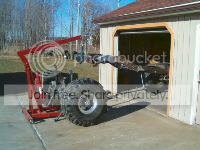

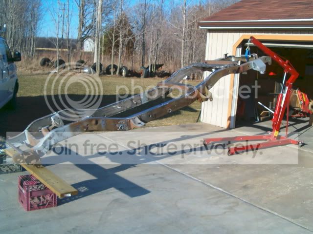

For a second there I thought your hoist had Swampers on it.
How'd you flip it? Frames ain't light.

Get a short weld on and tap it with a hammer. It'll form up nicely that way too.
:haha: It does kinda look that way don't it...cool off road cherry picker!
We set it down on the ground and my brother and I flipped it over....I was handling this thing by myself when I had it acid dipped, but this bastard is getting heavy now.
We flipped it, then hoisted it up again with the cherry picker on one end, and a floor jack under the back to get it back into the shop. More welding in the AM, then blasting in the PM.
I think I tried that before Kert, and I like the C clamp because it will hold it in place til tacked up too. PM sent!

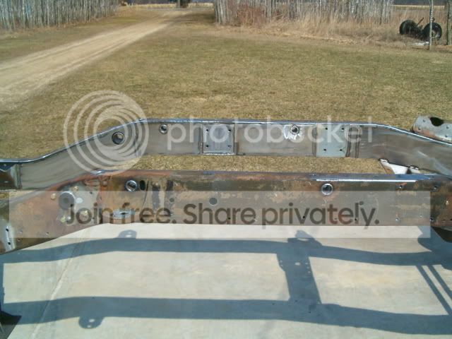

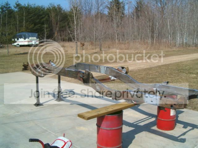

Finished all the frame mods and welding today, cleaned it up with a flap disc, and moved it outside for sandblasting. This thing is fun to move around by yourself...NOT

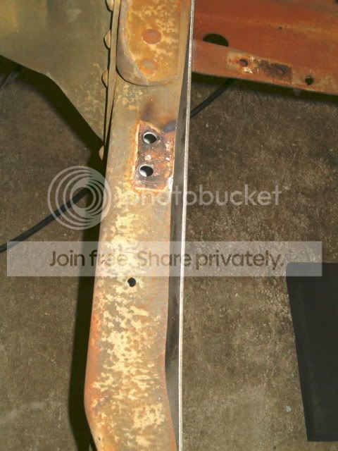

The finished boxing kit:

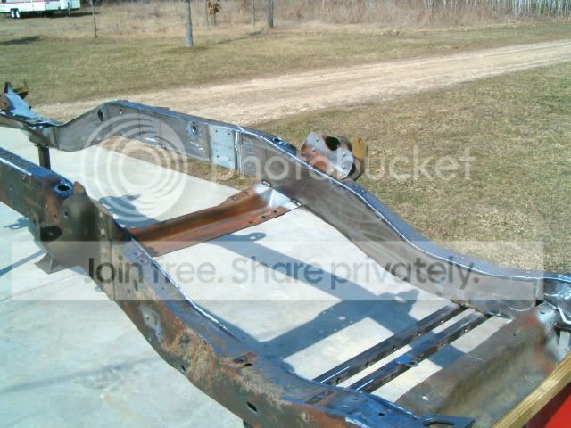

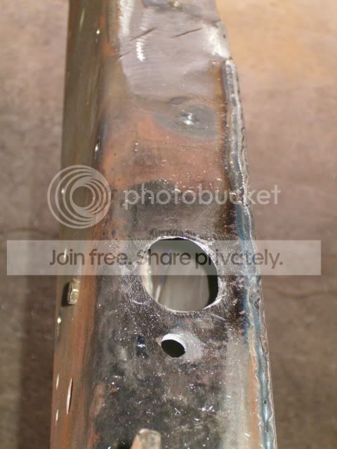

A couple DOM reinforcement tubes for the middle of the frame rails (Erics' Idea)

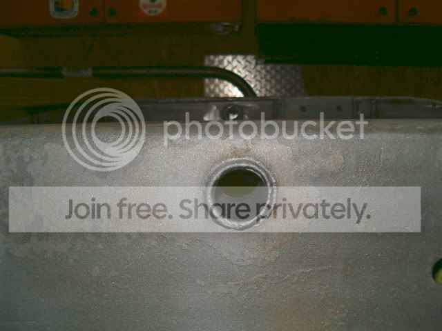

Made some holes in the bottom part of the frame for cleanout/drainage:
The blasted frame from the bottom side...I still need to flip it over and do the topside, but it started threatening rain so I cleaned up the sand and moved everything back into the shop.

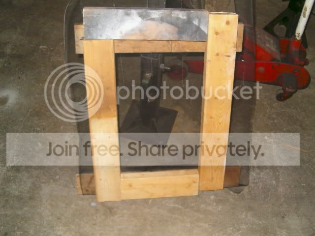

This quickly thrown together sifter has already saved me about 15$ in sand....I've gone through 400lbs of boughten sand and another 150-175lbs of recycled sand already.
