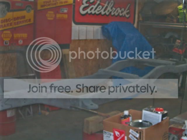

Finally got done with the frame blasting. Had another nice day to work outside, bout 50* just right for blasting.
I got it cleaned up, blew all the sand out (I think) and then moved it into the shop, wiped it down with laquer thinner, then shot it with a light coat of zinc weld through primer. This will serve for a base, and will be left that way down most of the side of the frame and the top in the frontal area, as we will be tying in the engine cage/shock hoops, and sliders in those areas. The rest will get a coat of Urethane primer, then the finish coat of some kind of Navy green/grey something that looked good on the chip chart.

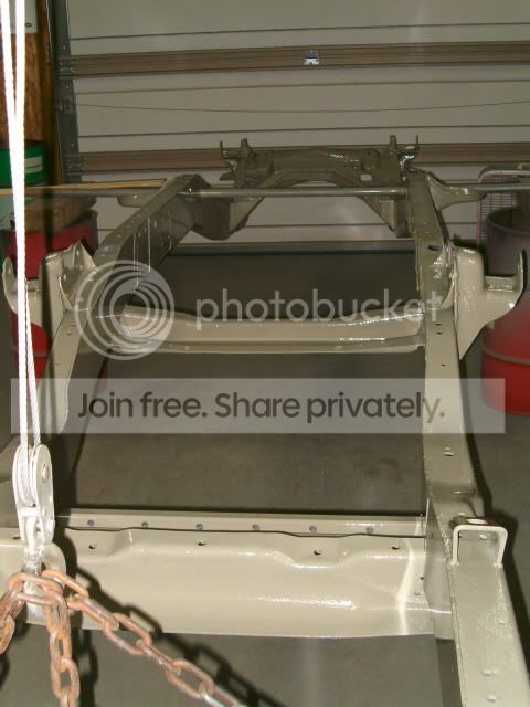

Most of the frame is painted, with the exception of the bottom side, and the taped off areas which we'll be welding in the vacinity of.
Oh that looks nice!! Are you leaving it that color?? I like it for sure.
Yep, thats what came out of the gun, so it is what it is, and I like it too!

Pop came and helped out today, we got a few items on the 14BFF list completed, and I got the frame underside painted today.
Painting is done til we get the cage and sliders, etc installed.

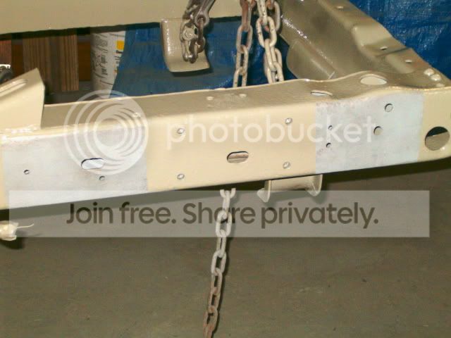

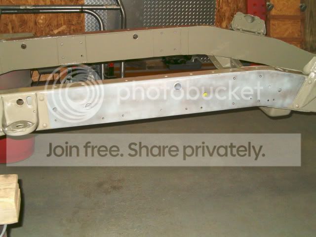

ERIC, these are the areas I left in a light coat of weld through zinc, in addition I left the top of the frame, in the engine compartment zinc coated also.
looks good Dave, dig the color.. what gun ya squirt it with? paint and primer brands?
Thanks Paul, I shot it with my old DeVilbiss syphon feed.
Napa Zinc weld through for a base primer (rattlecans), then
Nason SelectPrime 2K Urethane Primer 421-19
Nason Ful-thane 2K Urethane Single Stage color.

As far as where you left just primer it looks fine. If we need to grind some off we can.

I hope the primered spots are where we need them, if not we'll be grinding paint.:whistle:
