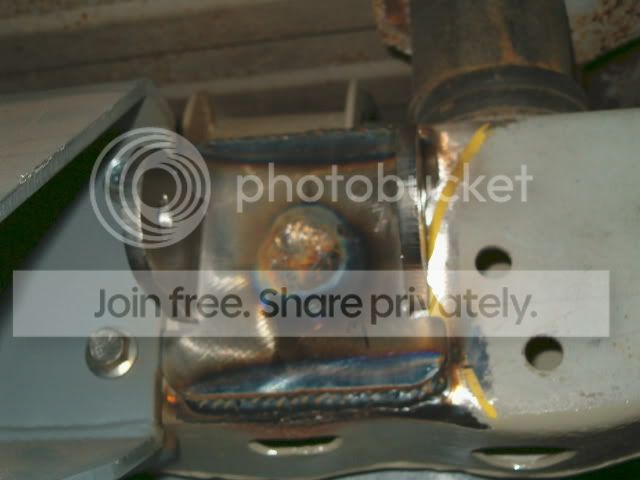

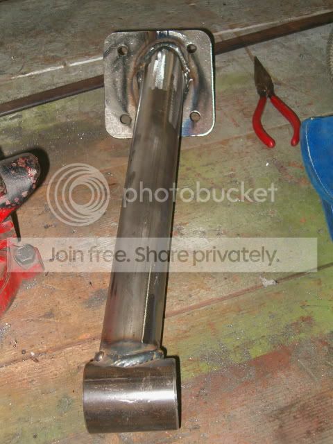

Aren't the cage tie ins supposed to the other way? It seems like your current setup is just a pivot
Here is all my camera battery had left in it.

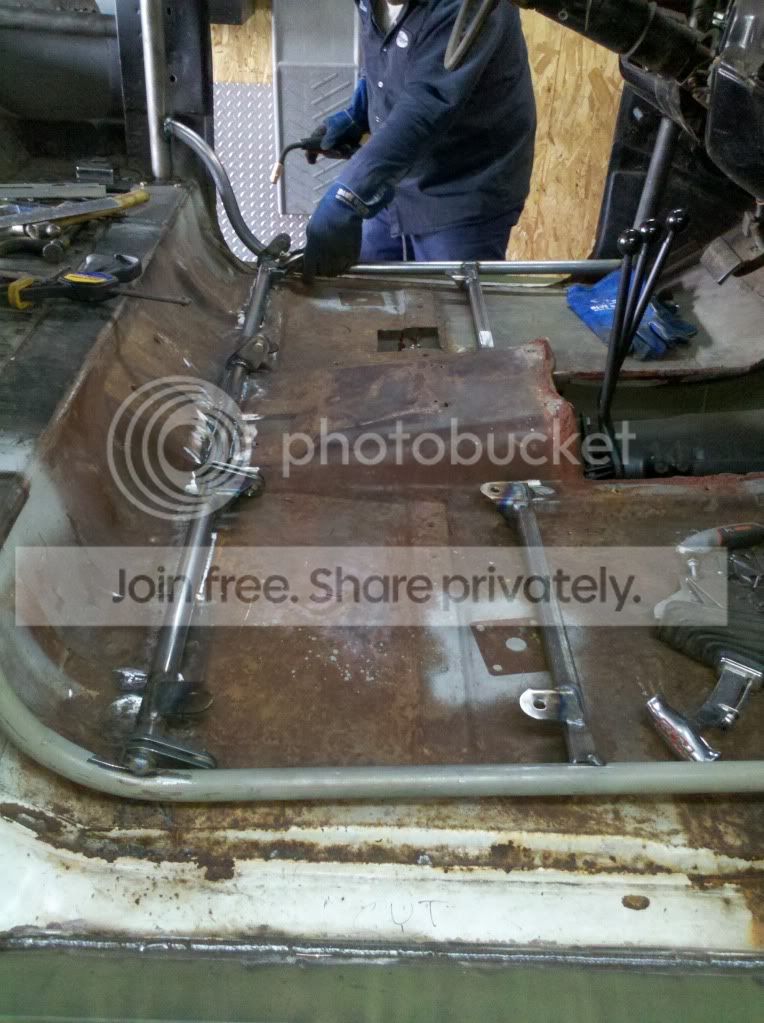

Eric and I got off to a slow start today, but did some rethinking about a few things, and had to change up a couple plans. The rear portion of the cage will be a raised crossbar section to provide more headroom than the S&W original set up.

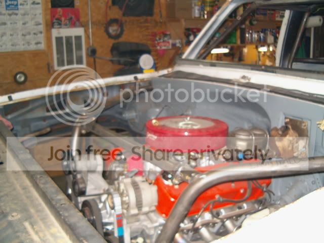

The engine cage is just plain cool:

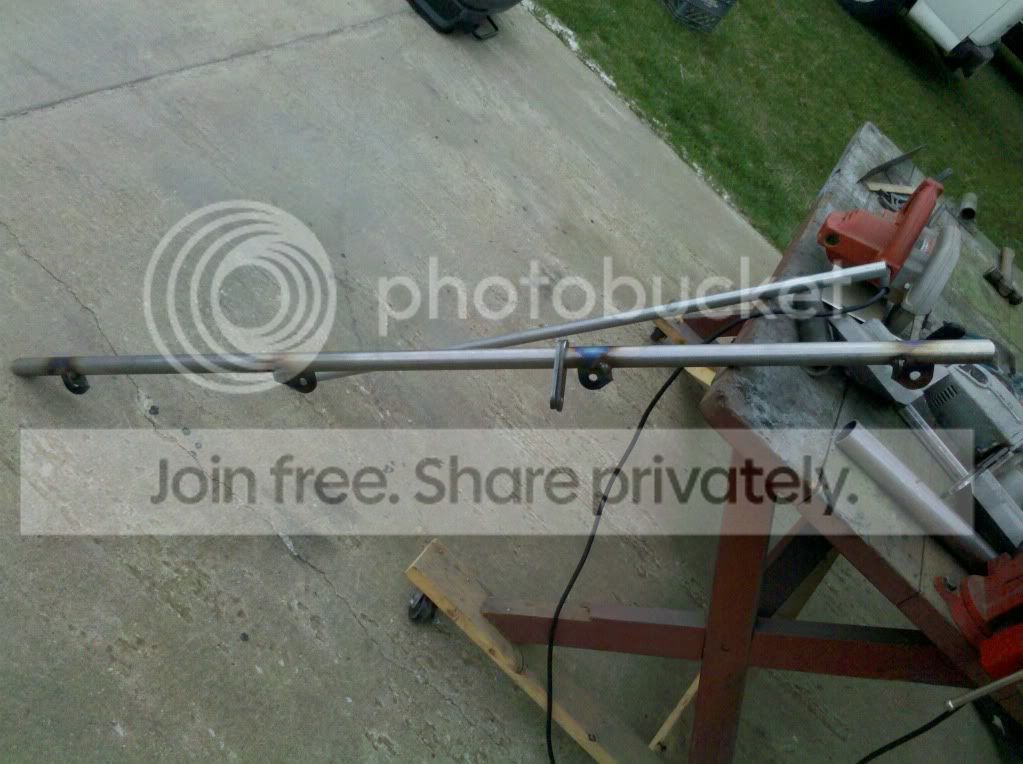

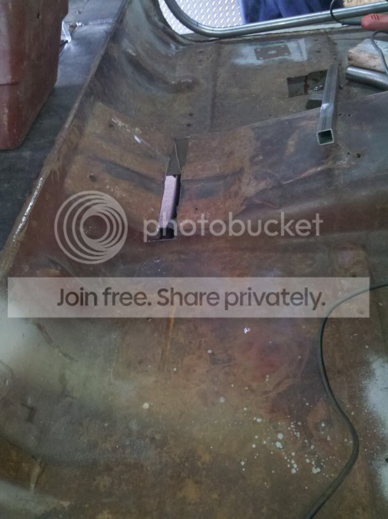

Eric finish welding in the rear bars, we had to use a tie down strap to pull in the sides of the box, as its drooping some, and was an 1.5", so we tied in some plates to the rear bars to strengthen them up.
The last of the frame tie in links:
Dave and I did alot of thinking today and measuring, meeting the front halo with the rear bars in the right place put them way to low,if all the stars and planets align tommorow we still may get the cage finished up, its pretty close.
Also dave put down some very nice welds today so no more welding for me!:D
I actually thought the same thing after I had them all in and was looking everything over. This was my first rodeo on cage ties, I knew they were there to alow the body to come off. So I oriented them that way to lift it straight up. They should be fine though. Its better than having none at all, and with any luck he wont roll to need them:) The front ones are the only ones that dont seem strong enough. but the shock hoops will be tied to the engine compartment bars right on the other side of the fire wall, so that should stiffen it all up and prevent the front ties from taking all the load.
I also plan on making an anti rotation plate on the front cage tie ins, it will be a flat plate that goes from the flat part of the body mount to the tube so that when pushed down it will not rotate around the bushings

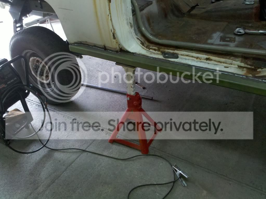

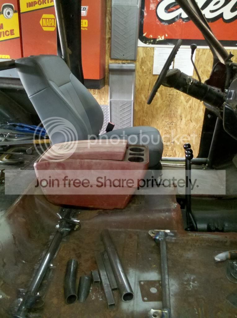

We got the tubing for the front seats mounting pretty well set today, I'm liking the turnout of the seating position, and there comfy.
leveled up the truck before we started putting the bars in.
Lookin pretty comfy dave. To be honest I dont think i sat in the seats one time the whole day, I have no idea why lol. I guess Ill have to make another trip just to sit in it lol.
