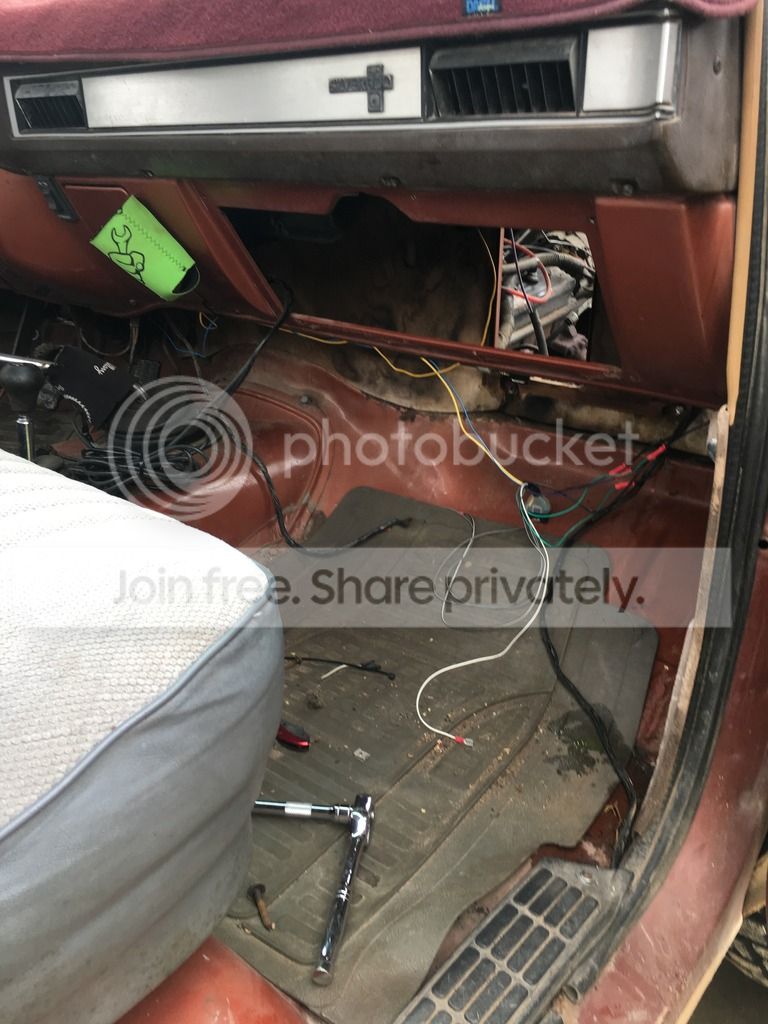

So yesterday I spent a little time cleaning up under the hood, which led to cleaning up under the dash. I'm starting to think that after the big block there will likely be a DIY dash ordered up to really clean up the dash.
Before
After
and i saved these...one was falling off and went ahead and popped the other loose.
I'll probably find a piece of diamond plate to fill the void and use the empty space to mount battery trays and get any future wiring cleaned up and organized.
