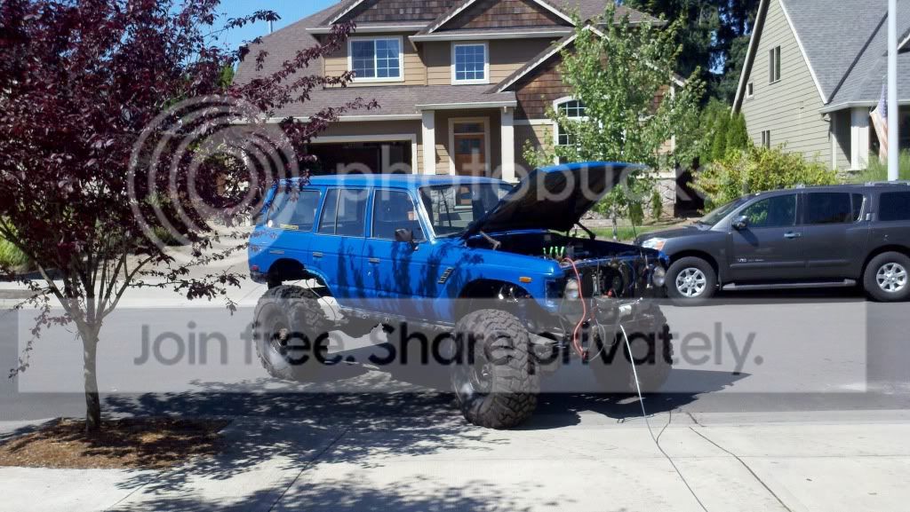

Apparently the wife was taking some action shots too.
Haha... I once used a very similar technique to get my cruiser out of the garage and then back in...
No shame in pulling cable in your driveway is there?
No shame IMO however several of my neighbors look at me like this when they drive by
I'm just glad I had the winch. At my old place I had to use a come-along for the drag car whenever it was broken :doah:
