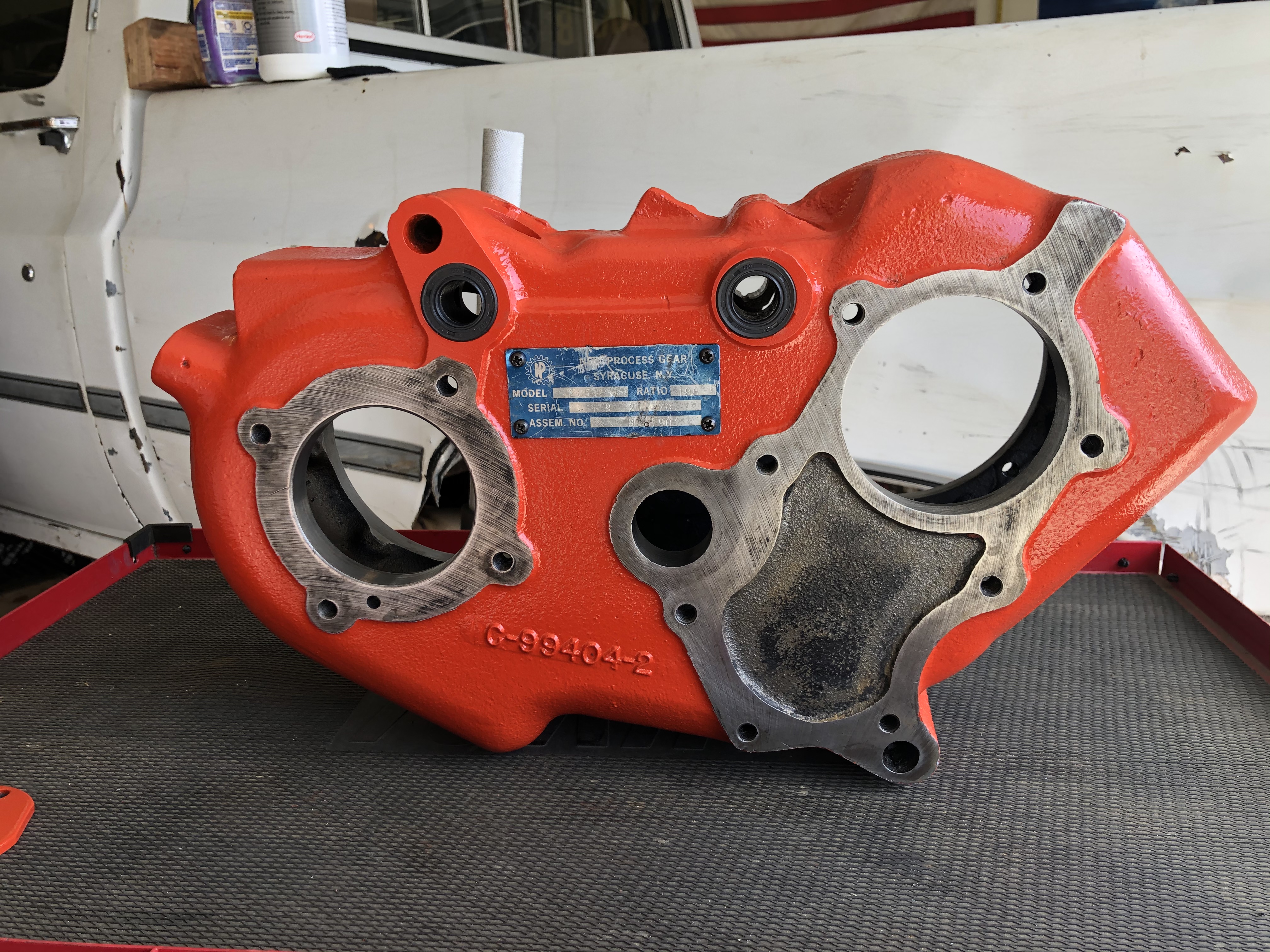

I forgot to mention that NWF recommended that I use a retaining compound for the input bearing in effort to keep it seated better. I should have all the parts and supplies to reassemble the case by mid next week.
I use that shit to hold helicopter transmissions together. It’s awesome. Make sure everything is really clean and use the 205 locktite primer. It comes apart with some heat and a press.

Still waiting on ORD to ship the 205 rebuild kit so I've been knocking out some other items.

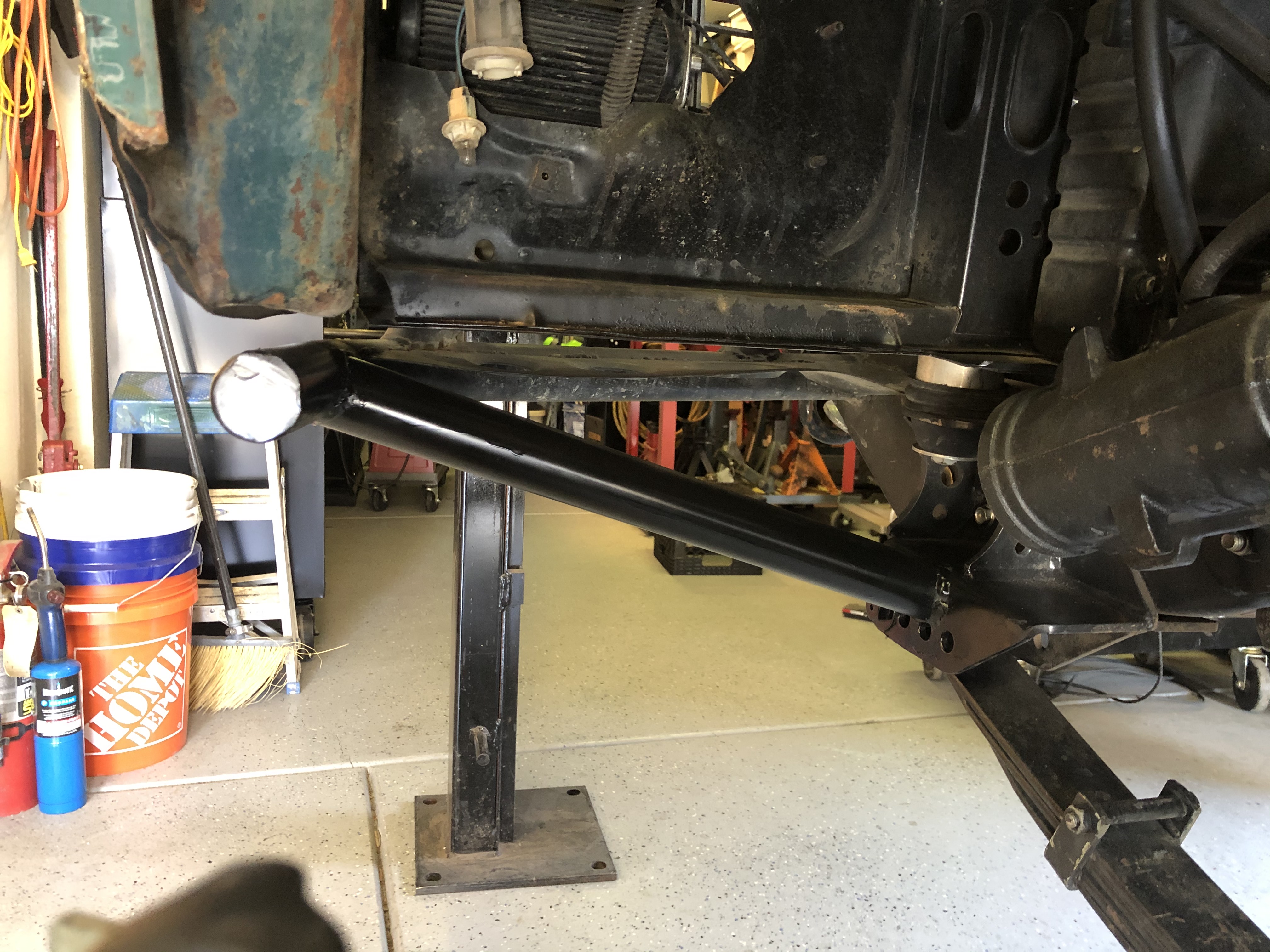

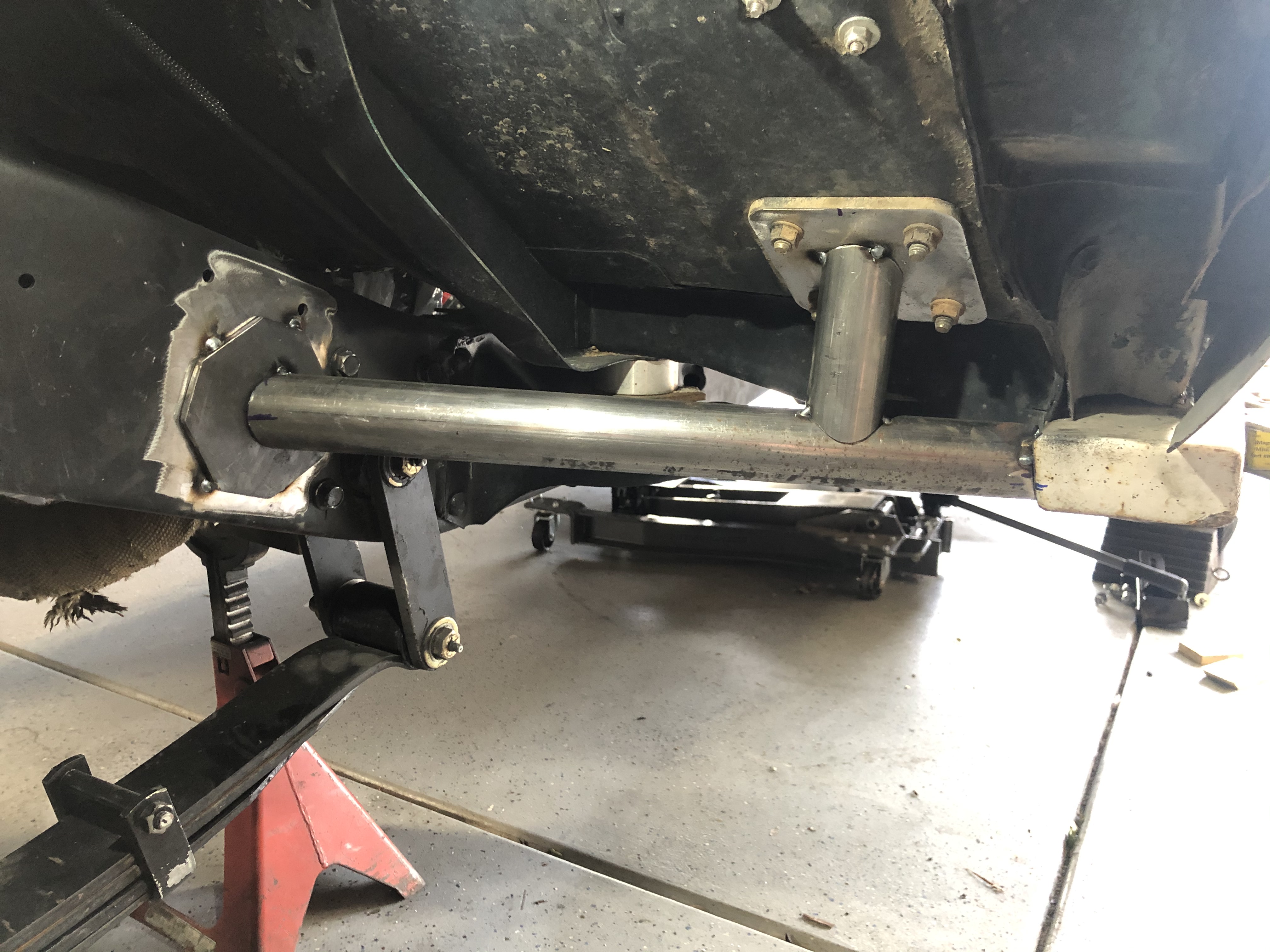

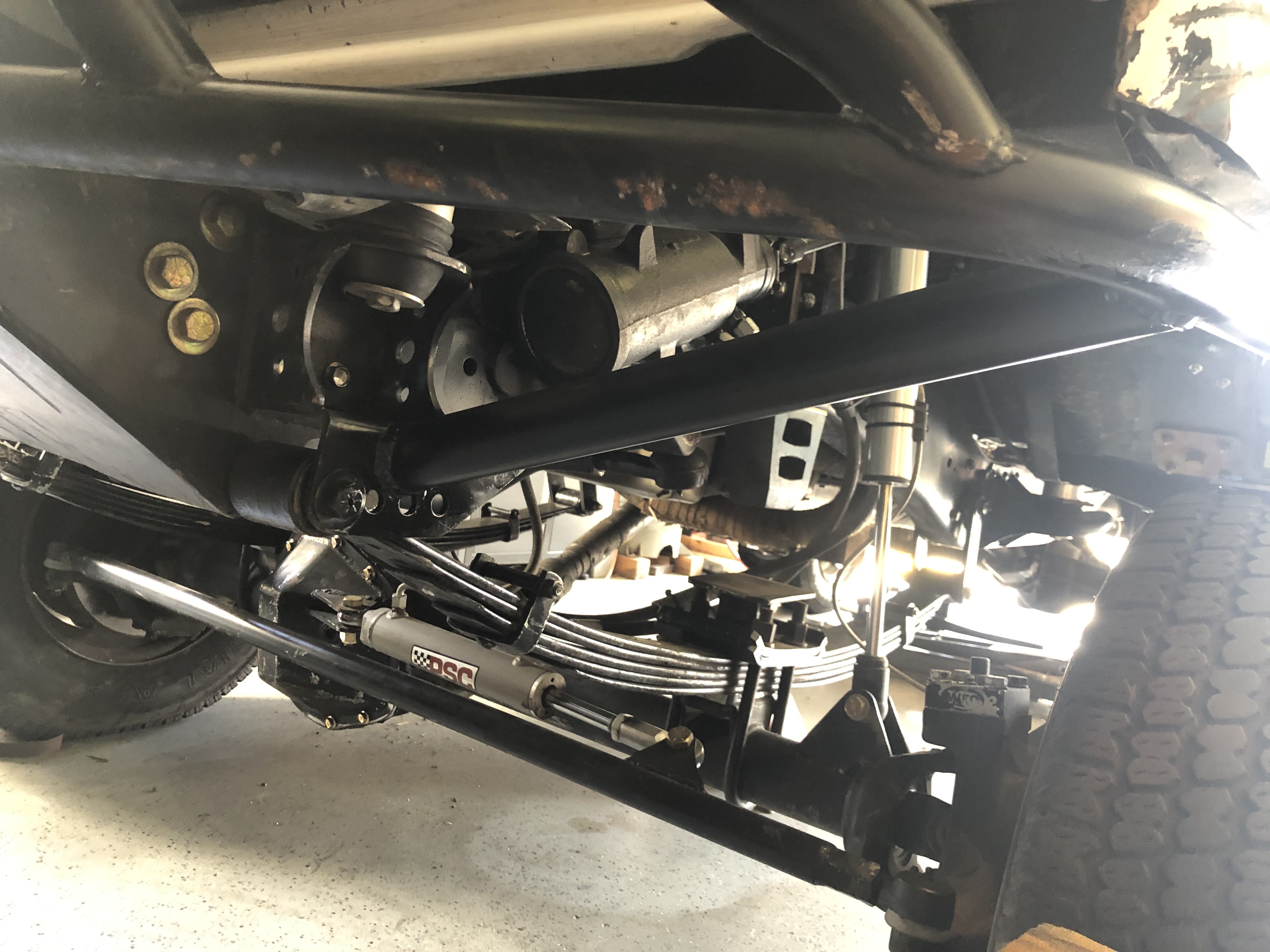

Another partially completed project was the bumper tie-in's that I started last fall when I fixed the passenger side. Now the drivers side is fixed and tube was added.

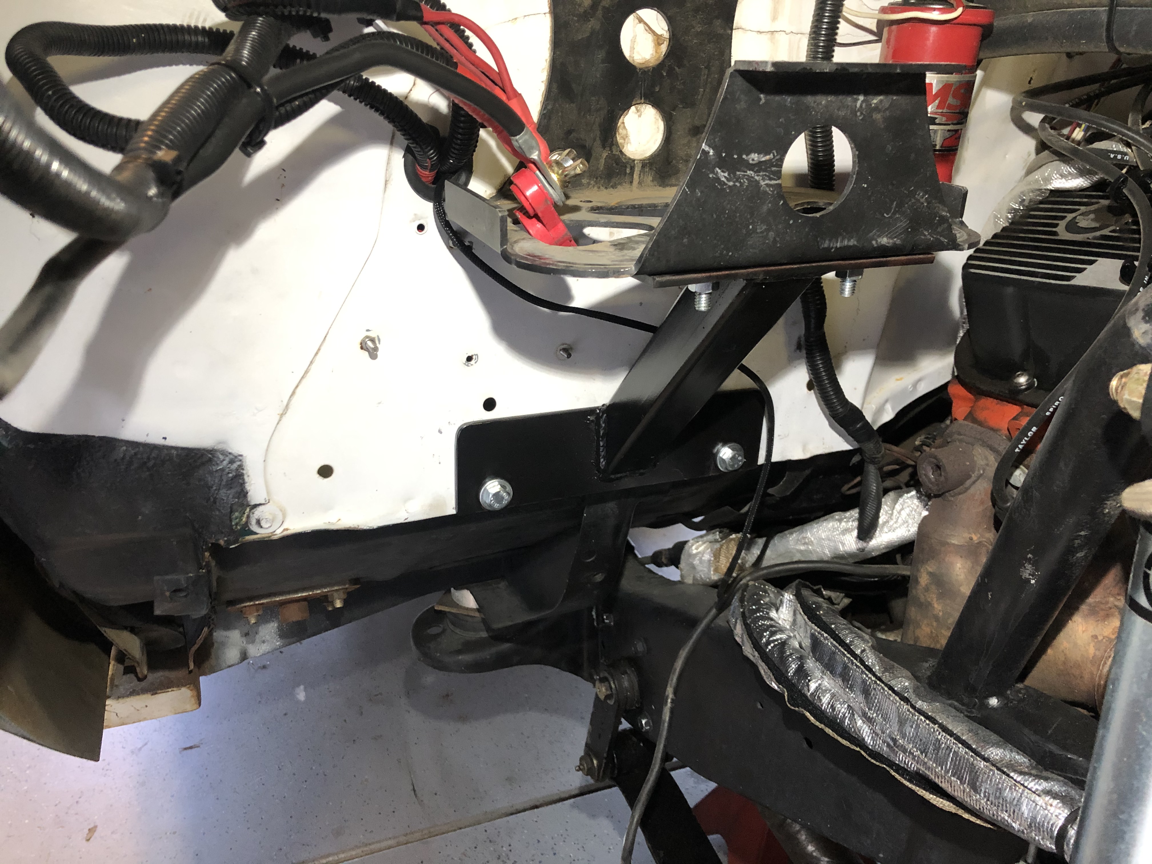

My battery box was mounted to the firewall using 4 bolts with fender washers however it began tearing the firewall last year during our father daughter fordyce trip in May. I added a ratchet strap for added support and ran it all year however it would still squeak sometimes and it needed a proper fix. After a few ideas were tossed around I decided to make a simple triangulated bracket that supported the bottom of the tray and could be easily removed with four bolts.
full
the bottom bolts & nuts are accessible from outside the cab through that pinch weld.
