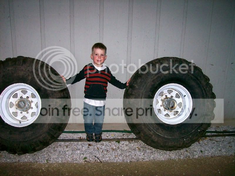

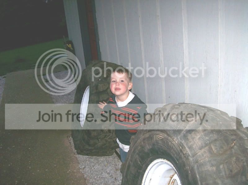

On a side note I had a nice craigslist score thursday night 4 39" swampers on 15x10 8 lug steelies for..........................
wait for it................................................
$125.00 :D:D:D
the only thing better then that was the look on Jake's face the next day when he saw them!!! He is still telling everyone "Daddy got gaint tires for my Blazer". Oh and I mean EVERYONE, the cashier at the wawa, the girl who cuts our hair, random people in the grocery store :haha:.
2 of the tires are in pretty good shape, the other 2 (ones in the pics) are about 1/2 tread. At the very least I've got a couple of great spares, and picking up these has helped make up my mind to run 40's. :D
I have gotten some other stuff done, I'll try to get some pics up soon.
