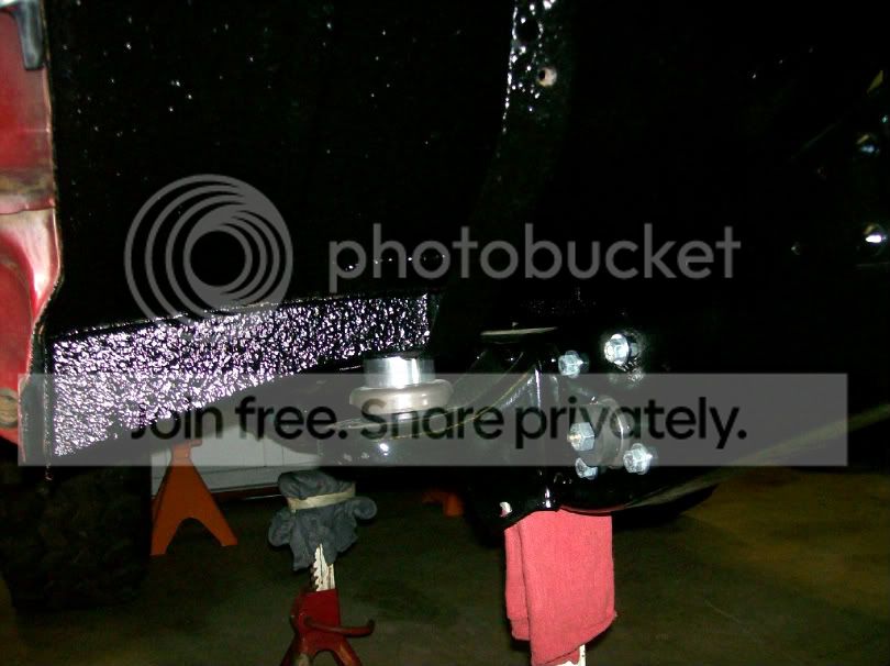

Prep time will really depend on what kind of condition it's in to start with. I had originally intended on just painting the underside so I had power washed and degreaed first then wire wheeled it and then used med. scotch brite pads by hand. When I decided to line it I re-preped it all with 36 grit paper by hand.
Spray time is short, doing the underside is tough, I can't wait to shoot the tub because it will be soo much easier. To spray out a full gallon only takes a few minutes, the longest part is the clean up and the pre-taping etc.
That being said I have a few tips for anyone thinking about shooting their underside; tyvek hooded suits and a GOOD resiperator are your best friends. I could not imagine sraying this stuff and not having a resirator, it is STRONG, when I do the underside of my dad's Willy's I am going to find some sort of goggles as well, I had safety glasses and a face sheild but the fumes were killing my eyes. Granted spraying the underside is the worst possible conditions to work in, the truck was completly taped/ masked off and then covered by plastic, so your are basicly working in a tent. One other tip, don't do it by your self :doah:, have someone else help you. It would have been alot easier if I had someone to mix the second batch while I was finishing up the first gallon or to hold the gun while I am trying to get into position under the truck or to keep you from bumping the trigger and lining the edge of your fridge and work bench :doah::doah::doah:. Also make sure you have plenty of solvent on hand for clean up, acetone and xylene both work great.

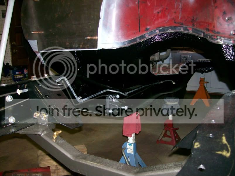

I have found time to put the frame back under the truck and will finish putting the suspension back in this week. I did actually pickup and start disassembling my 14 bolt on sunday and hopefully I will order up my gears and a detroit next week. :D

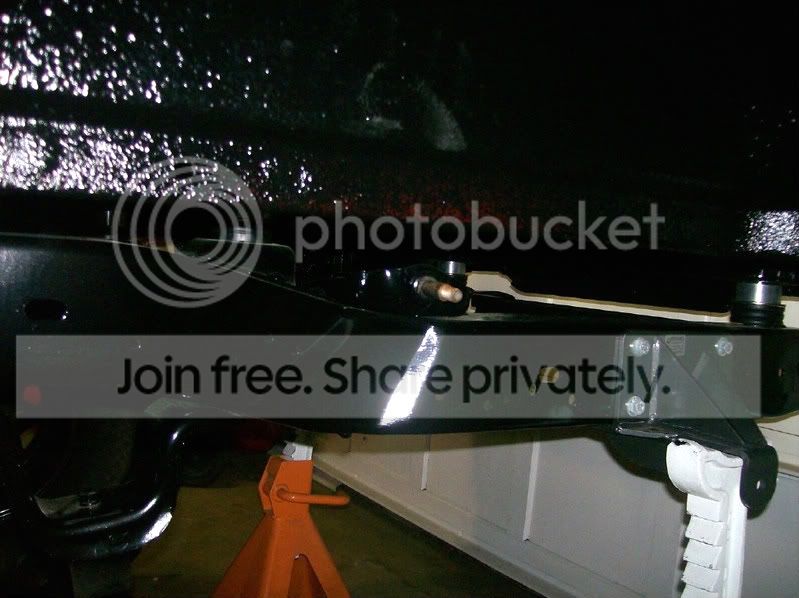

Well , I haven't gotten too much done lately , but I did have a few pics I hadn't posted of the frame back under the body, soo......

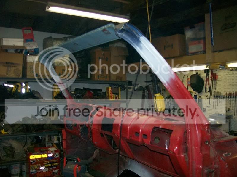

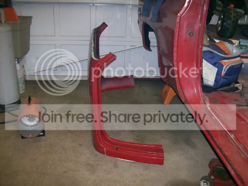

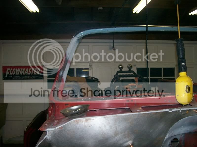

I now finally own a full vert (that's not a rust bucket) :woot::saweet: I cut the old top off this weekend and got 1 of the quater panels capped and the new old windsheild frame is in. I will post up some pics tonight, I'm just so happy I'm making progress again that I had to post ;)
I promised pics, so.................................

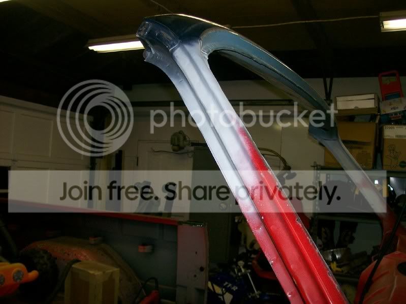

Say goodbye to the old top :D
and hello to FULL CONVERTIBLE :saweet: :cool:

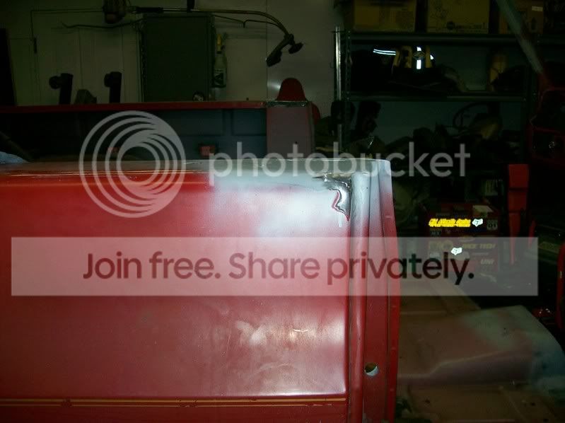

I have one bed side welded , still have alot of finish work to do but it's on its way

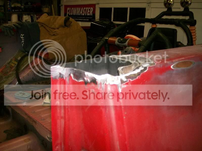

and the other side I still have to do
