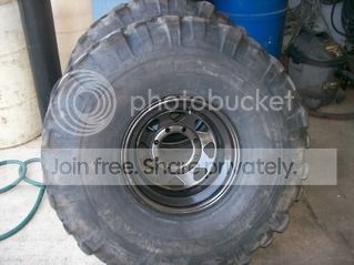

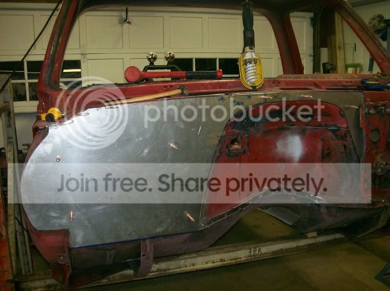

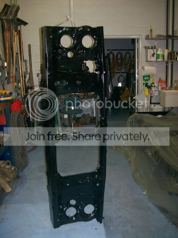

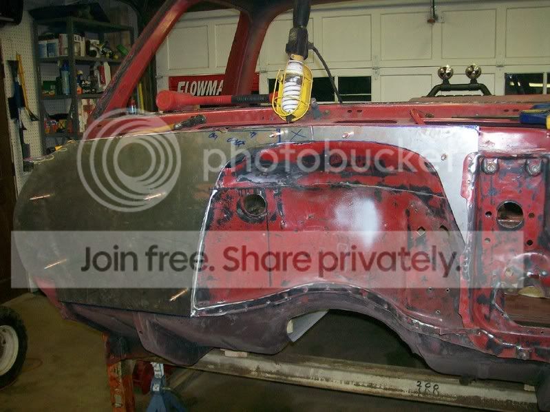

Well a few little updates, I have my firewall mocked up, just need to weld it in. I also finished up my core support, and cleaned/ painted my pedal assembly. Cleaned and painted my $125 swampers, Jake is all about "his giant tires" :D

Firewall mocked up

Core support all nice and pretty :laugh:

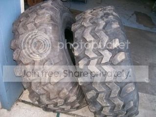

2 of my My cheapy swampers , sometimes I love craigslist :D

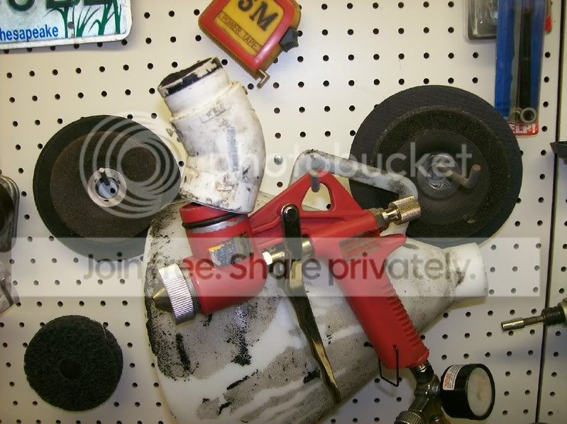

I dont forsee any issues, I did "mod" the gun a bit :D. I made a little elbow to keep the hopper pointed up more when I am spraying from underneath. I'll post up some pics of it and the results this weekend, and I'll send you some before and after shots as well.
How did you make that elbow? I was thinking of creating something like that, I've had a few customers ask me if I had anything like that.
That is an awesome idea, it'll make spraying under there a heck of a lot easier!
I just used a 1 1/4" (IIRC) pvc elbow from home depot , it fits perfectly over the inlet on the gun and I used a reducer/adapter inside of the elbow for the hopper to clamp on to (same outside diameter as the gun inlet). I think it cost me like $2.oo to make it and a few minutes to assemble/ glue and test fit.

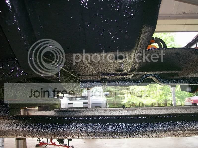

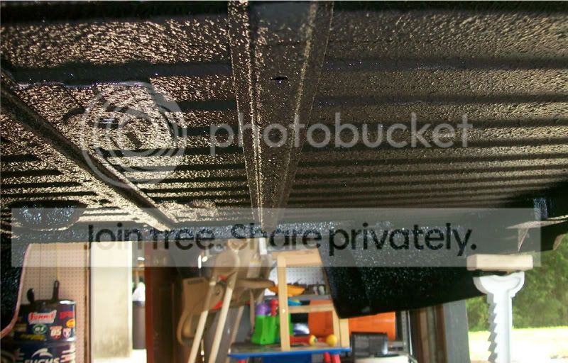

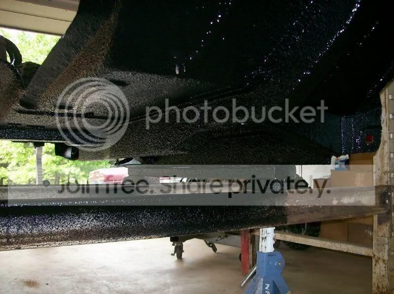

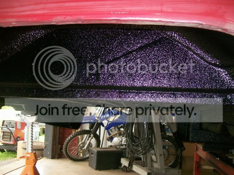

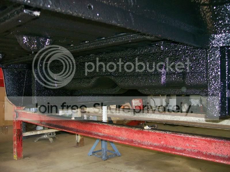

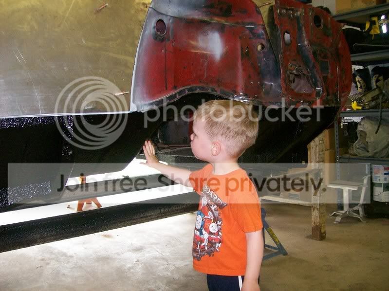

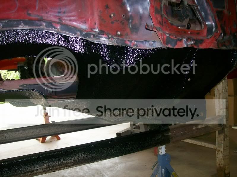

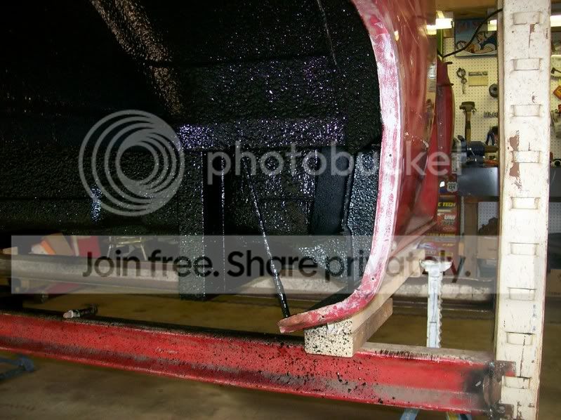

Well it's all done, the underside is now coated in Al's black spray on liner, first off let me thank Bryan (Blaze) for all his help and recomendations and for selling what I am convinced is the best DIY liner kit on the market :bow:. Honestly I did alot of research on liner kits and have personally helped apply or have used most all of the other ones out there and I am very happy with my decision to try Al's.
I will go into more detail about any tips and hints later, I had a 12 hour shift today and tomorrow is going to be longer so I have got to get some sleep.
But I won't go with out some pic whoring :D:D
This is the 45* elbow is used on the hopper :waytogo:

And he did a FANTASTIC job with the undercoating! :bow:
