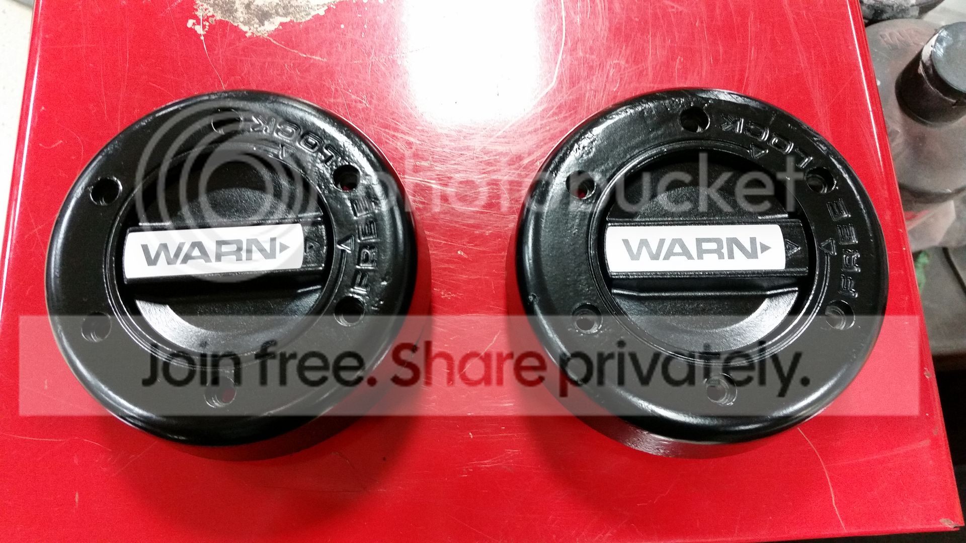

Sand blasted and painted the dials.

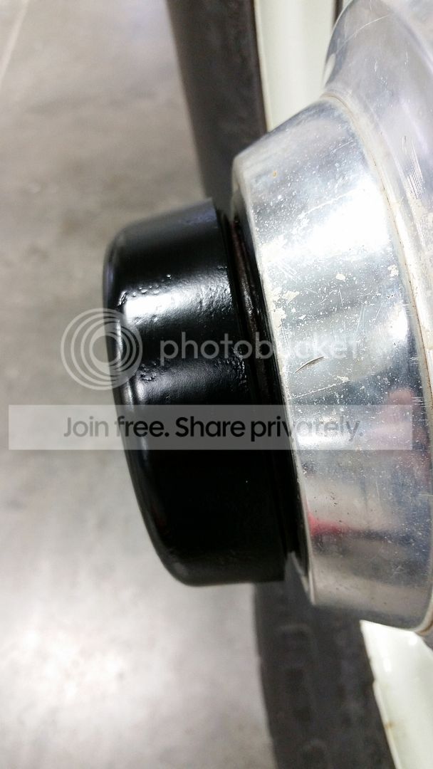

About an 1/8th inch from sitting flush on the hub. @skunked Did you have these on your axle?
I'm not sure if I'm missing something or these aren't Dana 60 lockouts? The body of the lockout is up against the spindle and everything seems to be installed correctly.

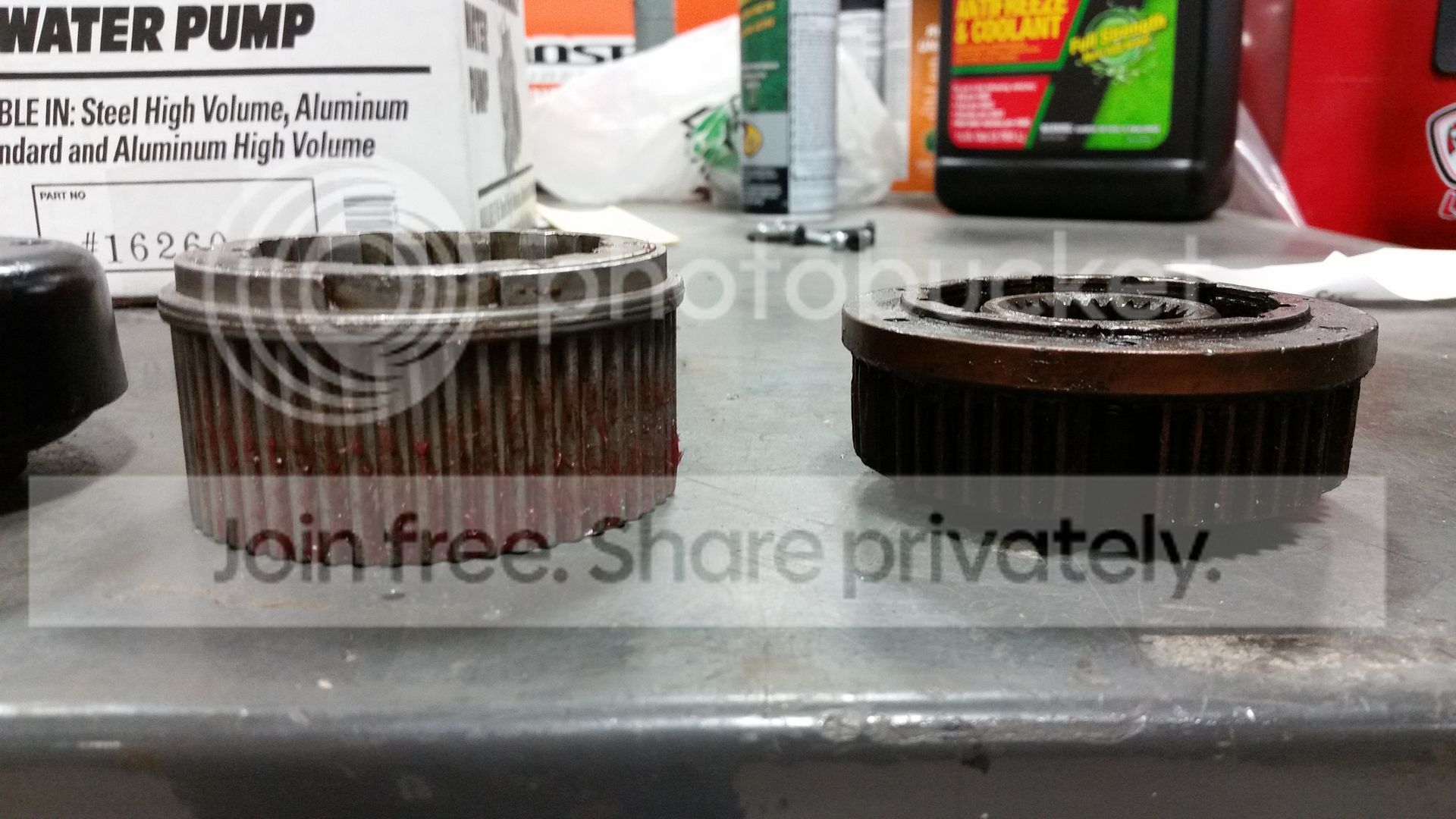

Here is the old crappy Mile Marker hub next to the Warn.

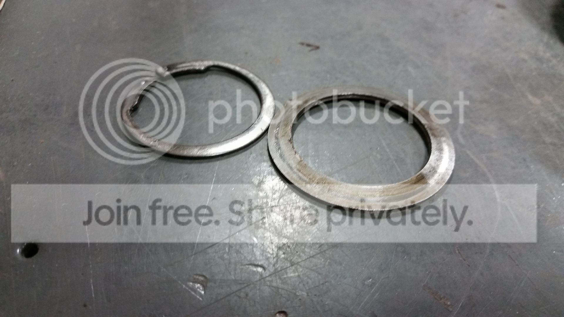

I took these out. I believe they're from the old lockouts. Not sure why I'd need a lock ring in front of and behind the lockout. And I don't think this washer is factory. It was up against the spindle.
It's too bad they don't work. Looks good.

Hard to see for sure in the pic but is the o-ring hanging up? That's all I can think of.
No, the O ring isn't touching the hub like it's supposed to. The outer lockout piece with the dial is screwed onto the lockout body and sitting flush on it. The lockout body is sitting up against the spindle. Only thing I can think of is they're not the correct lockouts.

Wait!!! After re-reading your post... Is there a snap ring behind the splines where the screwdriver is pointing? If there is that's the problem. May have worked with the milemarker hubs but not the warns.

And nice job on the restoration of those lockouts

Is the big ring you lock the hub lock into the hub with in?

When you push the aluminum hub-lock insert into the hub, are you able to get the large (3.5") retaining ring in?
