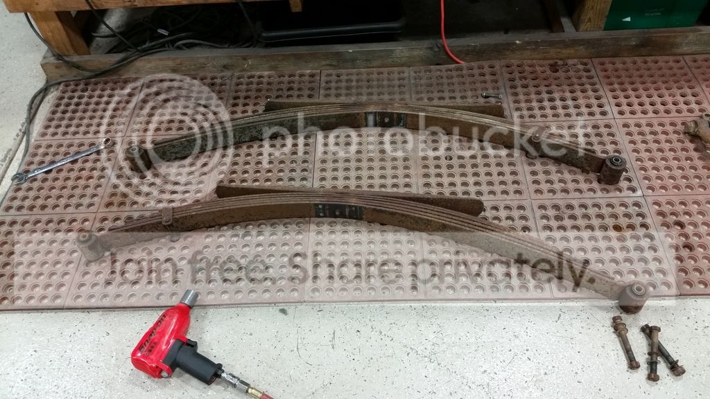

82355 1 ton status Premium GMOTM Winner Joined Feb 4, 2009 Posts 17,242 Reaction score 7,913 Location Bradish Nebraska Jan 31, 2016 #164 Are they 52" springs? They look offset. Martin
82355 1 ton status Premium GMOTM Winner Joined Feb 4, 2009 Posts 17,242 Reaction score 7,913 Location Bradish Nebraska Jan 31, 2016 #165 Going to do a 1" body lift while you have it apart? Martin
78SWB Money Pit Premium GMOTM Winner Joined Jan 25, 2012 Posts 2,914 Reaction score 3,660 Location Lincoln, Nebraska Jan 31, 2016 #166 I guess I'm not sure. I thought all rear 1/2 ton springs were 52's? I don't know, I might do a body lift. We'll see. Trying to save money.
82355 1 ton status Premium GMOTM Winner Joined Feb 4, 2009 Posts 17,242 Reaction score 7,913 Location Bradish Nebraska Jan 31, 2016 #167 I understand stand that. Measure the springs, that will tell you. People have ran 56" springs up front too. Martin
78SWB Money Pit Premium GMOTM Winner Joined Jan 25, 2012 Posts 2,914 Reaction score 3,660 Location Lincoln, Nebraska Jan 31, 2016 #168 They're 56's. Dammit. Maybe I should just put these on the rear.
82355 1 ton status Premium GMOTM Winner Joined Feb 4, 2009 Posts 17,242 Reaction score 7,913 Location Bradish Nebraska Jan 31, 2016 #169 A 1" body lift is relatively cheap, and all new hardware is nice. http://www.offroaddesign.com/catalog/oneinchlift.htm Martin
82355 1 ton status Premium GMOTM Winner Joined Feb 4, 2009 Posts 17,242 Reaction score 7,913 Location Bradish Nebraska Jan 31, 2016 #170 78SWB said: They're 56's. Dammit. Maybe I should just put these on the rear. Click to expand... I thought they looked offset. You could probably run them on the front, with the long side back, and then not have to mdo be your FUSH's? Martin
GWeakland620 THE CK5 Crayon Eater Premium GMOTM Winner Joined Sep 15, 2010 Posts 16,477 Reaction score 19,054 Location Toe-peek-ugh, KS Jan 31, 2016 #171 Screw it, just run 63's up front.
skunked phat block everything Premium GMOTM Winner Joined Feb 27, 2013 Posts 19,112 Reaction score 26,626 Location Placer County CA Jan 31, 2016 #172 82355 said: I thought they looked offset. You could probably run them on the front, with the long side back, and then not have to mdo be your FUSH's? Martin Click to expand... That's the way my 52's are setup. Kinda screws with your caster angle so you'll need some shims.

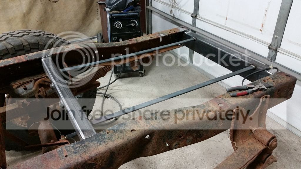

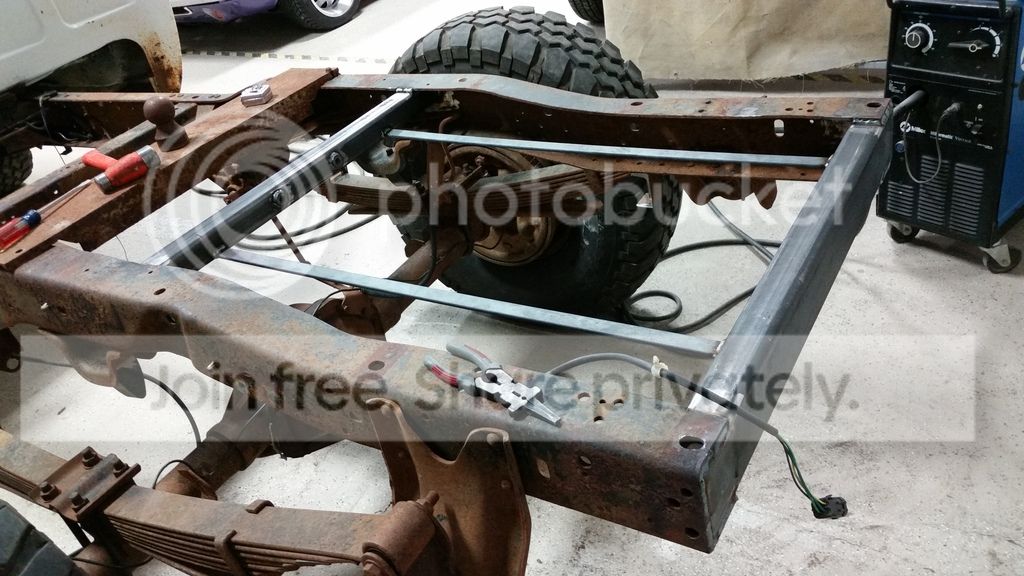

78SWB Money Pit Premium GMOTM Winner Joined Jan 25, 2012 Posts 2,914 Reaction score 3,660 Location Lincoln, Nebraska Jan 31, 2016 #173 Got a little more done today. Don't laugh at my welds. It's been 3 years since I was welding regularly.
80' 427 1/2 ton status Premium Joined Nov 14, 2006 Posts 4,403 Reaction score 1,315 Location NEBRASKA Jan 31, 2016 #174 I guess you are never bobbing the bed then
78SWB Money Pit Premium GMOTM Winner Joined Jan 25, 2012 Posts 2,914 Reaction score 3,660 Location Lincoln, Nebraska Jan 31, 2016 #175 Not in the near future.
80' 427 1/2 ton status Premium Joined Nov 14, 2006 Posts 4,403 Reaction score 1,315 Location NEBRASKA Jan 31, 2016 #176 Because most cut the frame off behind the spring hangers
78SWB Money Pit Premium GMOTM Winner Joined Jan 25, 2012 Posts 2,914 Reaction score 3,660 Location Lincoln, Nebraska Jan 31, 2016 #177 Yeah I know. I thought about and decided not to do it right now.
78SWB Money Pit Premium GMOTM Winner Joined Jan 25, 2012 Posts 2,914 Reaction score 3,660 Location Lincoln, Nebraska Jan 31, 2016 #178 There's not a ton of frame to take off with the K5 tank back there anyway.
