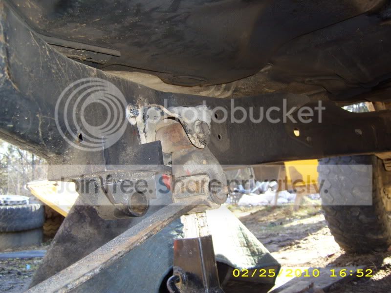

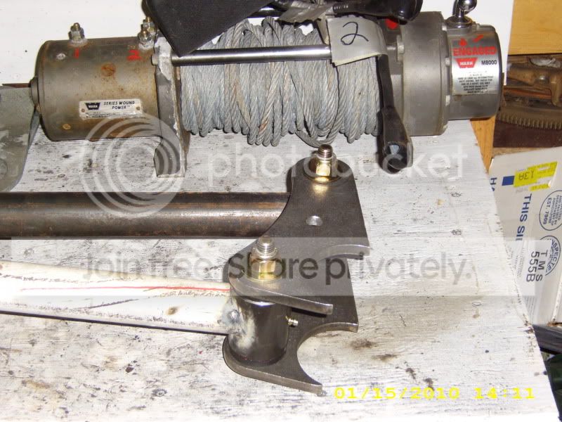

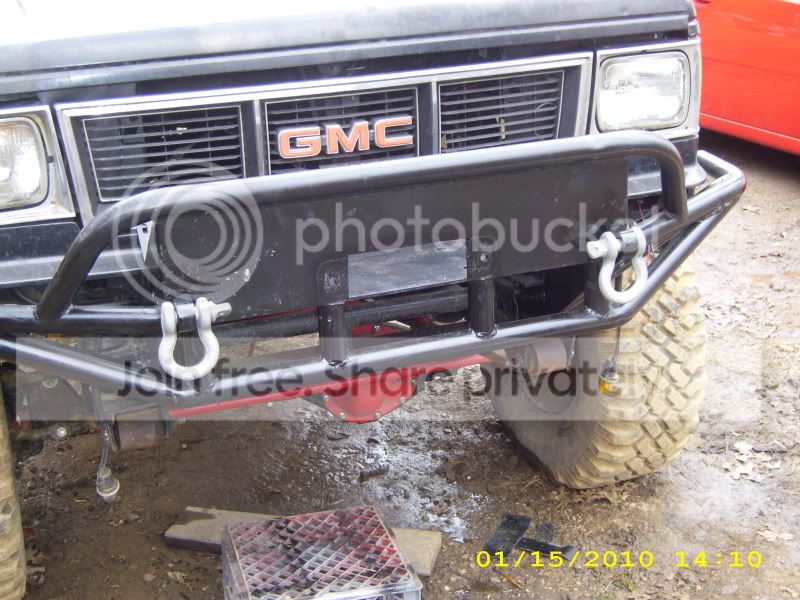

made some progress. My girlfriend got me some shackles for christmas. Then i had Kert make me up some shackle mounts. Done some trading with Kert to get the traction bar brackets and bushings. Heres a few pics.

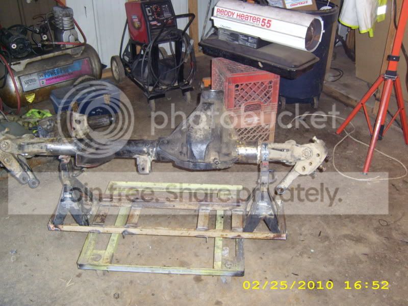

I like it when solid axles find their way under the little Blazers.
This was my 89 with D30/D35, Toyota 4" front springs under and stock S-10 rear springs over, 33s on stock steelies, 1.5" wheel spacers.

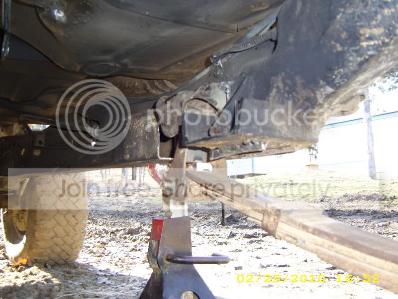

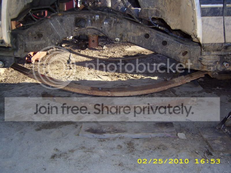

A little update. Decided to change the front suspension around. Figured it is easier while the motor and tranny were out. Running fullsize Dodge rear springs. This allows to have the shackle mounted inside the frame. had to notch the driver side frame rail a little bit. Also going to change the gears in the front end to match the rear while it is out. Still need to go get the other spring.
