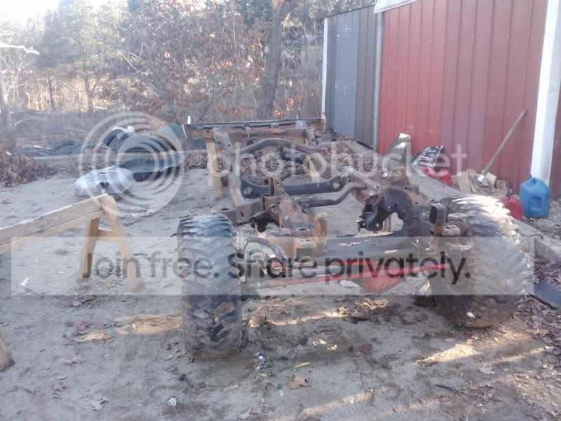

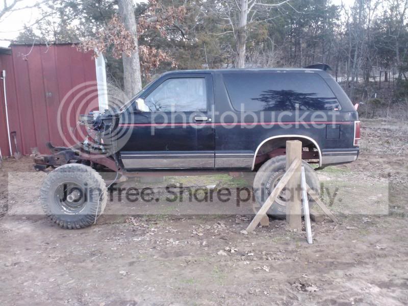

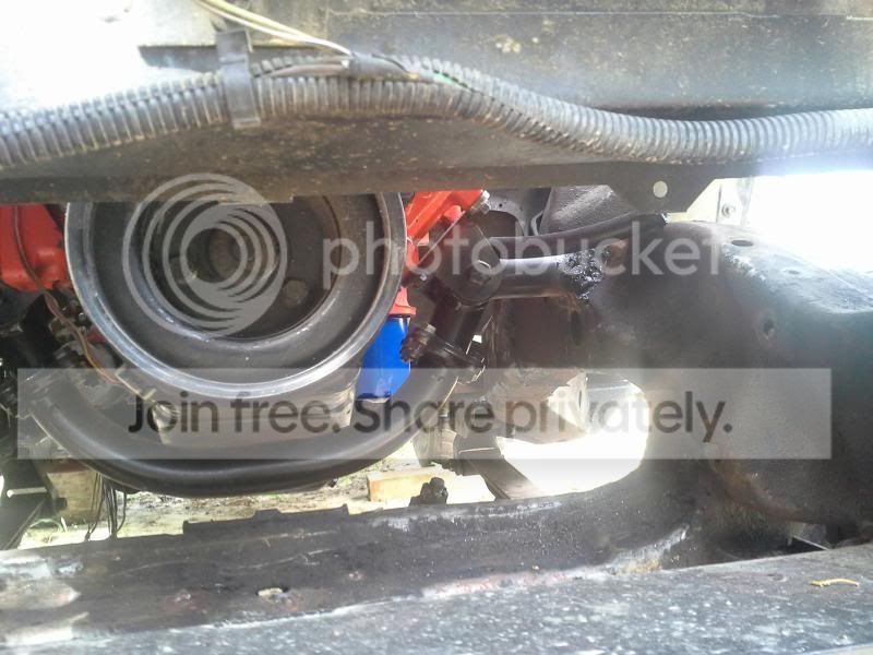

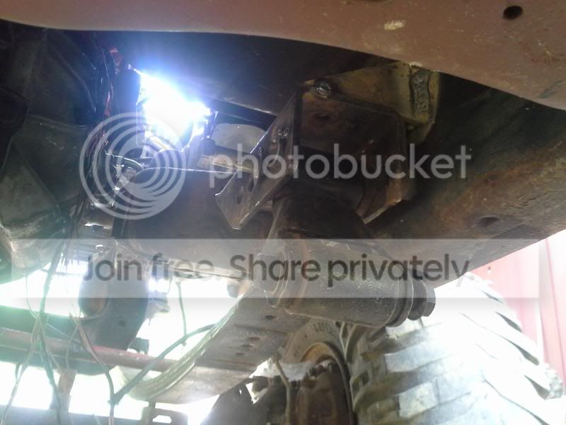

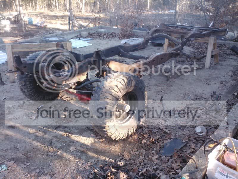

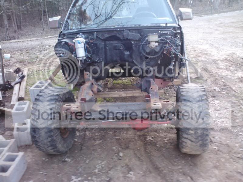

Got the frame swaped out... Still need to make the front shackle hangers, and lower the motor and tranny some... Trying to make it where I dont have to have a body lift to clear the tranny...

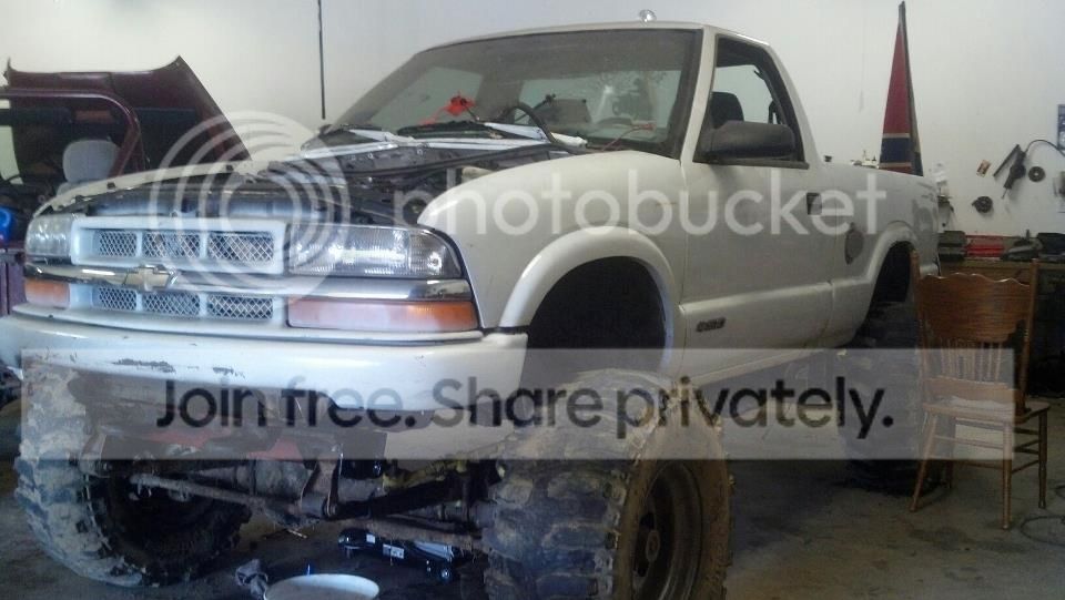

I have a friend buidling one right now. It was a 2wd truck and right now it has 3/4 ton axles under it. I'll see if I can get pics here shortly.
Not sure why he decided to put the shackles up front but it's coming together pretty quick actually.

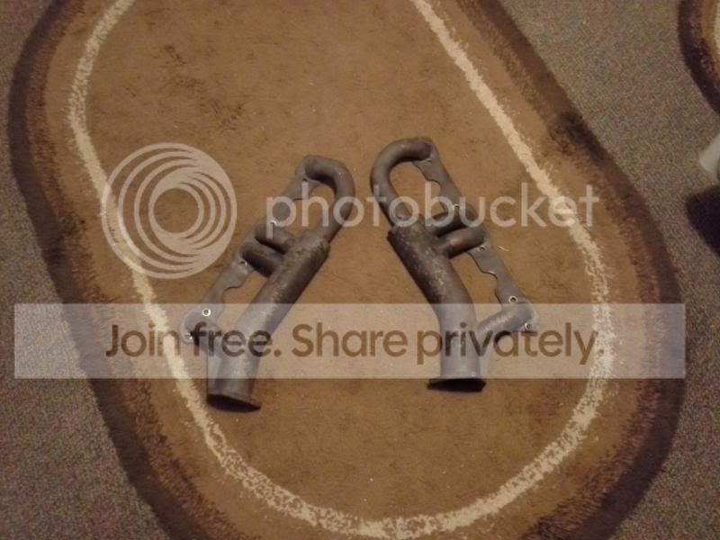

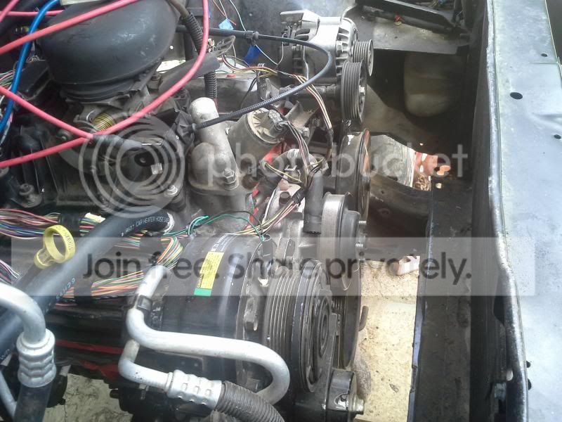

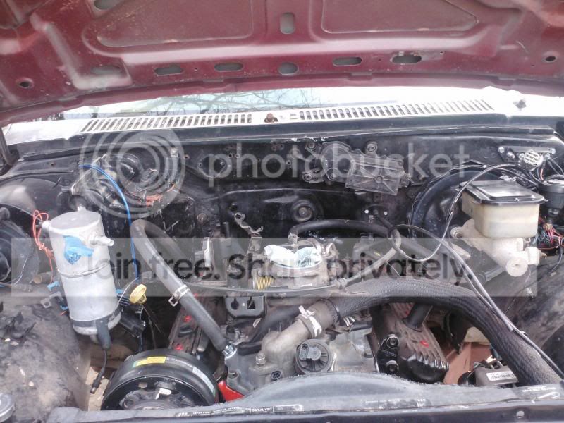

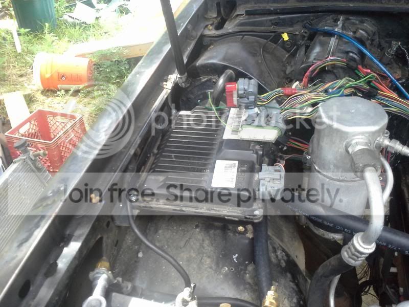

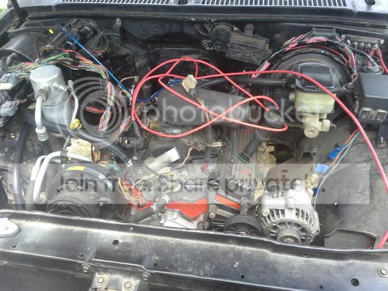

Making more progress.... Had Kert modify a first gen fullsize Blazer engine crossmember to fit for me...Finally found a set of headers that fit perfect off ebay... Wiring is all done....
Had it started the other day for a sec... Now to just get the fuel lines finished up.... Finish welding shackle hangers up front... Waiting on a new clutch fork...

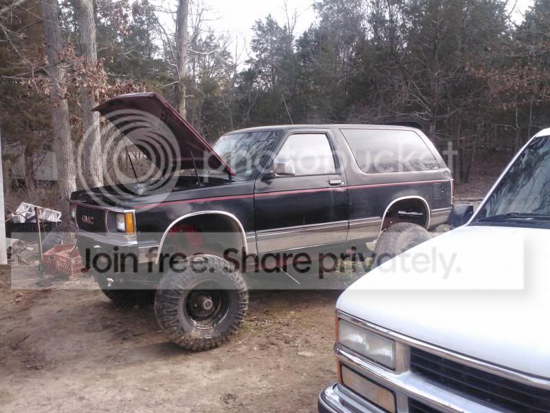

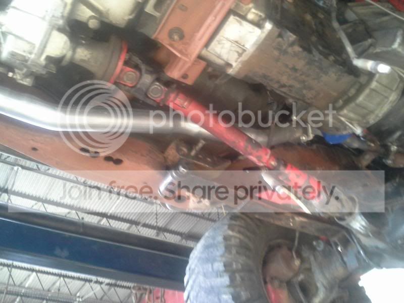

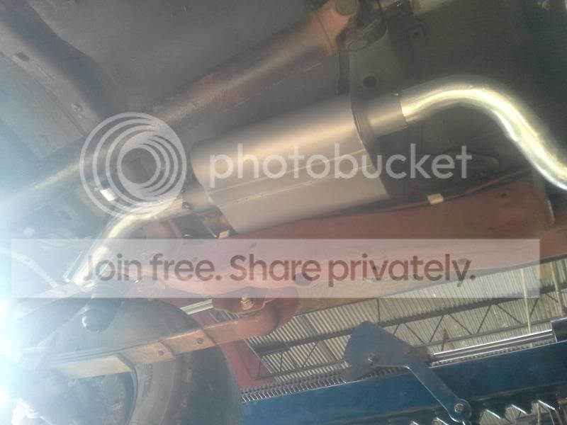

Got the beast running... Had the exhaust put on it last Friday... Went with knockoff flowmasters... Got a matching set of 4.30 gears and posi unit for the front axle...

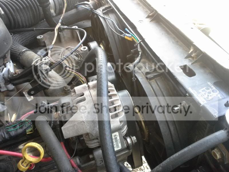

Put the updated spider injector in it.. Got the fans all mounted, and wired up... Been driving it a little bit... May need to add a trac bar on the front... Seems the font end pushes before it turns..

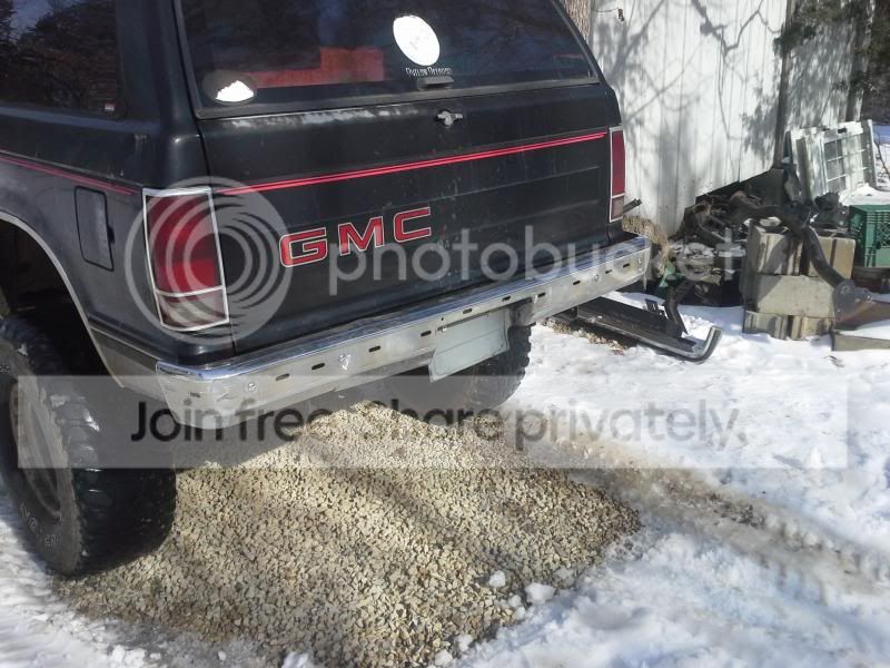

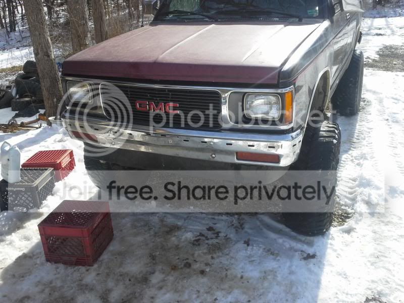

So far its all coming together and my hard work is paying off... Going to call about insurance one day this week...
Still have to find a decent set of tires for it before I start driving it much more...

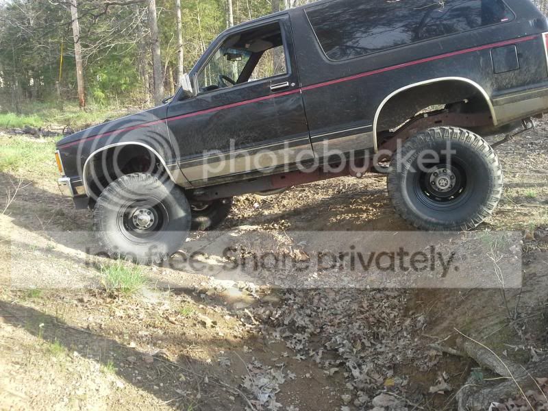

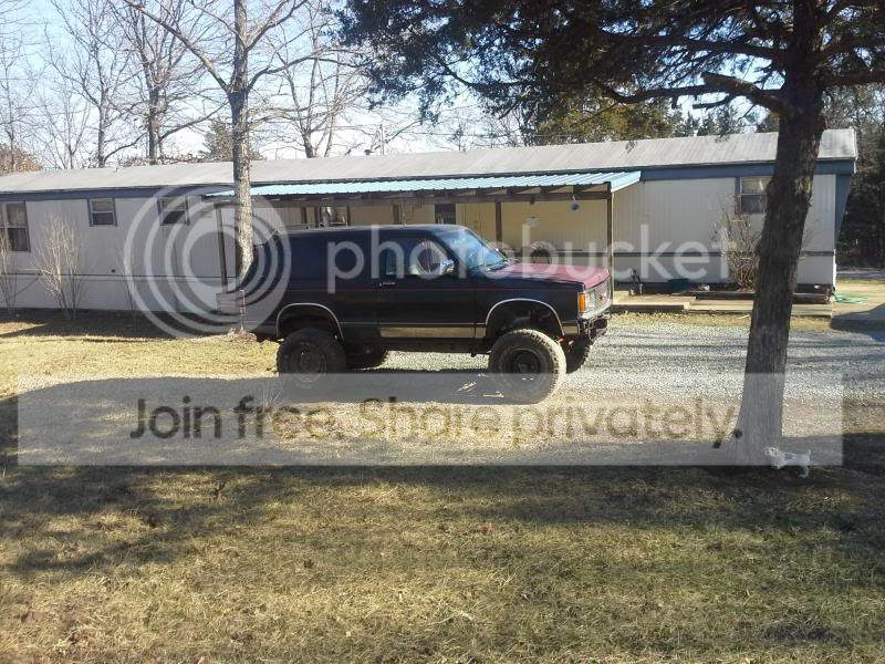

Update.. Shes all legal and Ive been driving it lately.. Does good... Need to correct rear pinion angle.. Seems to flex pretty good for leaf springs... Everything clears with plenty of room..
