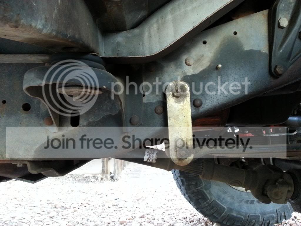

Here's a pic of my buddy's K30:
And the 2wd frame
You will notice the frame is kind of tapered for spring clearance on the 4wd. Because the 2wd doesn't have that, mine ended up lower.

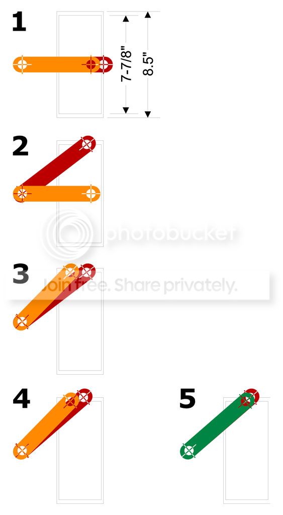

I also did some measuring and figured out I need a steering arm that is 6" center to center between the holes. I was hoping it was going to be an easy find like a TJ/YJ arm but they are 5.5" and that won't allow my steering to fully cycle.
I actually graphed it out on my computer. In the drawing below the red "pitman" is the 6.5" that I have now. The orange "pitman" is a 5.5" TJ/YJ arm. The very bottom right pitman would be 6". I know from measuring the steering box's full throw with the 6.5" pitman arm is 8.5". The actual throw that I require is 7-7/8". In the drawing those 2 distances are represented by black wireframe boxes.
  • #1 is static on both pitmans.
  • #2 shows the 6.5" pitman I have now at it's full travel for my requirements.
  • #3 shows where the 5.5" pitman would be for the full travel on my axle.
  • #4 shows the steering box limit with the 6.5" pitman.
  • #5 shows where a 6" pitman would be.
With the 5.5" pitman further than the 6.5" pitman can possibly go (as shown in #4) I know the 5.5" won't work. #5 shows me 6" would be perfect.

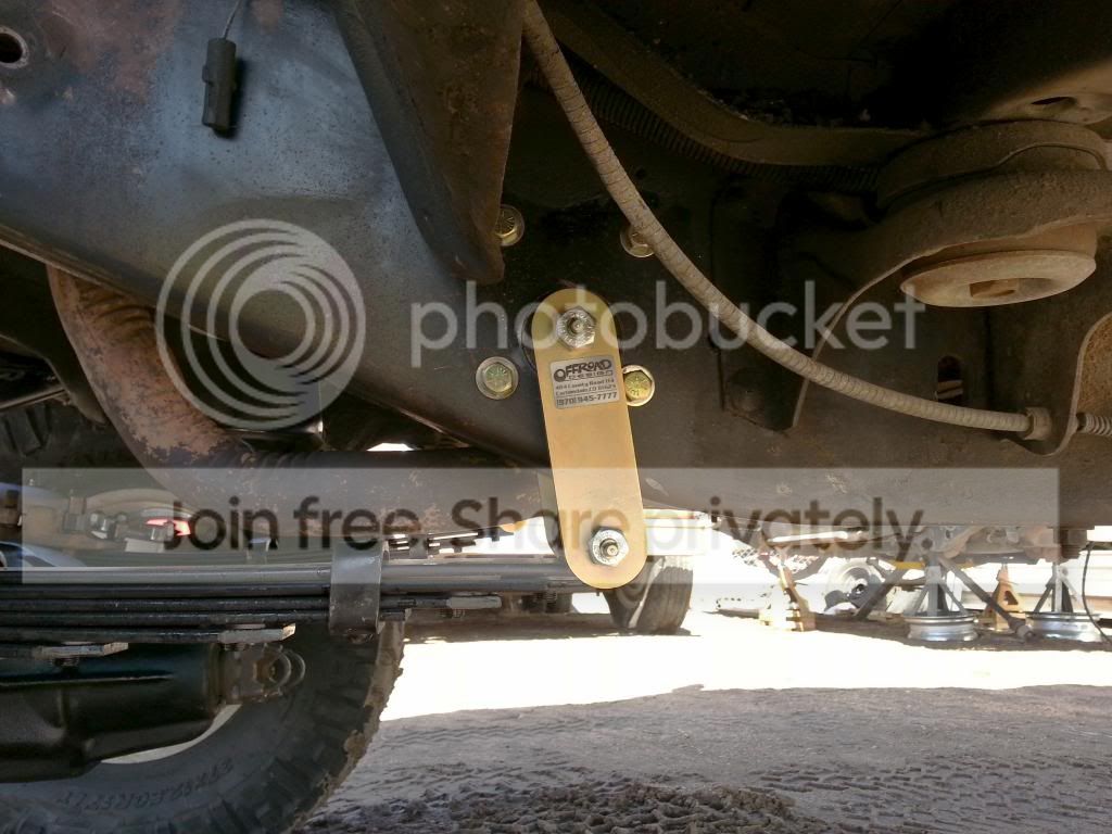

Haven't posted an update in awhile. Spent the last 2 weekends working on the front shock mounts. Taking a little longer because I'm learning the tube bender at the same time. Didn't get pictures after this weekend's work, but this is what I had at the end of last weekend.
I also had to put taller blocks in the rear to offset the lift I added to the front by dropping the front hangers down. I've got a total of 9.5" of lift in the rear. Front is about 5.5". In the future when I get around to dropping the rear spring hangers to eliminate the need for the blocks, I'm going to have to play around with how to do it. I think I may end up with a 2.5" shackle flip and moving the front hanger down 1 to 2 inches. I think that will work out right with the 4" rear lift springs I have. It sure gets confusing with these rear hangers being 3" higher up on the frame.
