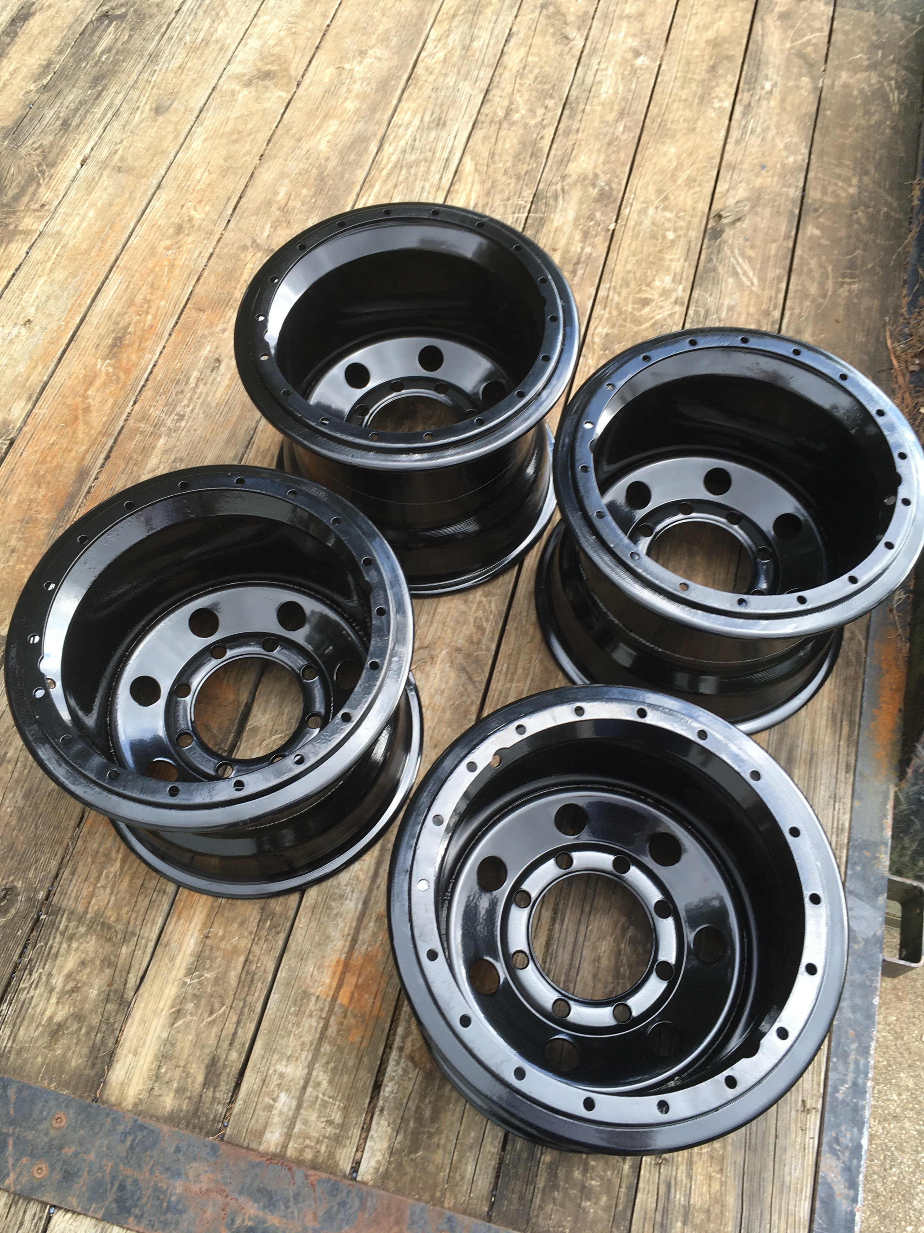

I bought some Trailready beadlocks from @fourwheelerjeff and @83ChevyK5Blazer was nice enough to pick them up on his move from Wyoming to Mississippi (thank you both!). The wheels were in good shape with minor surface rust, since I made good money on the sale of my Weld wheels I had them stripped and powder coated. The irony here is that I generally really do not like black wheels (Imo, overplayed) and I had the opportunity to change colors but I stayed with black to eventually match the bumpers, cage, etc..

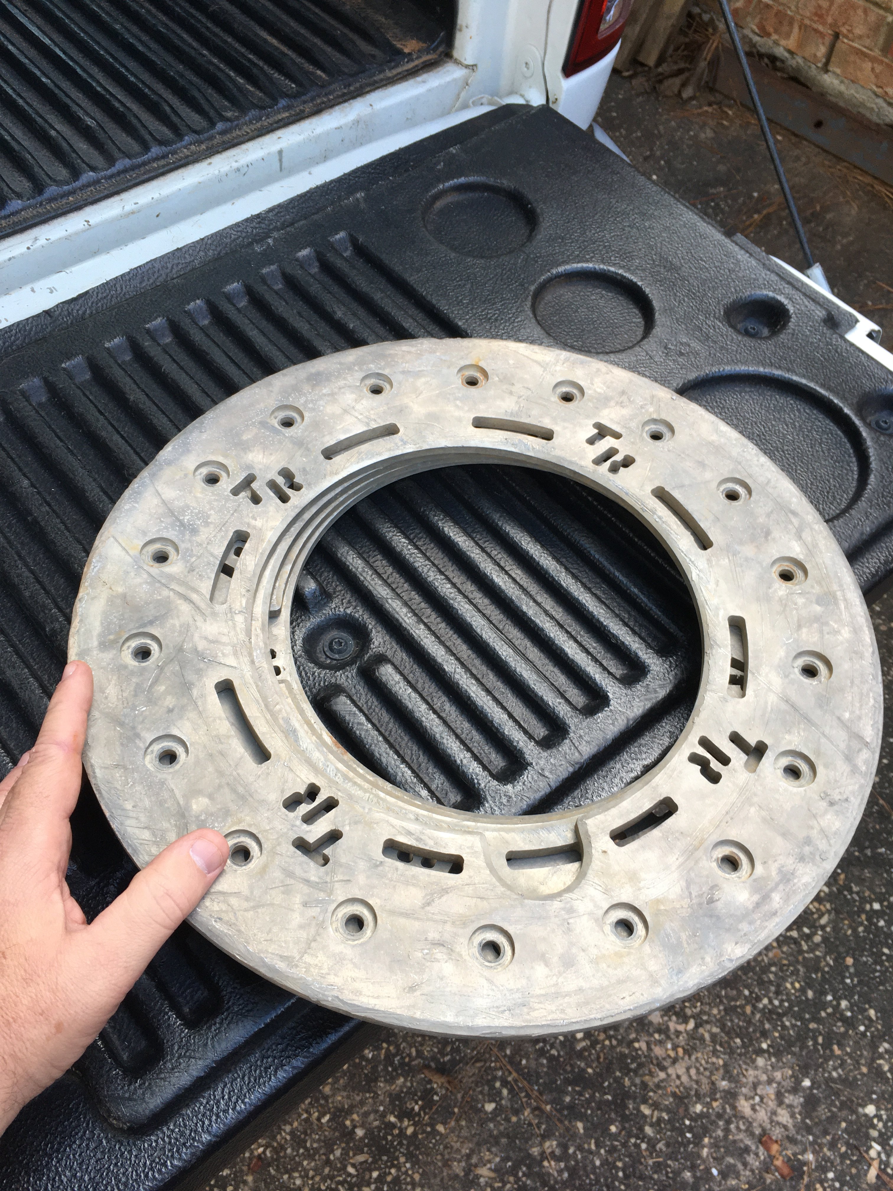

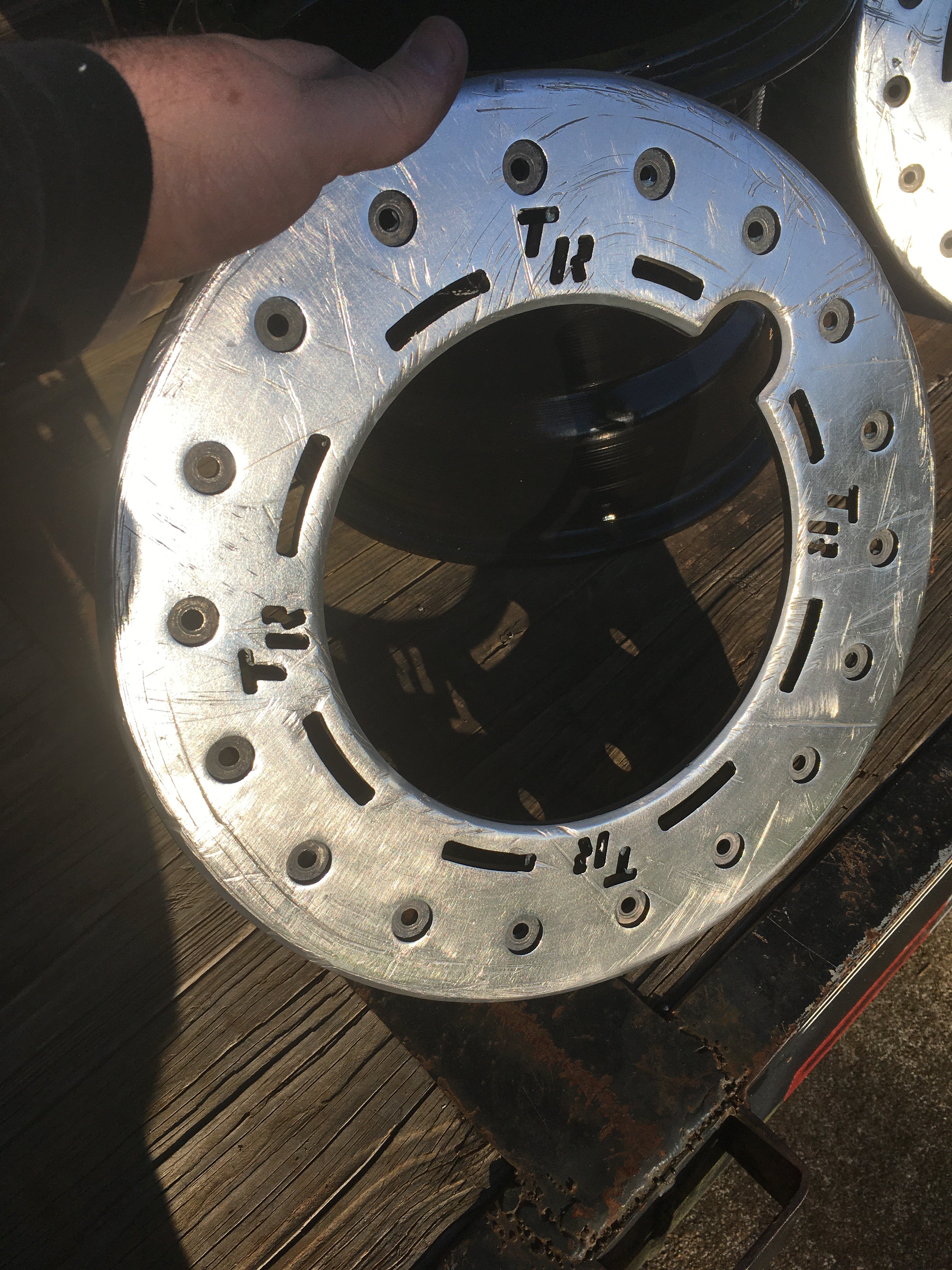

The beadlock rings needed some love, typical dull bare aluminum. They almost looked like gray primer. I went to YouTube University and took a couple of courses in quicky polishing and I'm happy with the finished product, shiny but not show.
Before "polishing"

After polishing

I finally got the wheels back right before New Year's Day, I'm really happy with the finish.
full

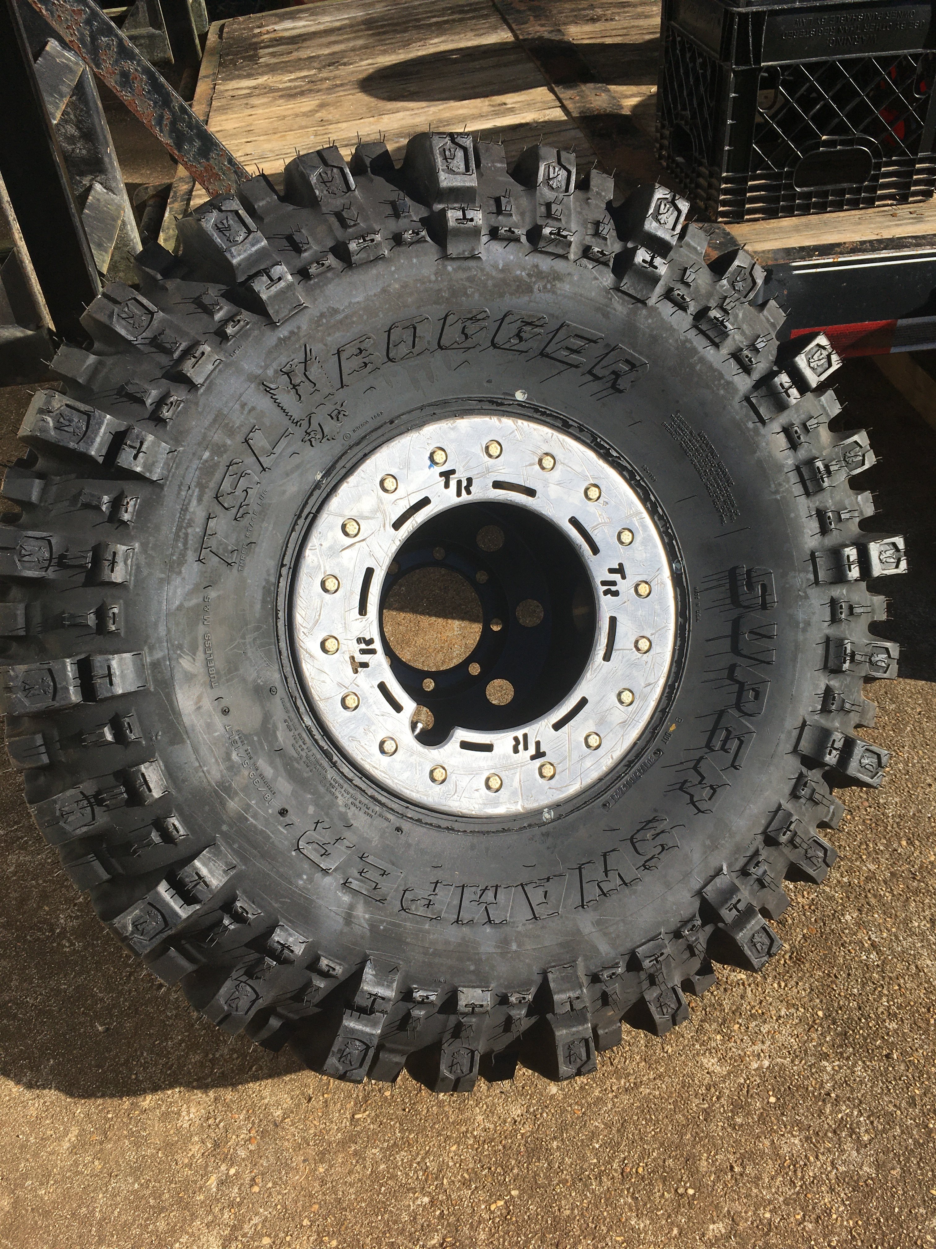

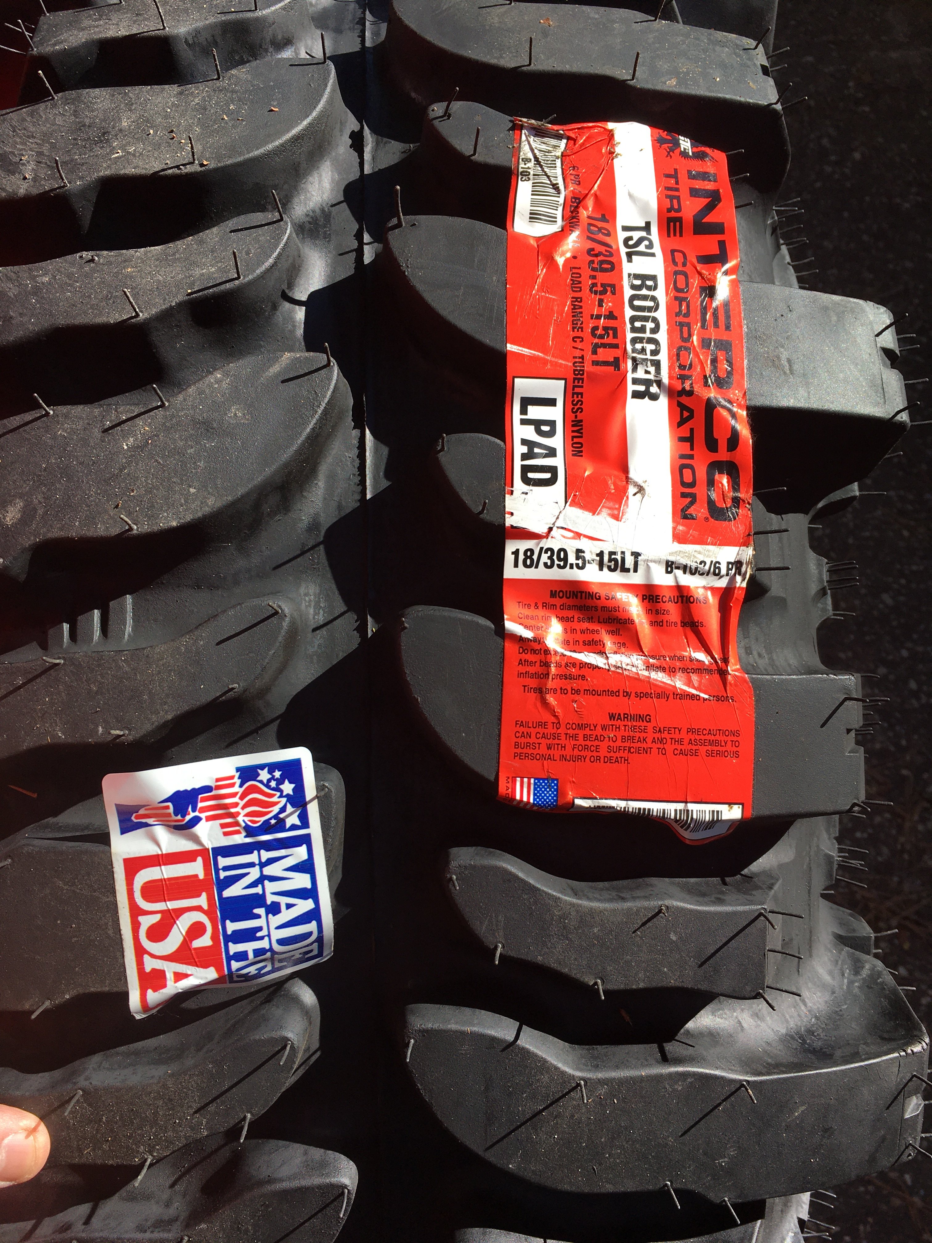

Old news, new tires.
full

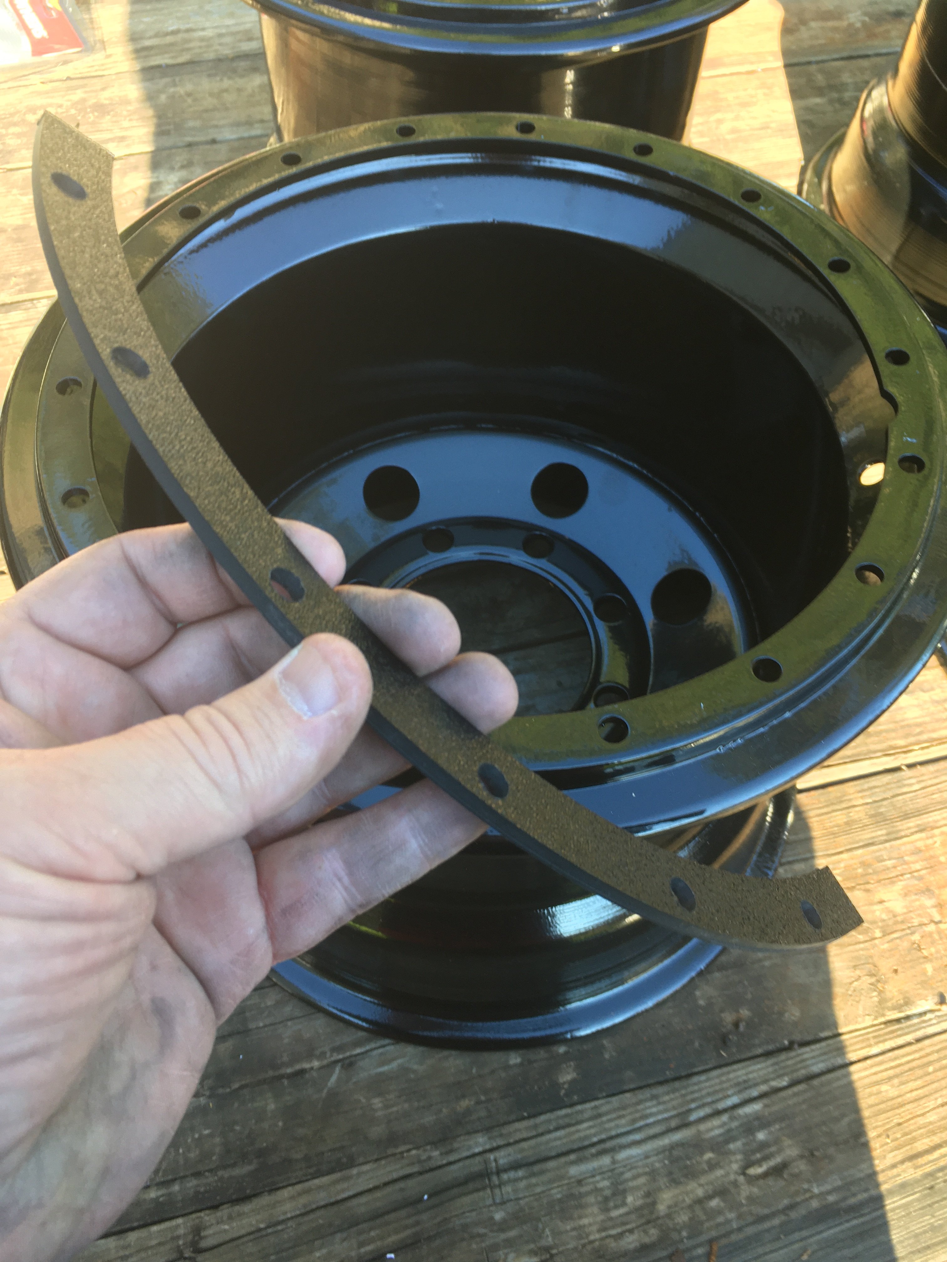

I've been reading up on beadlock rings and coning so I got some anti coning spacers from Trailready.
full

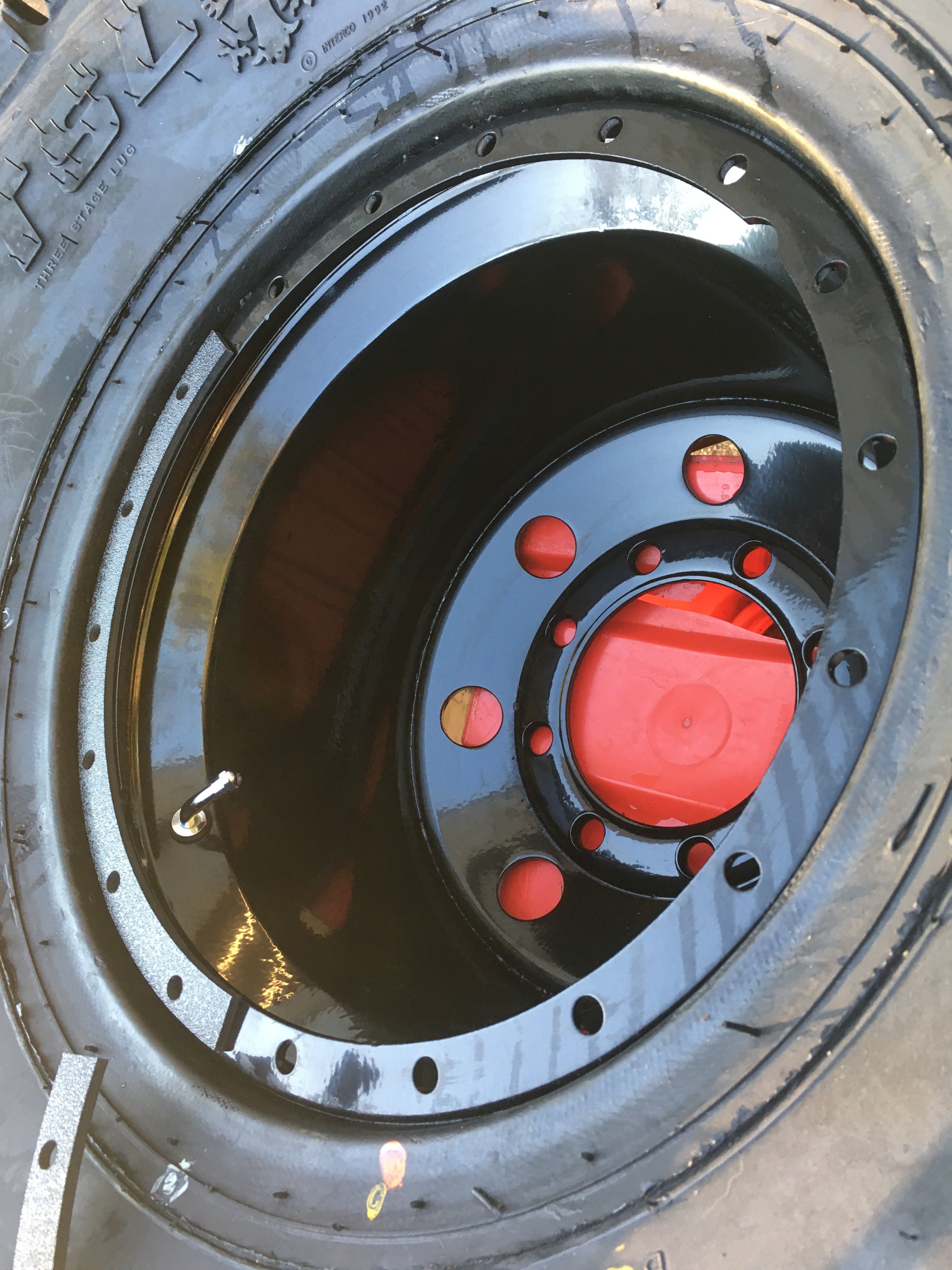

Same spacer on the rim
full

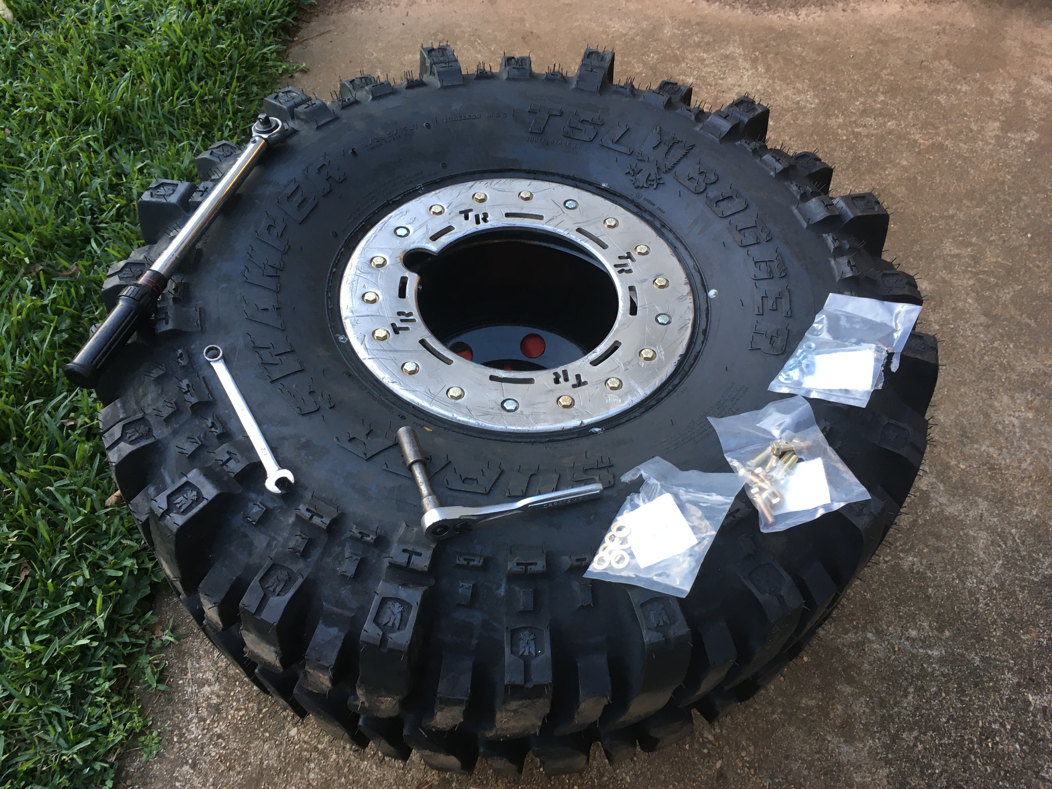

PITA in a pic. The beadlocks torque incrementally up to 24 lbs ft, it must have taken 8-9 rounds to
full
1 down, 3 more to go. :doah:
full

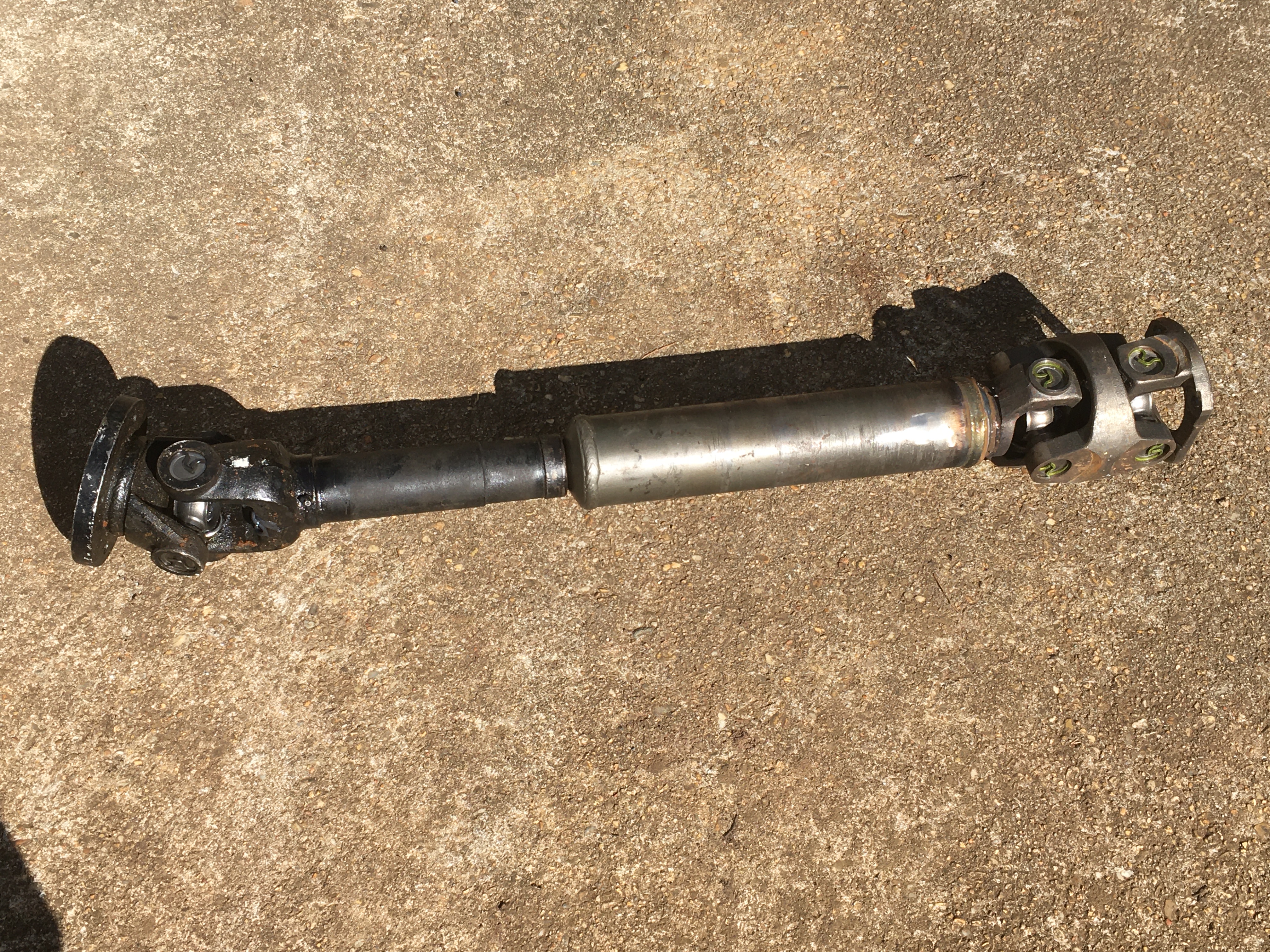

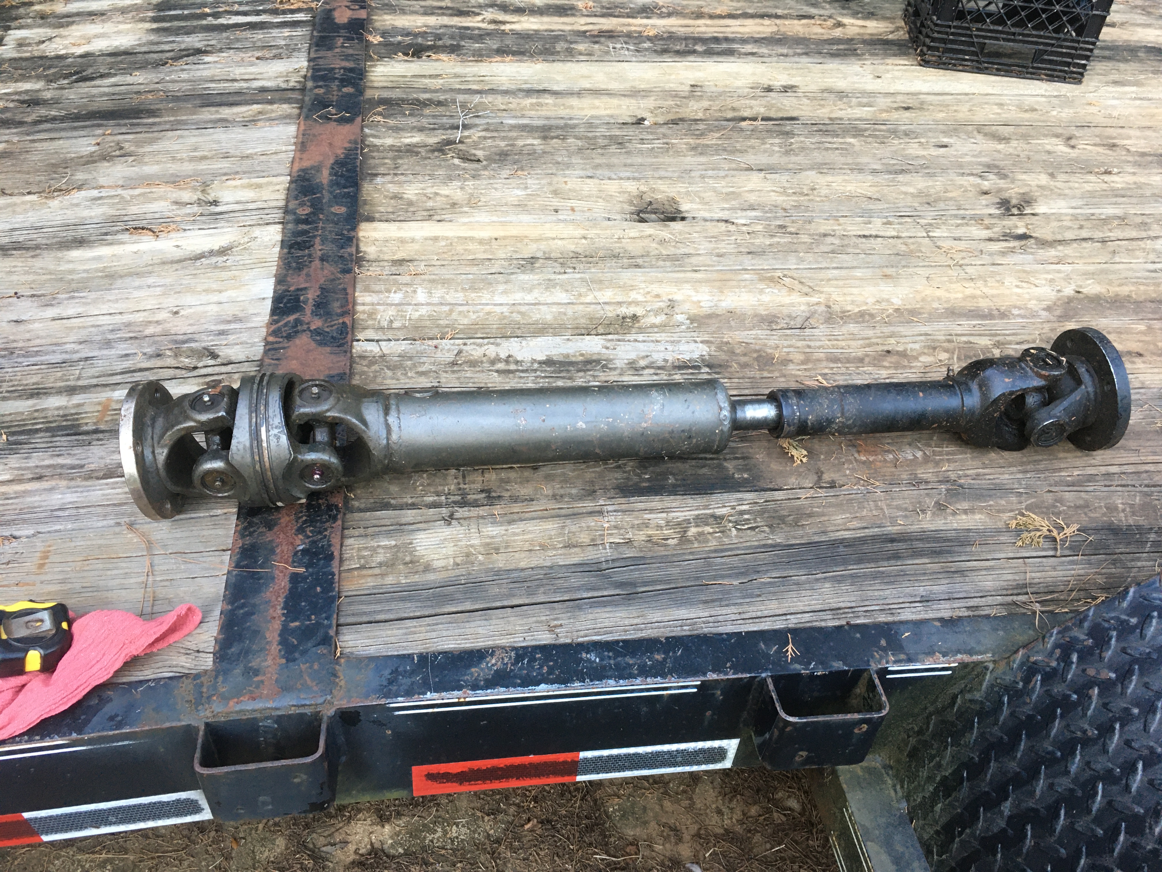

My old driveshaft was one I had bought used from a guy parting a project, it was a High Angle Driveline built shaft with the huge 42º CV on one end and a 1410 joint with a 38º flange on the other end. The problem is the CV is from some type of agg application (I think it's a "cornay" joint) so it's not sealed, it needs to be greased just about every time you drive it - fine for a front driveshaft but not for a rear). I got tired of the constant maintenance and everything on the underside of the Blazer getting nasty from the grease "spray" so I ponied up for a Super Duty CV.
When I cut the old CV off I found out the tubing is 3" x .120, bonus points!
Old H.A.D. 42º CV (note the 2 rings on the center piece)

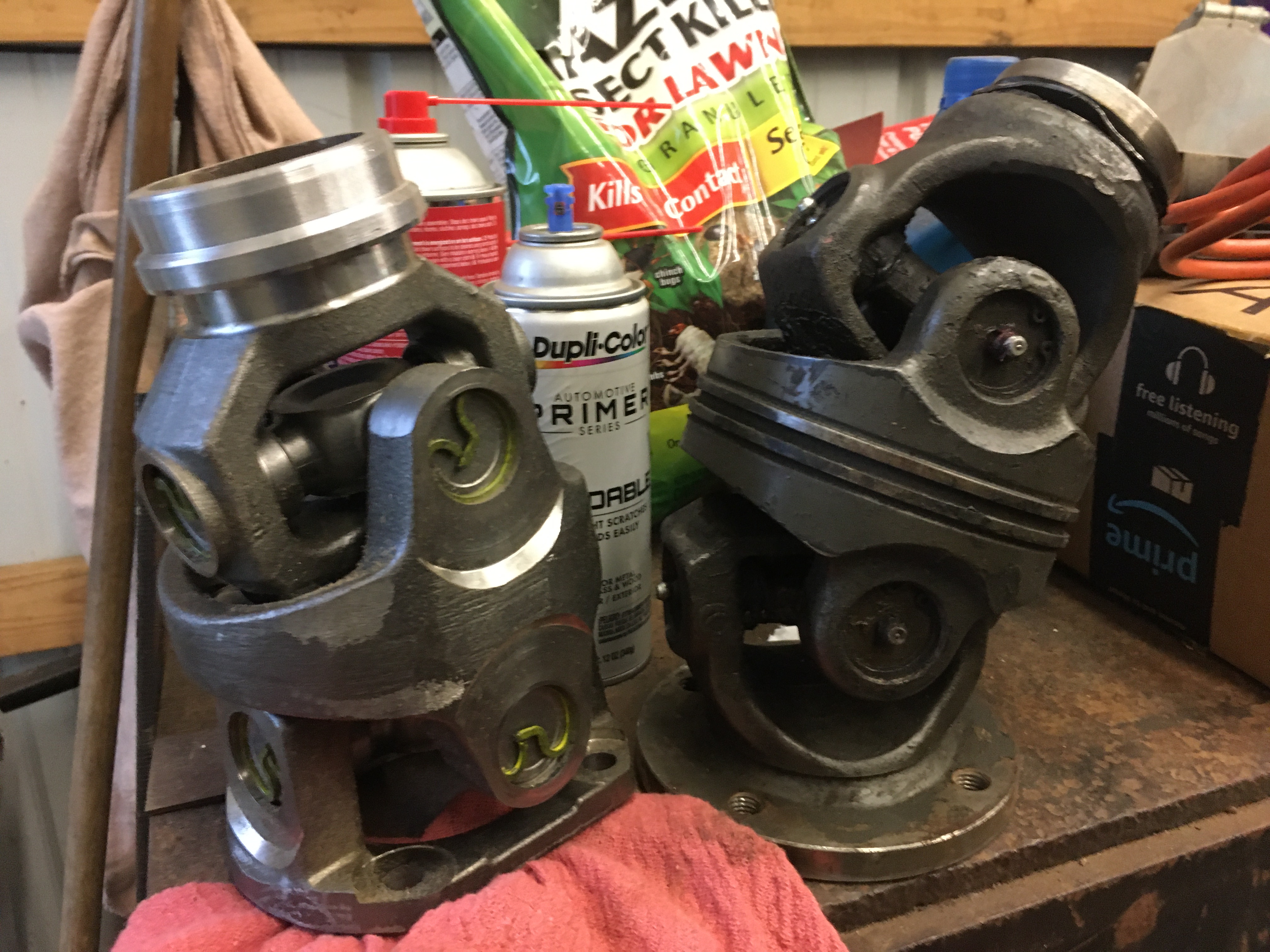

Same driveshaft with a new Super Duty 1410 CV
full
Old vs new, note the size of these compared to the paint can behind them.
