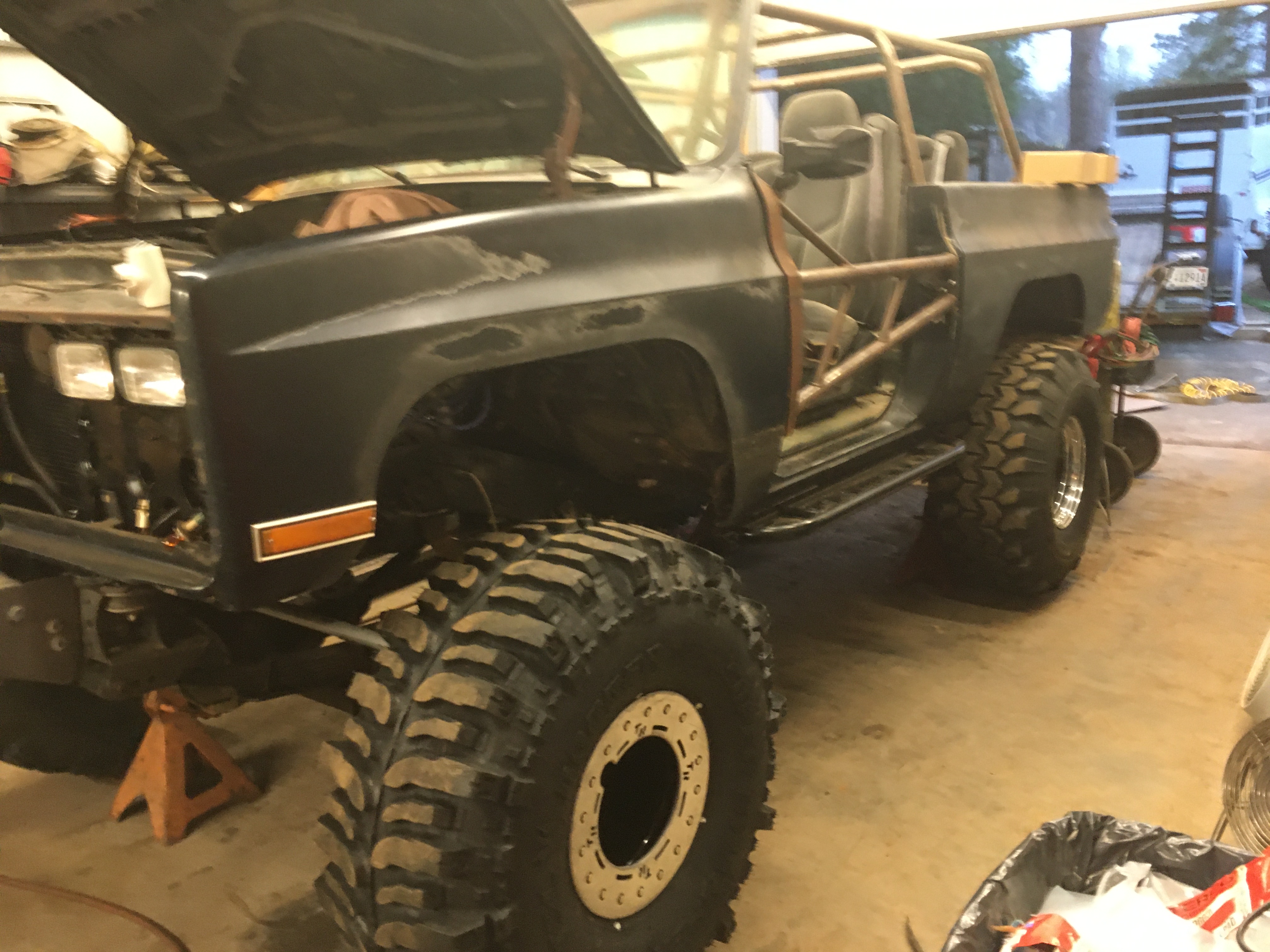

I bolted up the front tires today, I’m trying to decide if I like the width. It looks like it could be a problem on trails (and the trailer). I’m going to drive some and see how it feels, I really don’t want to do a bunch of caliper grinding but I will if I need to.
The rears aren’t on because I need to trim the studs, they’re too long for the 1.5” wheel spacers.

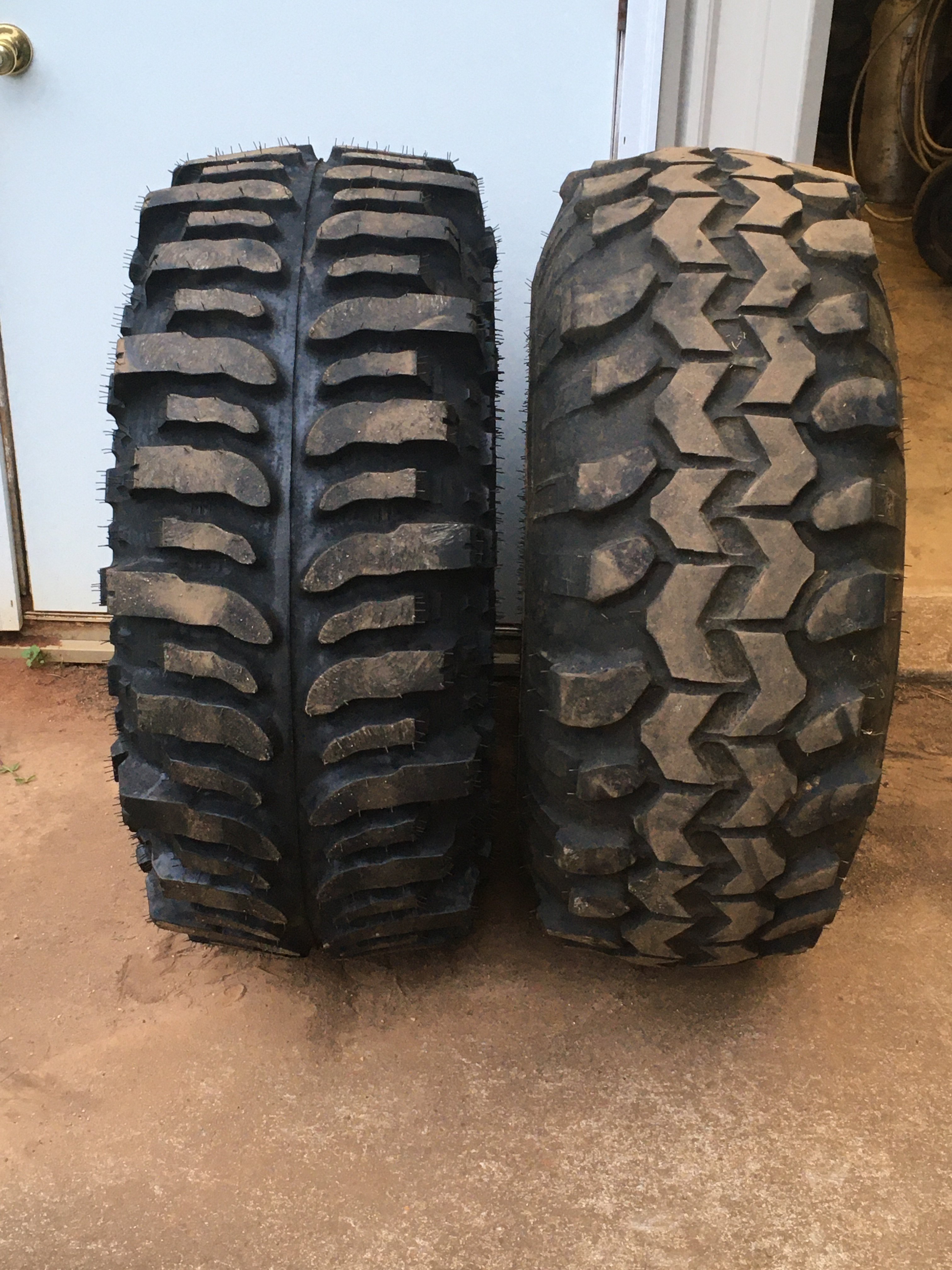

Someone asked for a Bogger (15x11) vs TSL (16.5x12) comparison (both 39.5).
full
This looks pretty good to me. Note the difference front (spacers) to rear (no spacers).

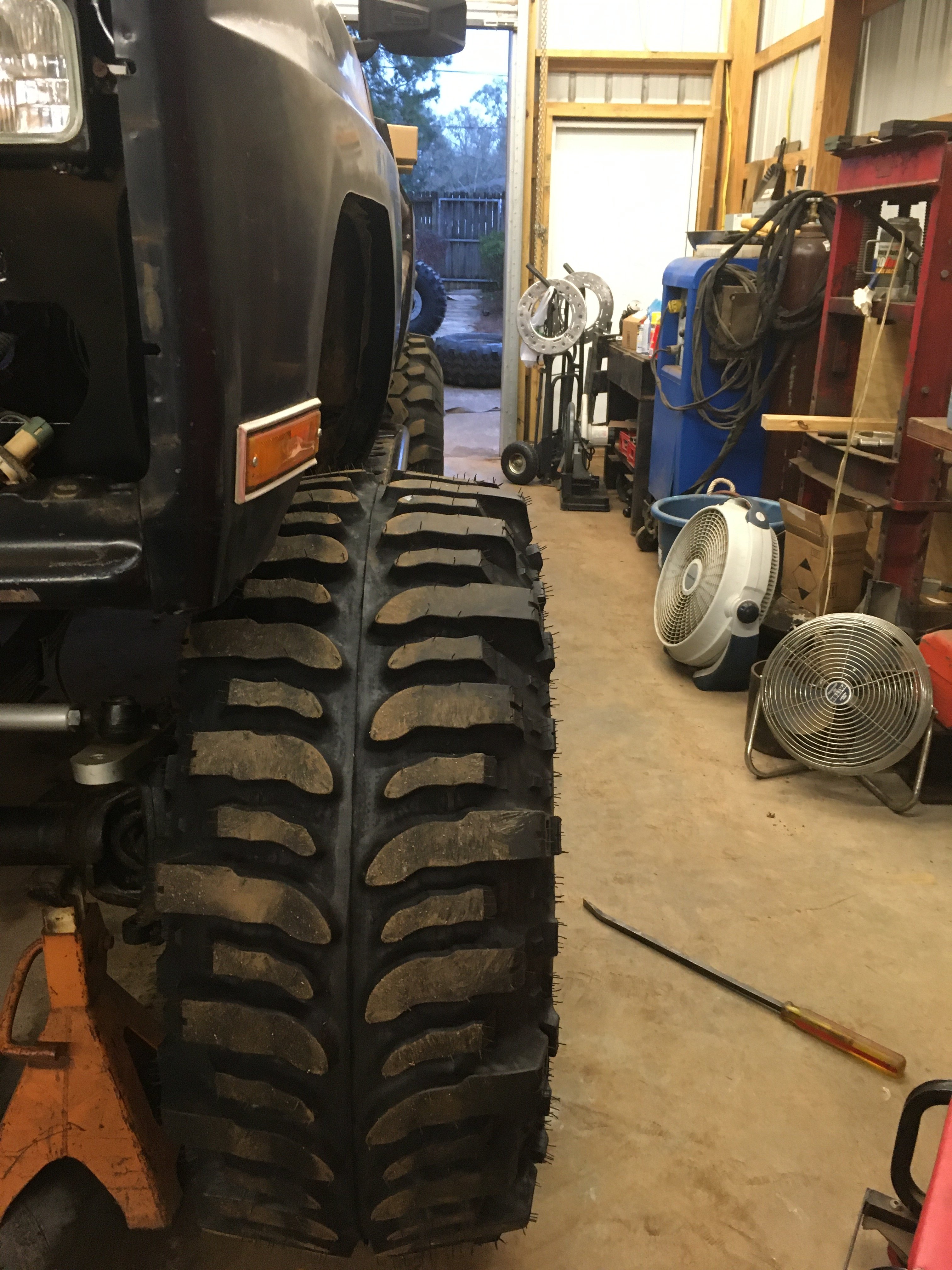

full
This is what bothers me, it almost looks like I’ve got a dually axle
full
The trailer really isn’t an issue because I have drive over fenders. The Blazer didn’t fit with the 43’s so I’ve always had to climb over, spooky feeling. I’m a little worried about the overall footprint on the deck, the old set up left about 1/3 of the tires hanging over the edge whereas this set up looks like it’s be at least 1/2. I need to put a tape on the truck.
