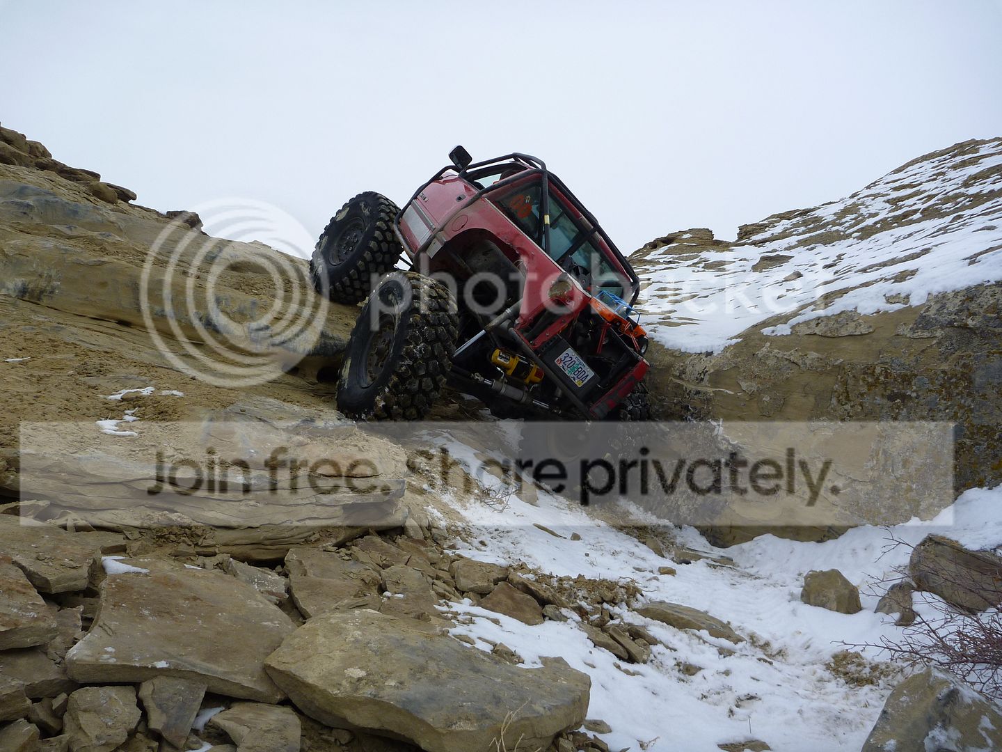

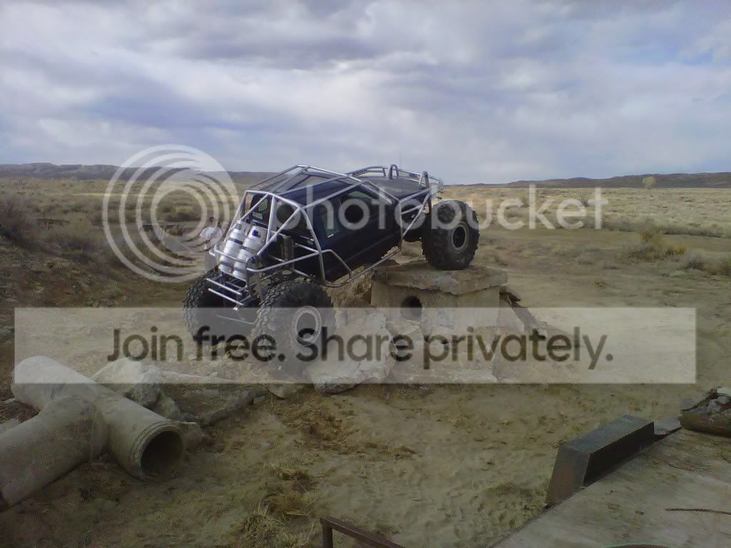

these 2 rig here run 2.5" air shocks front/rear and have some crazy leaning characteristics. If it wasn't for the crazy width and weight of the axles/wheel I think they would be on their lids often. Clint can mask the leaning and unloading with front and rear suck downs in the Dodge. The Dodge has good link geometery but the s10 has some interesting wishbone stuff going on. In you application with the front being more stable though I could see it being less of an issue if you can keep the front level let the rear do whatever to follow theory....

That Dodge has miles of roll steer, I wouldn't consider that great link geometry. I know he hangs with you guys which is all that really matters.

Angle of the pic plus rear steer. Looks like he is steering into it hence him looking backwards. I could be wrong though.

You definitely could be right, I've never wheeled with the guy and looking at the picture I may have jumped to a conclusion.
Yah I was kinda thinking the same thing then I noticed the big psc double ended ram.
Edit yah he is definitely steering into it. Ram isn't centered.
I think his link calculator numbers are on his build and seemed like they were pretty adequate. He drives with the rear steer more than the front steering because "its easier to move the joystick than the wheel, and because I can".
Here is about the best shot I have of it leaning. The S10 does it much worse. You results may vary though.
