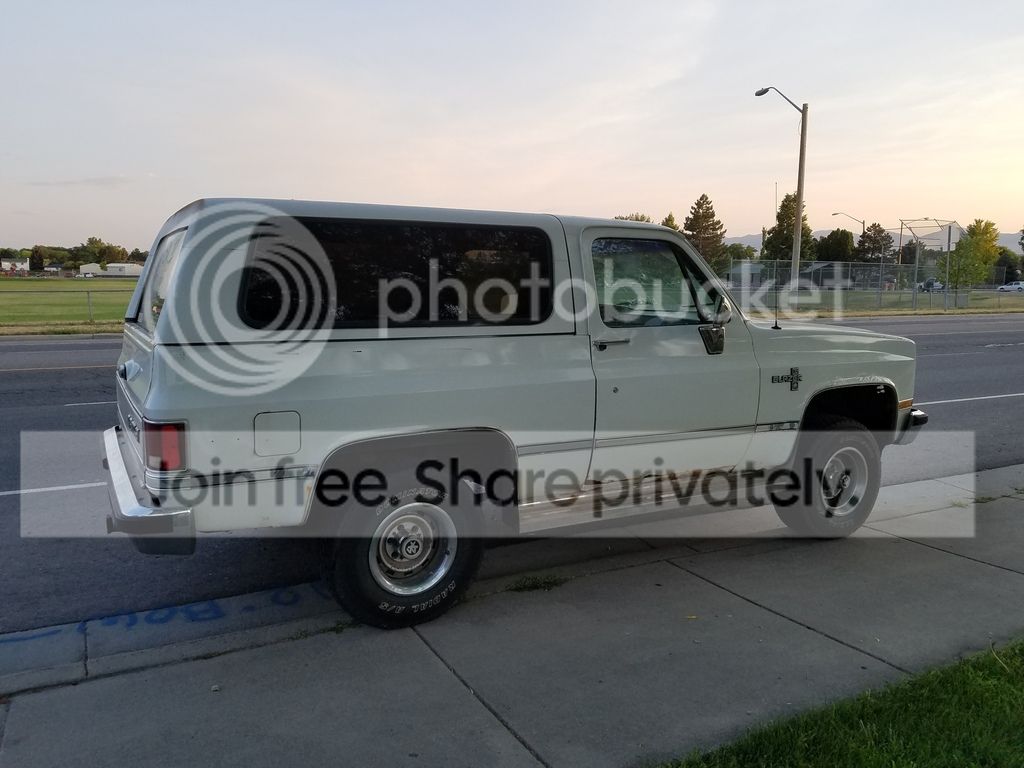

I did a thing, I purchased a smasher blazer today. I'm not a rich dude but I wanted something ugly I could really smash and not stress. I also purchased this truck as a plan B for one of the greatest dudes I know. He wants to go to blazer bash 2017 so bad but I'm not sure if we will have his rig finished in time. If it's not I'll give him the keys (no he does not know another member and I will be doing this) so he can make it. With that said I'm looking for ideas and parts to make this basic moab ready for bb17. It only has 10 bolt axles but a locker would be awesome and a set of 35s or 33s with cutting and maybe a baby lift. Think cheap must haves.
Ideas ?

It's unmolested stock tbi with ac. If it wasn't so rusted and dented underneath it would be a prime candidate for restoration. The interior is an 8/10. But most importantly I STOLE it, so I don't feel bad about rubbing it on rocks.
pull off running boards

I have a different set of 2" lift springs.
You want em? I'll be down Salt Lake way in 2 weeks
The springs I got I kind of wanna keep but the 2" ones I already have are of unknown origin might be awesome might not be

@72gmck5 thoughts on 2" springs I'd say much better than stock. And I won't have to mess with drivelines yet,

@Phil513 has a fairly basic blazer and it did good last year at Blazer Bash. I think he just has a 4" lift and 35s and some kind of locker out back. @500$k5 has a low lift locked up one that goes everywhere also.
Yup I remember seeing that. Id like to do a little something before bb17 for as cheap as possible because these parts will be taken off as the real parts accumulate
Yup, very basic. 10 bolts front and rear, still have 3:42 gears. 4" and 35's with a rear spartan locker.
It did fine, but I didn't push it very hard either.
