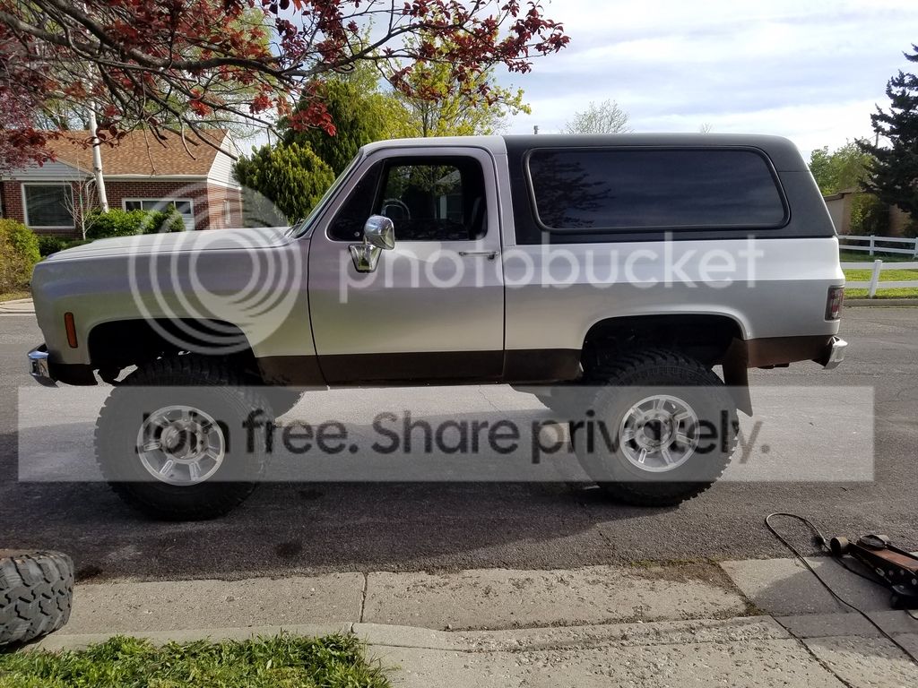

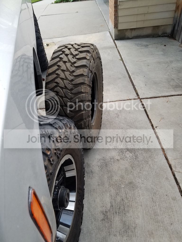

This is what my friends geolander MT 38x13.50 tires look like on my truck. Wish I could try on all the tires. I'm going to look at those toyo MT tires today they are only a 37 tho...

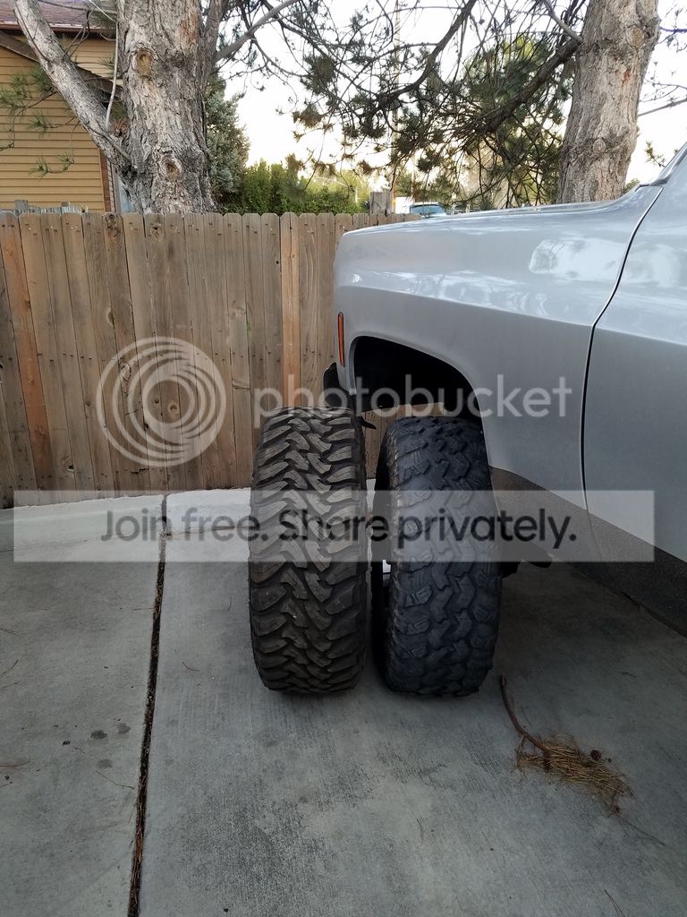

With these pics it's easy to see my 8" rear lift and 6" front lol. Thank God for the ez inch coming soon.

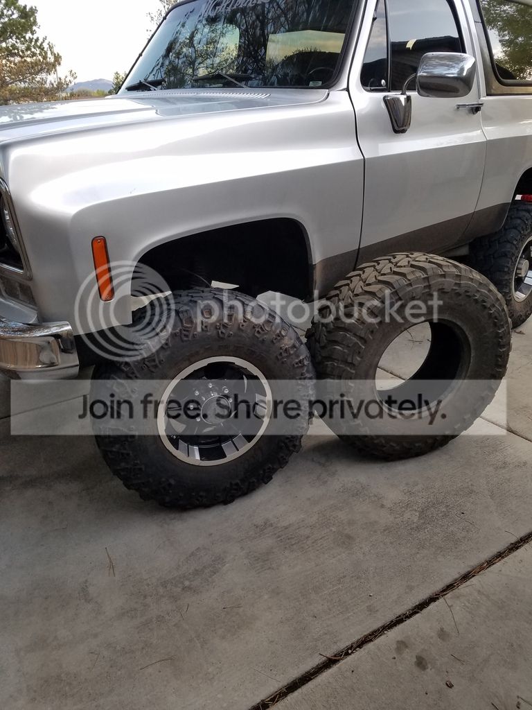

My 37s have enough gap it's not obvious like these

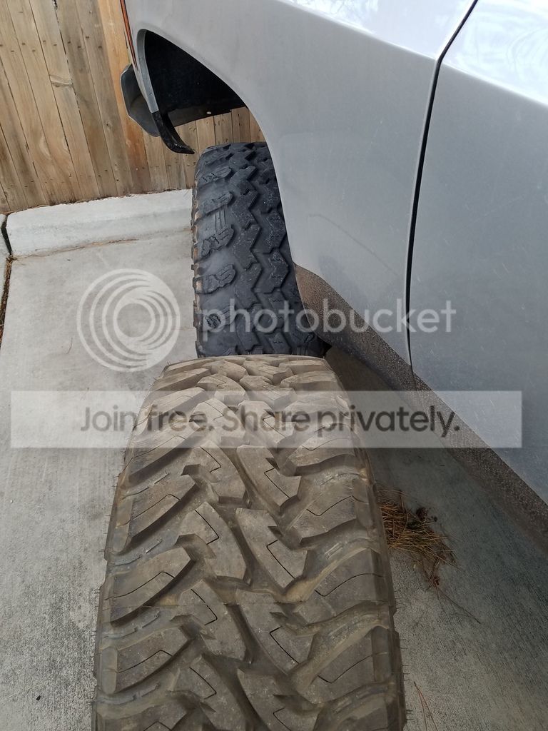

Even though these aren't as aggressive as I want (looks department) I would like a set of 38s. Thoughts on these tires? I can get a set pretty easy
