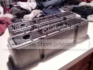

I just need new valve covers period. Those junk chrome ones leaked my royal purple break in oil everywhere. Once it was warmed up it was a drip every 2 seconds or so. Not good. So I'm trading that aluminum set that wouldn't fit for the same set but tall version. Just traded a guy straight up who lives in Texas who had the tall set and wants the short ones. On Ups's tracking site it was in Wyoming mi as of this morning so hopefully they are here today.
These ones didnt fit with my roller rockers, I set them on for a pic, but they were too short.

Valve covers are in. Just gotta be blasted and clear coated. These will definately not have clearance issues with my roller rockers. They are huge!!! I like em. Hopefully Ill get down to the shop tomorrow and blast them and put them on later with my new Felpro valve cover gaskets. Paid $50 for the gaskets so they betta work how they say:woot:
