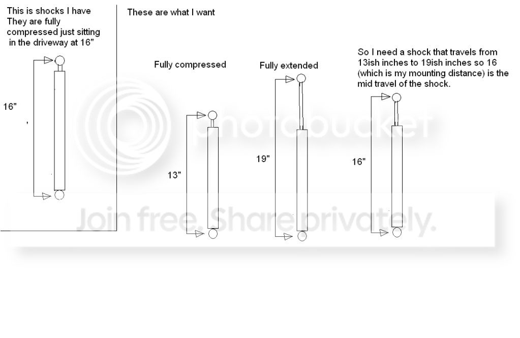

Well I dont want to order a shock thats 16 inches long fully compressed, nor one thats 16 inches fully extended. I want one thats got a good 3inches or so both ways. So 20ish-13ish for the travel

Im not buying longer shocks. Im actually buying shorter shocks because whoever put these ranchos on stuffed in shocks that were almost 16 inches compressed all the way. From my mount on the axle to the mount on the frame it is 16 inches roughly. So my shocks as of now are too long and not allowing for any downward movement.

I consulted my old notes and found the dimensions and part numbers:
9101 is the stock position front shock - 11.67"-18.07"
Consulting NAPA's website shows most shocks being about 11.8"-18.3".
Now since you want the "additional" quad shock the dimensions for those seem to be about 12.8"-21".
Calling their tech line would get you the part number for what you want.

Ok I measured the exact distance from eye to eye on the mounts and it is 16-5/8". I was just thinking that I would want a little more up movement than an 1-3/8" if I do ever need to flex it a little. Thats why I have been looking for one that goes from like 12ish to 20ish.
Sorry for the confusion, and I will not be putting the additional shock in. Im going to remove the 4 ranchos and just put 2 new ones in.
You have the stock suspension. Putting shocks other than the stock application on will not benefit you in any way.
Look where your bump stops are right now. You don't have much up travel at all. That's the way these things were from the factory.
I gave you the dimensions of most replacement shocks for your stock suspension in the front.
I understood you are looking to get rid of the quads and only run a single on each side in the front. I believe you were wanting to do it in the "additional" position that the quad shock setup adds.
That has a normal dimension of 12.8"-21".

Well I cross referanced the rough country chart you gave me and in the 1973-1990 blazer/jimmy section for the FRT (guessing front) with 0-1" lift it calls for shock MFG #9101
So I went to JCwhitneys site and under the 9000series and clicked "item details" and scrolled down and their it is MFG#9101.
http://www.jcwhitney.com/nitro-9000-gas-shocks/p2006163.jcwx?skuId=180313&filterid=d241y1985j1&gan=1&JCW_SRC=AFF
So that sound like its what I need so i think ill order 2 and see how she handles. Most likely like a dream compared to now with the shocks almost bottomed out just sitting their:eek1:
