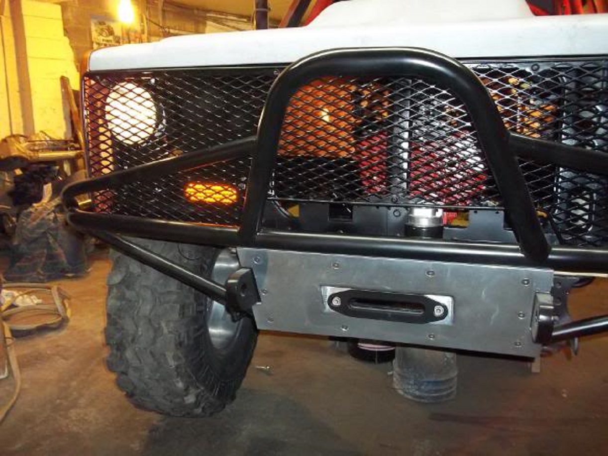

The holes in the bottom plate is access to the bottom of the top plate that the winch is bolted to. It's very similar to ORD bumper. We live and wheel in the woods so the upper hoops keep trees away from the precious. I like the spool accessable so I can put my fingers in it.

That’s awsome! I might do something similar. When I build it I’ll post some pics! Thanks for sharing your ideas

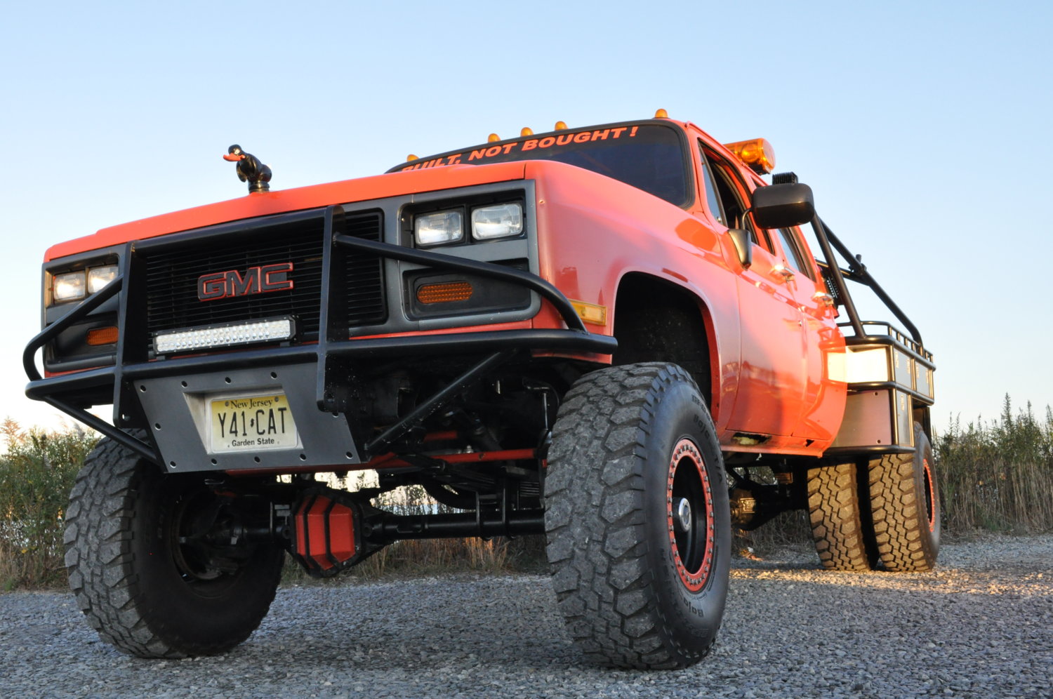

ok... I"ll play. I built it in the driveway a few years back. hit some rocks with it- winched some stuff, and saved a few fords...its been mostly sitting for the last couple years but im talking about putting the 3rd motor together soon and resurrecting. anyway, bumper is higher and tighter than the factory one in all dimensions, and has a 10,000 lb winch stuffed in there. the shackle loops are welded to a plate that is integrated into mounting the whole enchilada- they go through the bumper and use several bolts to attach to the frame. it could use a fresh coat of paint, but still gives me a tingly feeling feeling in the pants when I look at it.

Mutt's has no winch, but my K5 one does... both bumpers employ sammich mounting of the frame horns and are stooopid stout....
